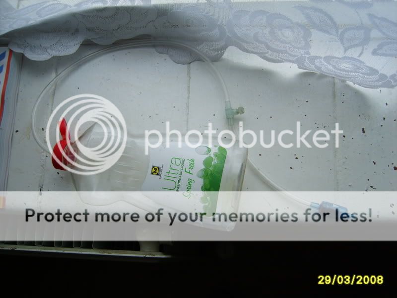

after seeing mr.z's hamster water bottle design, i decided to have a go myself, seen as my sister used to have a lot of tropical fish theres a lot of airline and various other gubbins floating around, so after a bit of bodgery we get this.
https://i251.photobucket.com/albums/gg307/virusjohn/evolution%20of%20cg/73a8abb9.jpg
gubbins put together, using one of the hobs on the cooker to melt the cap/tube joint so it doesnt leak. all the rest just pushes on as it was designed for that airline.
https://i251.photobucket.com/albums/gg307/virusjohn/evolution%20of%20cg/185a237f.jpg
the washing up liquid bottle (held on with a shoelace and a dodgy bit of coathanger wire)
https://i251.photobucket.com/albums/gg307/virusjohn/evolution%20of%20cg/01dfb28c.jpg

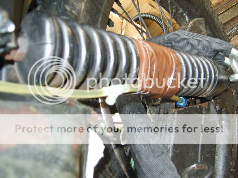

the tap thingy, and a one way valve on the end to act as an aiming doober
https://i251.photobucket.com/albums/gg307/virusjohn/evolution%20of%20cg/a4dfd4d5.jpg

Erm don't you need a valve or hole or something to let air into the bottle to replace the oil that seeps out?.
virus
Joined: 17 Aug 2006
PostPosted: 15:40 - 29 Mar 2008    Post subject: Reply with quote
probably... Laughing
i havent tested it yet, so i shall carry a stanley knife with me when i do

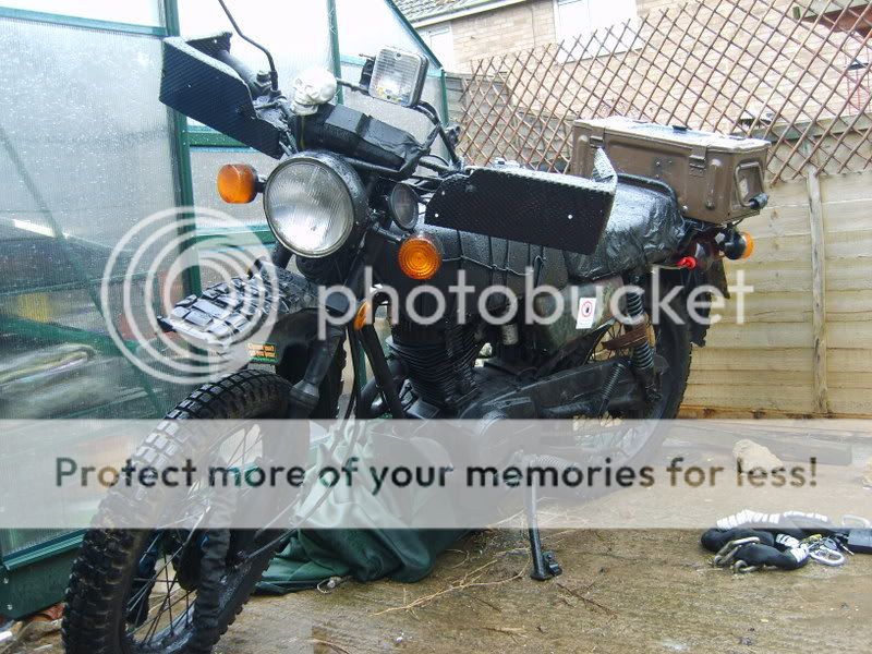

Impressive mate, but is that really a chain only it looks shit brown, do they go that colour eventually? Wink
see I said don't give up the rattin'
My claim to fame: Austin Vince nicked my pen...
virus
Joined: 17 Aug 2006
PostPosted: 18:30 - 29 Mar 2008    Post subject: Reply with quote
aye it is a chain mate. Laughing
they go rusty pretty quickly when you go trail riding and completely ignore it, that thing hasn't been cleaned in over 6 months Laughing
getting a new chain soon because that one is f*cked

I thought Scott oilers ran off the Carb vacuum or something? Confused
Once you get a vacuum in that bottle, No oil will come out.
And if you do pop a hole in the bottle. Oil will dribble out 24/7 and you will end up with an empty bottle after a few days and a massive oil patch where you park the bike.

John, what about using one of those little oil cans with the handle you pump? You could just give it a pump before and after a ride to lube the chain without it constantly dribbling
oil wont be able to get out if i put a hole in the bottle, il tighten up the screw halfway down the line, this will stop oil flowing.
as ive said its not tested yet so some modifications may need to be done.
Your Heath Robinson approach is to be commended.
However, spotting the missing lower chain guard if you replace this then the chain will effectively be running in its own oil bath Very Happy
