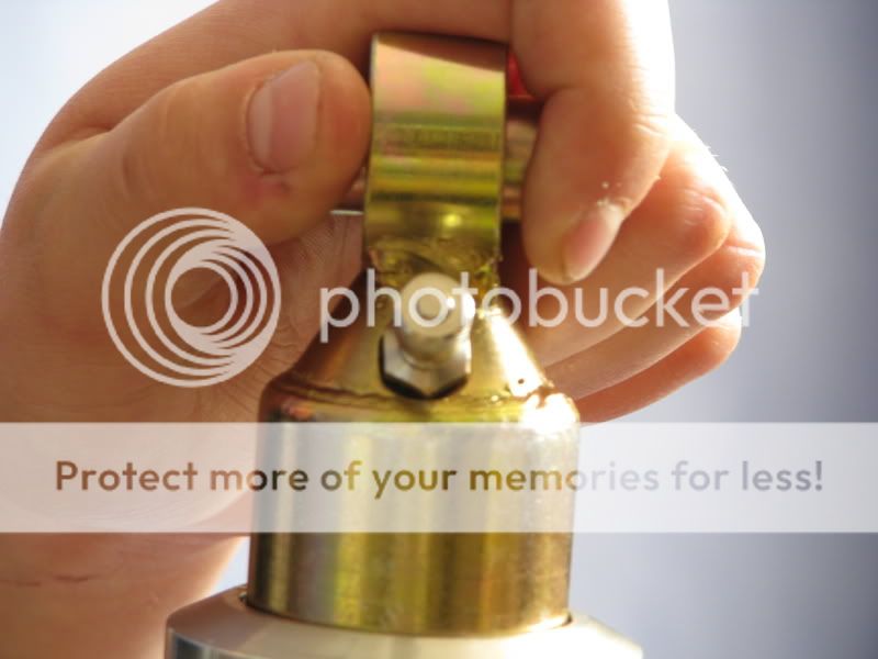

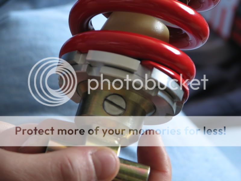

Could do with a quick run-through of this new shock (I'm f'ing clueless) if you don't mind.
I've attached a couple of pics, and need to know the following:
1. The flathead screw in pic 1. What does it do?
2. The adjustment rings in pic 1. Why are there 2 of them, or are they 1 piece?
3. The dustcap in pic 2. There's a valve underneath - what is it for, and do I need to touch it at all?
4. The eyelets at each end of the shock are not quite aligned with eachother. Is this likely to be a problem, or will I be able to twist it when I fit it?
https://i34.photobucket.com/albums/d109/nynfortoo/IMG_2806.jpg
https://i34.photobucket.com/albums/d109/nynfortoo/IMG_2808.jpg
Cheers.

PostPosted: 18:41 - 12 Jun 2008    Post subject: Re: Betor Shock Help, if you please Reply with quote
1. The flathead screw in pic 1. What does it do? Rebound adjuster.
2. The adjustment rings in pic 1. Why are there 2 of them, or are they 1 piece? 2 Seperate rings that lock together when you have adjusted the pre-load with them.
3. The dustcap in pic 2. There's a valve underneath - what is it for, and do I need to touch it at all? Depends what the shock uses for damping, Air, Nitrogen?
4. The eyelets at each end of the shock are not quite aligned with eachother. Is this likely to be a problem, or will I be able to twist it when I fit it? Bottom and top parts separate and will twist to lign up.
Cheers.

PostPosted: 18:57 - 12 Jun 2008    Post subject: Re: Betor Shock Help, if you please Reply with quote
Thank you very much for the helpful info. I have two more questions if you will please.
Which ring do I adjust or does it not matter?
When you say the bottom and top parts seperate and will twist to line up.... Will I be able to twist one part when the other is on the bike, using a metal pole or similar? If not, how do I "seperate" them, if that's what you meant?
Cheers again

PostPosted: 19:46 - 12 Jun 2008    Post subject: Reply with quote
Rebound dampening, or possibly just dampening in general, would be my guess.
One should be immovable, the other should be able to turn with a C-spanner. It's preload adjustment, if you didn't already know.
Could be compression dampening adjustment, or just a valve for gassing the shock when its manufactured?
The 2 moving parts aren't really fixed together as such, so you should be able to twist it. Can't be sure though.
Hope i've been of some help!
EDIT: Seems i was way too slow there Embarassed
In reply to your other question; I'd imagine you turn the ring that is touching the spring to adjust it, and the other locks it in place.

PostPosted: 21:15 - 12 Jun 2008    Post subject: Reply with quote
Adjustment rings, the one closest to the spring adjusts it, the other one locks the first one in place, undo the second one, more the first one so the spring is how you want it, then tighten the second ring into the first to lock it off.
