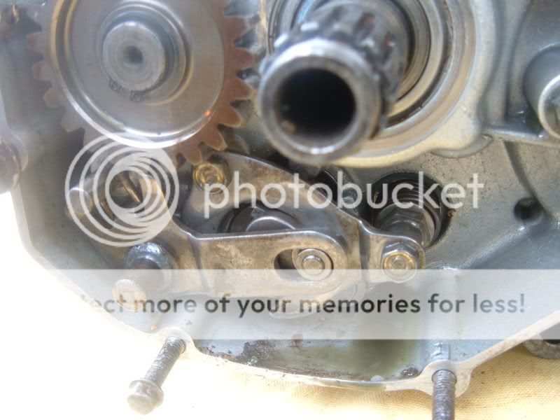

Hi mate, I think it might be worth just taking the right hand side casing off and taking a look at the actual gear selecting mechanism, like i say there is a collor on it which if it falls off it will do the same as what your bike is doing.To have a proper look you have to take the clutch basket off as it gets in the way, you do need a special tool, but if you have a air gun you can just use that, its really straight forward, Do you have a worshop manual?
Anyway im not sure how good you are with engines but when i did mine i took a picture of what it should look like, bare in mind this is a 1995 model but im sure there are probaly the same, it should all look like this, with the collor in place.
Make sure it is all pushed on to it, then just move the gear lever up and down and see if everything moves.
https://i86.photobucket.com/albums/k117/lee125_2006/DSCF6487.jpg
If all looks to be ok them im affriad you might have to split the casings and have a good look inside, its more than likley the problem will be clear, if you have all the basic tools and a windy/air gun it is really straight forward, just a case of remebering what goes where.
Anyway good look, i would deffiantly have a look at the selcter mechnism as in the photo.

Hi Jim - thats great - I'll have a bash and let you know how I get on! Why don't they put photos like that in manuals!
Once again, thanks very much. Very Happy
