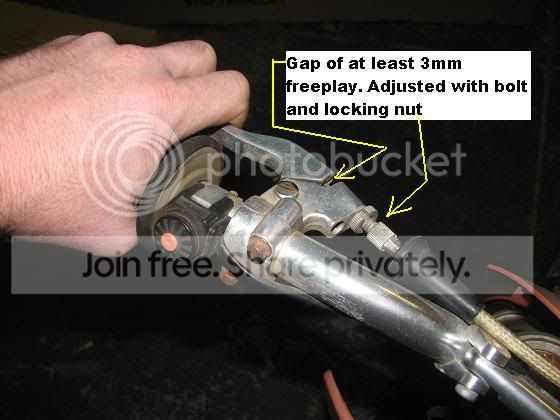

That will be the clutch slipping, adjust the cable to the free play specified in the manual, and if it still slips might be time for a new clutch.

for free play basically this, but change 3mm to whatever it specifys in your manual.
https://i419.photobucket.com/albums/pp276/thump_140/clutchfreeplay.jpg

If you went to a bike meet I am sure you could get someone there to adjust it (via the adjuster at the top), it really isn't hard. They have the same system on pedal bike brakes.

As you slowly release your clutch while changing gears it helps to be slowly decreasing your throttle as well anyway so that the two "meet" faster. Sometimes the revs will match where they are supposed to be while the clutch is still partially engaged (slipping) so that as you release the clutch entirely you wont get any of this unpredictable RPM Business anyway. This definitely sounds like a clutch cable issue though. I suggest adjusting it immediately. A kind garage will spend 60 seconds doing it for you most likely.
