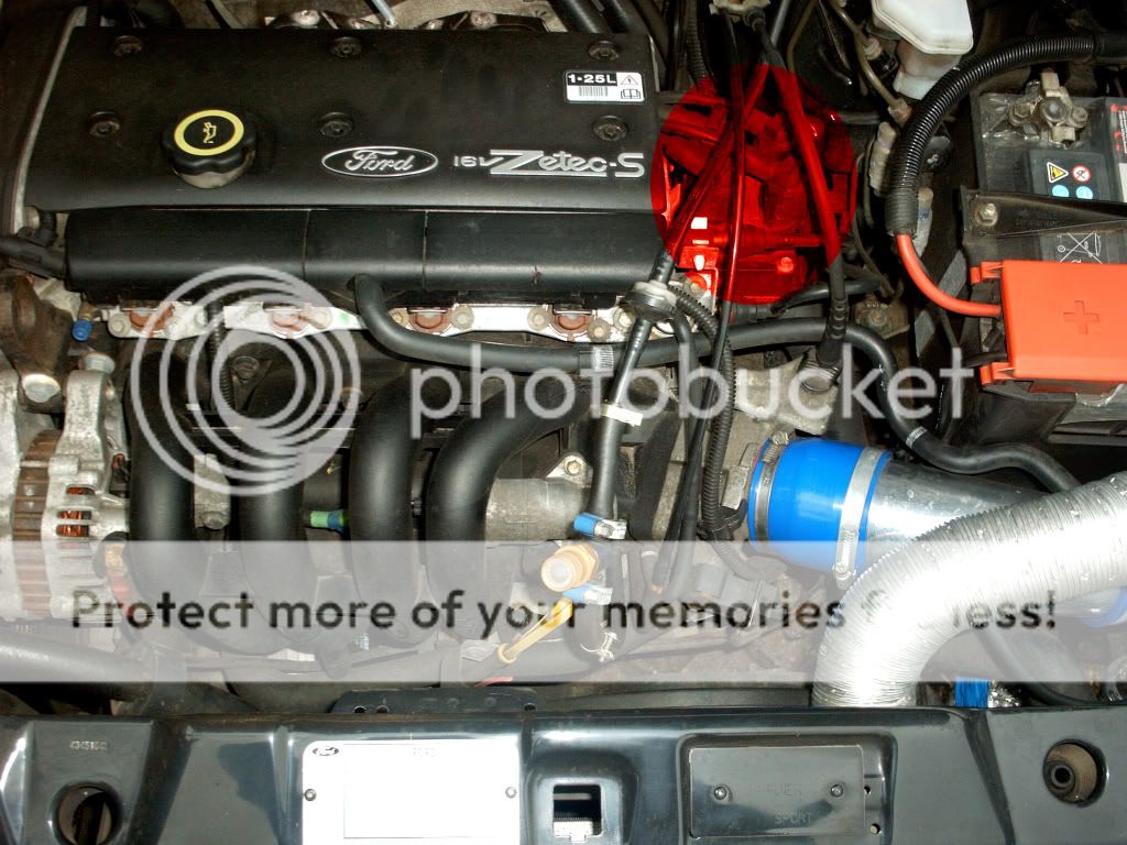

Right hand side of the cam cover, you can't miss it all the HT leads run into it and a lead with a plug from the ECU.
You may need a torque bit to remove it not sure on the size though.
Shouldn't be any more than £40 from a motor factors loads more from a main stealer! Think I got my last one for £26.
https://img.photobucket.com/albums/v112/finglonga/lengine.jpg
Better pic . . .
https://img.photobucket.com/albums/v112/finglonga/zetec1.jpg
*Edit* Make sure it is that before you buy one, but it is a known fault of the Zetec 1.25.
