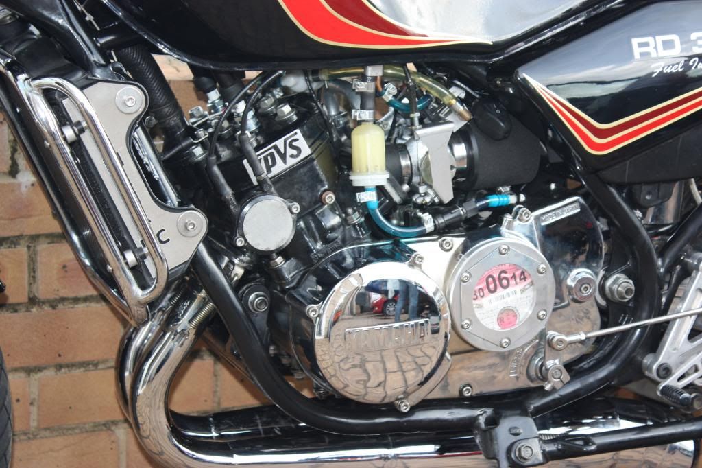

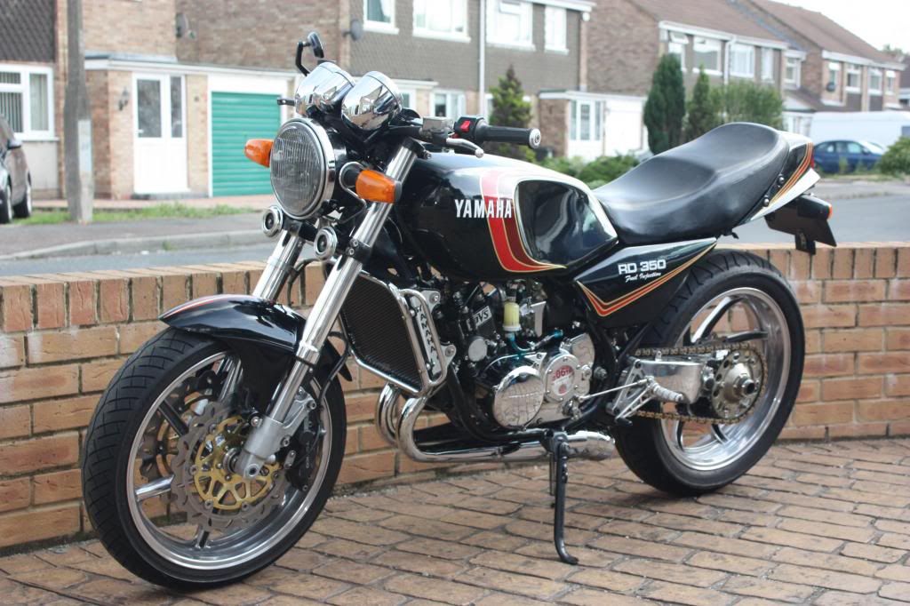

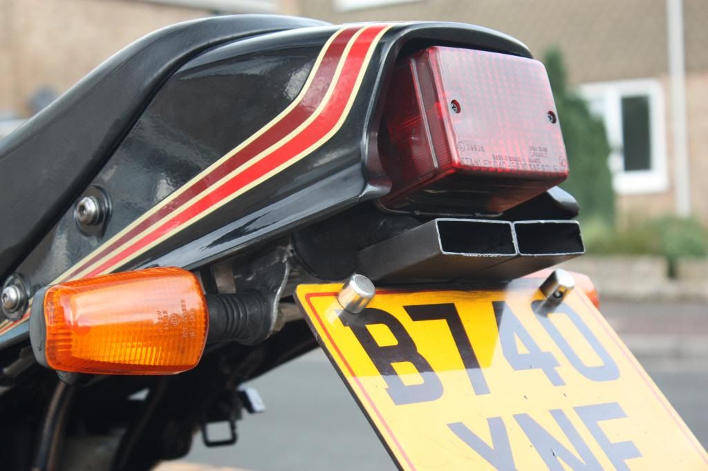

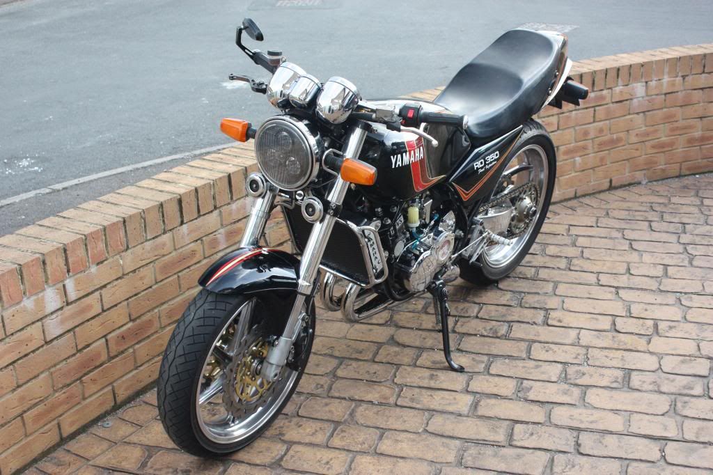

heres some pics of my RD hybrid recently converted to EFI because im P***ed off with carbs peeing out petrol and being a pain.
so went for this setup so far its been ok massive power band a little lumpy in low revs but alls forgiven when you get to the yee ha bit
any way have a look its quite cool

PostPosted: 21:49 - 05 Oct 2013    Post subject: Reply with quote
Thats a very nice bike. did you build it
hybrid350lc
Joined: 15 Oct 2012
PostPosted: 21:52 - 05 Oct 2013    Post subject: Reply with quote
most of it yes but nk racing helped to
highly recommend him if you need any work done

What's the spec on the efi system?
hybrid350lc
Joined: 15 Oct 2012
PostPosted: 09:55 - 06 Oct 2013    Post subject: Reply with quote
EFI is from an upgrade for the ZZR250 ninja
common rail system injectors run at 1.84gms ps each squirt
timed by linking to the ignition pickup as you cant use a lambda sensor on a 2 stroke
cheers
tom

hey all
thanks for the good feedback
the EFI kit is from a company called Ecotrons in the states they say it needs a little modifying to get it working well thats a bit of an understatement but all in all it was not to bad a job.
all in with new cables filters and cost of kit with shipping and duties to pay its around $1000 which seems steep but if you think how much a good quality set of carbs are its not to bad its about £790 in our money
cheers
tom

PostPosted: 17:18 - 08 Oct 2013    Post subject: Reply with quote
Yes please tell us more about the tuning. So your not using an o2 sensor in the pipes, but what about an EGT sensor? TPS? Air inlet temp/pressure?
Is the EFI set up totally separate from the ignition system or are you using a combined ignition/fuel ECU, and if so is the ignition timing 2D or 3D mapped?
Oh yeah and is your high pressure fuel pump mounted inside the fuel tank?

hi
im learning as i go and being advised by Ecotrons they said it has to run through a learning process to start with before any adjustments can be made to the mapping and if you email them the results of the edu recordings they will make these adjustments for you.
as i said before they are very helpful.
the ignition tells the injectors when to do there thing by connecting the pickup sensor to the main loom from the efi ecu
you can use 2d or 3d mapping with the procal software supplied
as i said the tech side is still a bit new to me so i cant answer any deep and meaningful q's
cheers
tom
