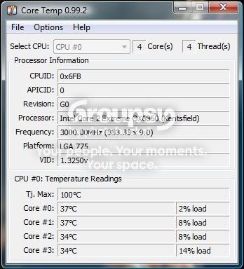

Here is a screen dump of mine
Finglonga
Joined: 27 Jul 2004
PostPosted: 12:32 - 16 Sep 2008    Post subject: Reply with quote
Exactly the same temperature readings as Everest . . .
