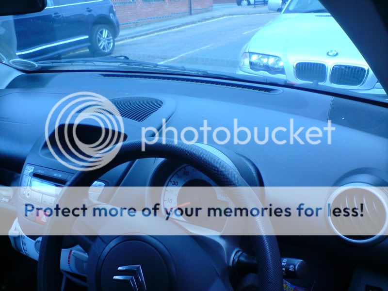

The main problem I have with installing them at the front is that my car doesn't have your conventional door speakers. Instead the speakers are right at the front of the dash, which I imagine will be a royal pain in the arse to get too.
I too would much prefer decent sound from the front.
Not should I would want a woofer as: -
A) The boot is tiny, wouldn't want to stick something like a woofer in it.
B) I'm on a tight budget.
My car dash...
Grab a Haynes and have a look at how to remove those grills. They might well just be a push fit, revealing the speakers as soon as they are out of the way.
Also check for any other positions set up for speakers. Likely to be other places designed to hold speakers on higher spec models. If you are lucky they may even already be wired up.

I'm just gonna have a search about on the net for some sort of guide to changing the speakers.
My spec of the C1 is the lowest spec available. Not even got central locking or leccy windows. Laughing The courtesy light doesn't even come on when the passenger door is open. Laughing
PostPosted: 09:42 - 02 Oct 2008    Post subject: Reply with quote
They are unlikely to have spent extra money tooling up new plastic interior panels especially for the cheap spec car just to remove the other speaker positions.
