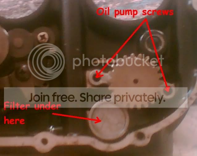

Right. You'll haved heard about how these are unreliable bikes yeah? I'm about to tell you why and what to do about it.
Order a new right hand crankcase cover gasket, or be prepared to make a new one, it is a paper gasket. Order a new oil filter, buy some oil.
Drop the oil, take off the right hand side cover.
You will see an orange plastic sprocket which engages with both the crank and the oil pump. Pull this off and inspect it for signs of wear or damage on the teeth.
https://i48.photobucket.com/albums/f216/stinkwheel/305/Image091.jpg
The oil pump is held on by two cross head screws. You will need a T-bar screwdriver or an impact driver to undo them. Carefull not to burr them.
https://i48.photobucket.com/albums/f216/stinkwheel/305/Image092.jpg
Once the oil pump is off, you will see a rubber seal on the end of a pipe in the oil feed channel. Get hold of this in some needle nose pliers and pull it out. It has a guaze filter on the end which will be full of bits of crap. This is why these engines eat their top-ends.
https://i48.photobucket.com/albums/f216/stinkwheel/305/Image093.jpg
Clean it out and reassemble, put a dab of grease in the 'socket' that the oil pump drive sprocket goes into.
Fit a new paper oil filter, put new oil in. Change it regularly (it only holds 1.8l)
The one I had had done about 18k from new, had been dealer serviced and the filter was beginning to get to the point where it would cause problems.
If you don't do the above. The filter will gradually block, the pump will experience increased resistance due to having to suck oil through a smaller hole. At some point the load will exceed the strength of the teeth on that plastic sprocket and they will snap off. You now have zero oil pressure. The motorcycle is NOT fitted with an oil pressure warning light so the first you will know about it is when the cam seizes in the head. You can then sell me all your cycle parts on ebay at a knock-down price Wink .
I've rebuilt one of these engines from the ground up twice in the last six months so if you need any help, PM me.

About once every 15,000 miles seems about right. They are a lovely bike to ride and faster than they have any right to be (a good one will hit 110mph). Trouble is they are based on a 1970's engine design that has been tweaked and bored out to perform way beyond its original original specification.
This, coupled with the design flaw of a too-small oil pickup located too near the bottom of too small a sump means they are a fairly delicate engine.
That said, you got a running bike for £150, if it lasts the winter, you're quids-in. If you change the oil regularly, warm it up properly and don't push it too hard for too long, it might last even longer than that.

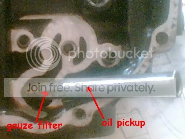

Superdreams also have a guaze oil screen which nobody ever bothers cleaning but they are located in a slightly more sensible place. You still have to take the side cover off to get at it though.
