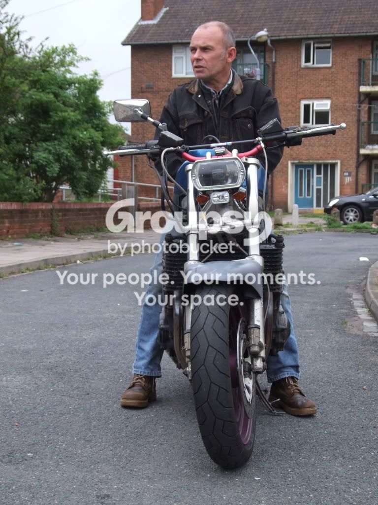

NiteMare
PostPosted: 16:34 - 06 Nov 2008    Post subject: Reply with quote
if you look closely you'll see my indicators, i bent the rules a little bit Mr. Green
https://i259.photobucket.com/albums/hh311/NiteMare_08/2008_05260013.jpg

PostPosted: 09:17 - 07 Nov 2008    Post subject: Reply with quote
NiteMare, I trust you have had no MoT issues with those wee fellas

NiteMare
PostPosted: 21:52 - 07 Nov 2008    Post subject: Reply with quote
none at all Mr. Green ...
construction and use rules may be different tho, depending on year of first registration
