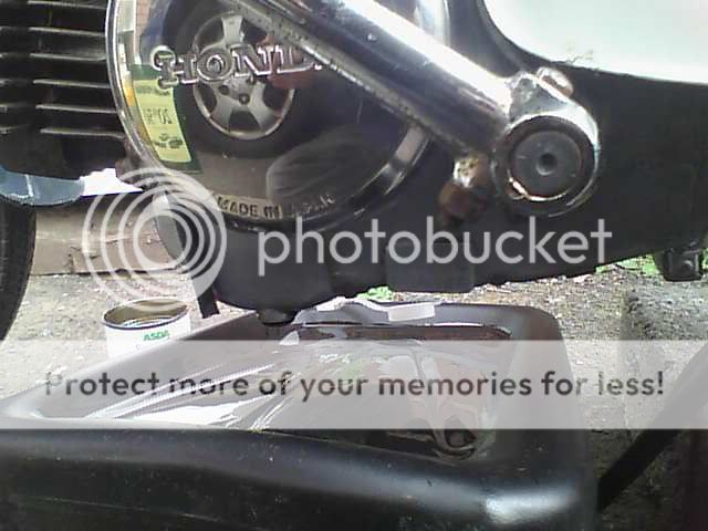

Down for repair now, The PC50 has decided it doesnt like its new oil either and decided to spew it out through the crank-case halves. Not sure if the gasket has gone or what, but that's what I'm assuming.
Anyway, A few pics of me taking the engine out =P
Draining oil out...

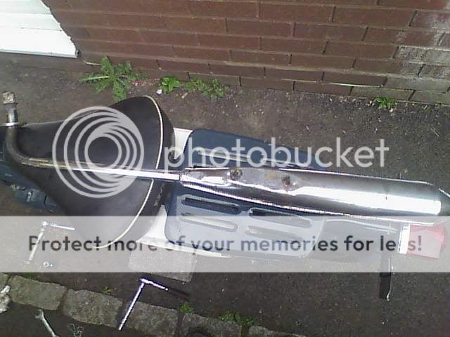

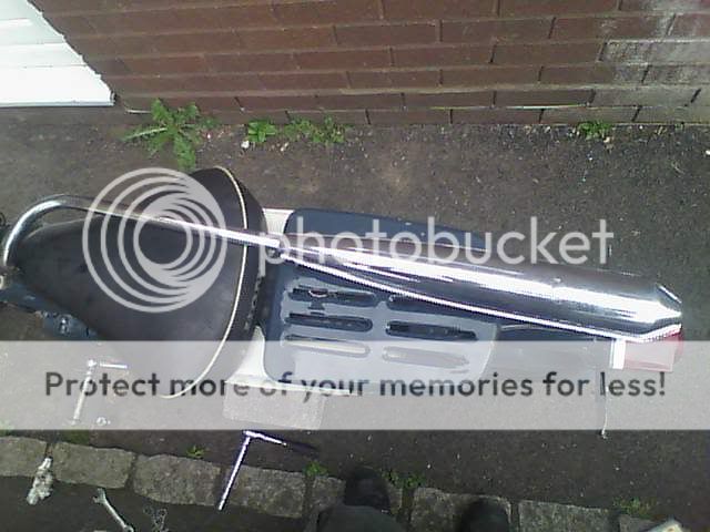

exhaust disconnected (Not bad for a 39 year old bike)
https://i138.photobucket.com/albums/q262/Snaphappyalex/Honda%20PC50%20stuff/DSC00035.jpg
https://i138.photobucket.com/albums/q262/Snaphappyalex/Honda%20PC50%20stuff/DSC00034.jpg

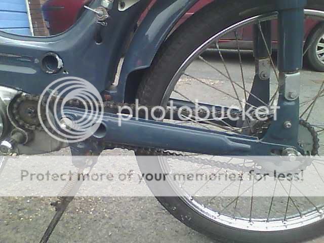

Chainguard off and prep to remove chain
https://i138.photobucket.com/albums/q262/Snaphappyalex/Honda%20PC50%20stuff/DSC00039.jpg

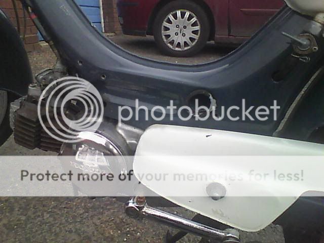

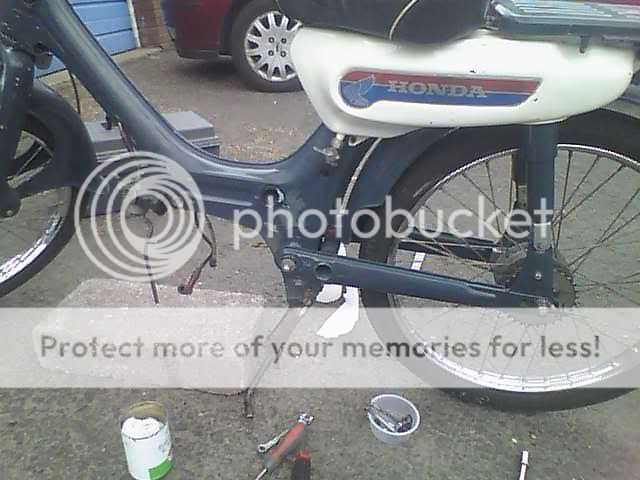

Disconnect some other bollocks and drop engine out.
https://i138.photobucket.com/albums/q262/Snaphappyalex/Honda%20PC50%20stuff/DSC00040.jpg
https://i138.photobucket.com/albums/q262/Snaphappyalex/Honda%20PC50%20stuff/DSC00041.jpg

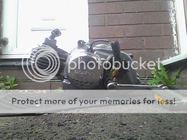

PostPosted: 18:42 - 16 Apr 2011    Post subject: Reply with quote
Right, found out where it's leaking oil from, I filled her up and turned her upside down, I'm losing about 1ml a minute of fresh oil (20-50) from the hole shown in the centre of the pic, This to me says the crank case gasket is shot at some point in that hole. I was thinking, as a temporary solution, could I not just block up that hole with a whole lot of gasket putty compressed in?Wouldnt that contain the oil till a more serious leak occurs?
https://i138.photobucket.com/albums/q262/Snaphappyalex/Honda%20PC50%20stuff/DSC00043.jpg
Help? =P
