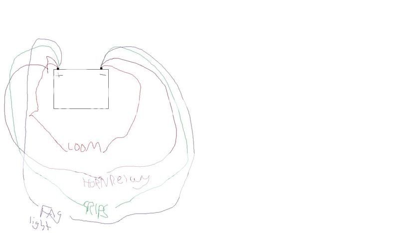

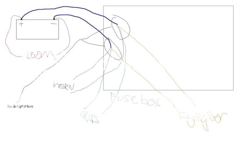

PostPosted: 21:53 - 04 Feb 2009    Post subject: Reply with quote
How would I split the single wire from the battery though?
The air horn is on a relay, everything is fused individually.
Now
https://img.photobucket.com/albums/v295/chris-red/my%20pics/now.jpg
should be
https://img.photobucket.com/albums/v295/chris-red/my%20pics/shouldbe.jpg

get the multiple wires , trim the ends and twist them together creating one wire Thumbs Up
looks messy but does the job and can be covered up with insulation tape

That should read, you can twist the ends of the wires together then solder them and cover the joint in adhesive backed shrink tube.
That way if you land up selling the bike to stinkwheel at some point in the future, he doesn't have to track you down and shove your insulating tape up your arse after spending two days tracking down an intermittant wiring fault.
EDIT:
How about wiring up a couple of terminal blocks in the following fashion? (less shit paint diagram attached)
You can buy terminal blocks ready to crimp and assemble yourself. Have your accessories on the other half of the block.
Providing the wire is thick enough, this is a tidy and elegant way of doing it. You would be able to unplug the battery from the loom without any tools.
As has been said, connect earths to the frame near where the accessory is. You only need one earth strap going between the battery negative and the frame itself.
