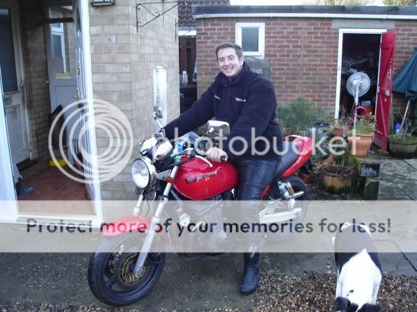

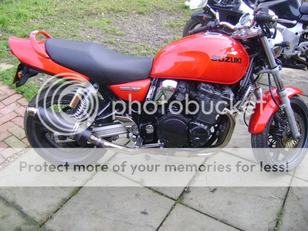

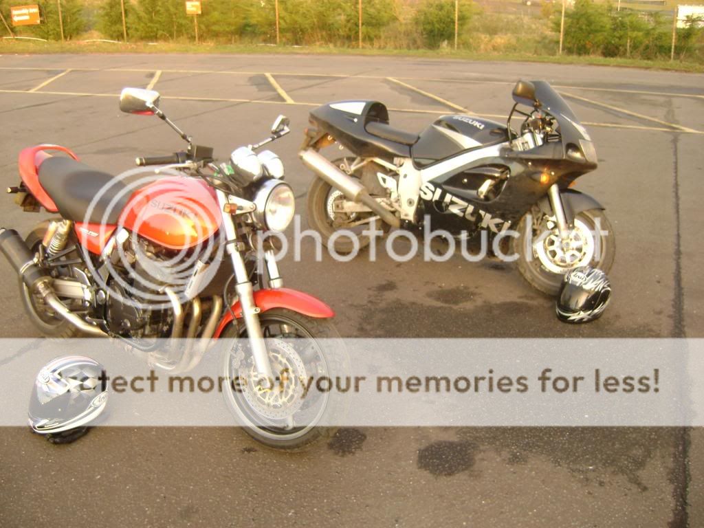

The Inazuma is actually brilliant bike Seems to pull pretty well and its incrdibly comfortable excluding the wind bashing your face about
Sounds good and does 2 up well
This is my brother in laws just before i rode it Laughing
