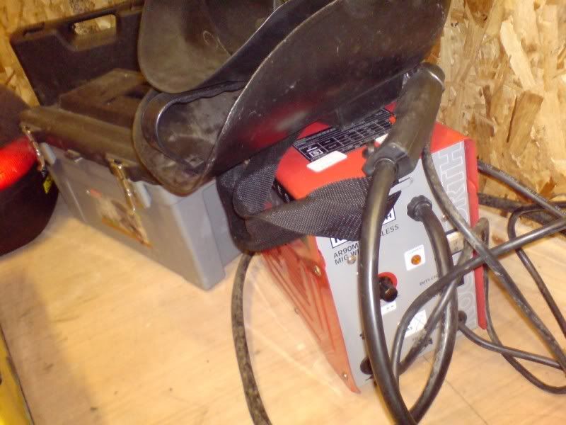

i'd say the voltage was way too low. theres no penitration there. up the voltage 2 notches on the fine adjustment, VERY slightly on the wire feed then try again, as too much wire causes splatter too.
the splatter i would say is caused by the wire you're using.
im assuming you didnt pay £30 for a gas welder, and you're using gasless MIG, meaning a flux cored wire which causes more splatter than normal and a messier weld.
experiment on a bit of scrap first.
saying all that, the pictures arent exactly clear, so i could be talking out of my arse.
The penetration is there,and i've been hitting it with a hammer to make sure it doesn't move.It's solid.
Yup it is a gas-less welder.
It only has a high~low switch and a dial for the wire speed (cheapo hobby welder)
The splatter i'm not bothered about 'cos i'm grinding all the welds flat as i go.I'll get a few more pics up soon (passenger side is almost done now)

Welder:
https://i187.photobucket.com/albums/x13/fronterapics/welder.jpg
