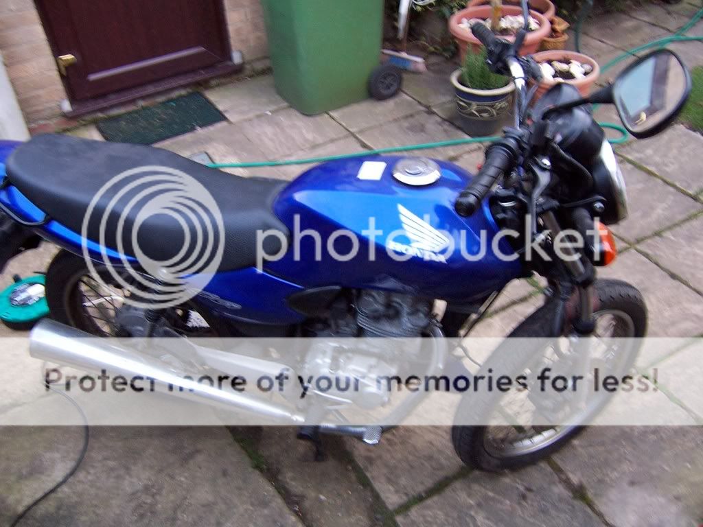

Ok well got hold of the CG125 yesterday, 2005, 7K miles, £100. 1 owner from new and a full service history :thumbup: The guy had a car pull out on him and the front end is well and truely screwed.

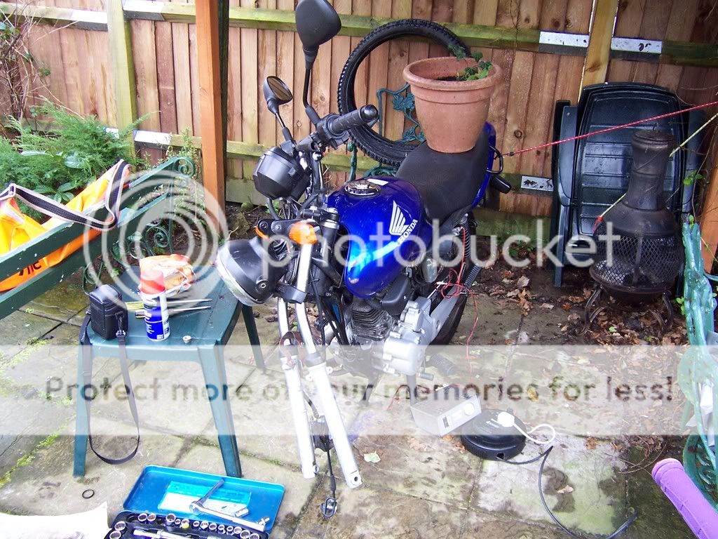

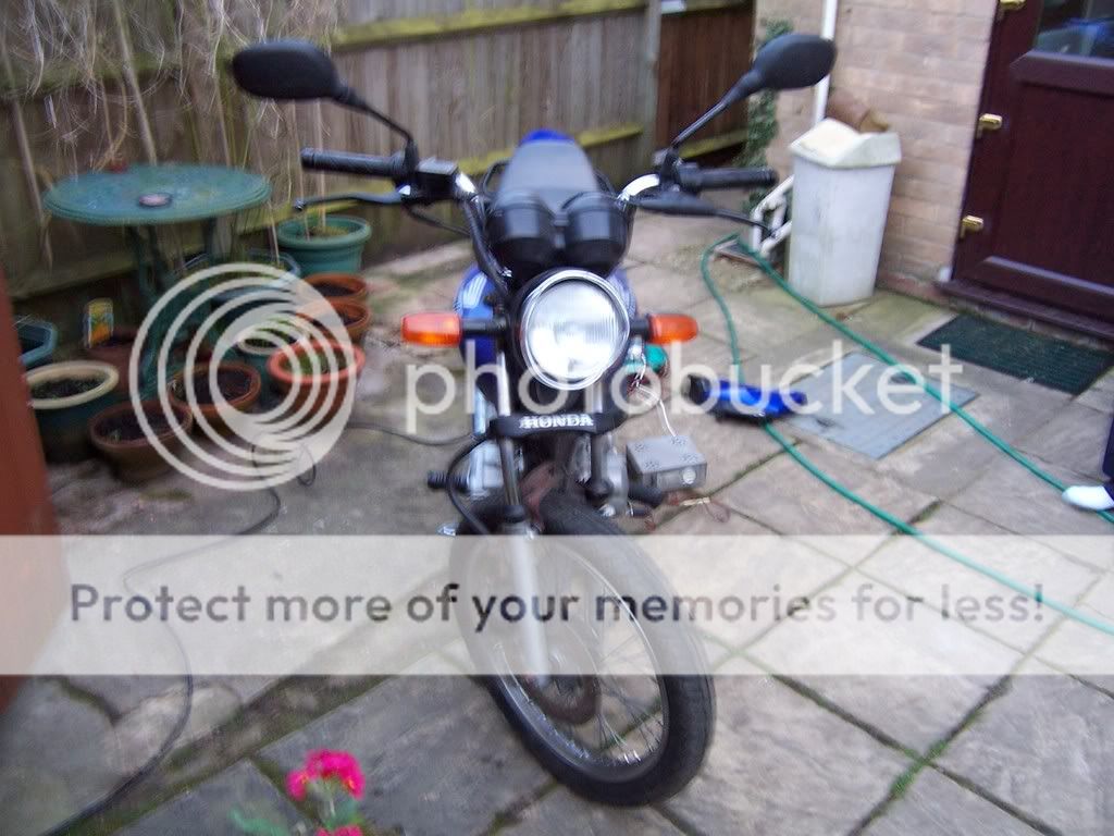

I thought once the front wheel is off the weight of the rear would keep the front held up, however this is not the case, so I bungeed the bike and put a plant pot on the seat, makes it look better too! Clapping

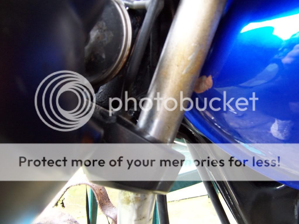

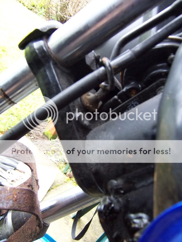

In the following picture is the bit on the bottom yoke where there is a little pin to stop the handlebars turning all the way left, however this was sheered off in the accident, causing the forks to make a dent in the tank Eh? . So if anybody knows if this problem has to be resolved before it will pass an MOT feel free to tell me Razz .

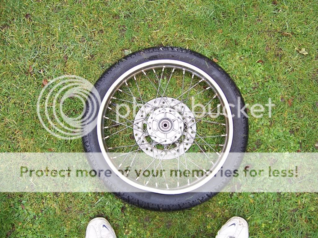

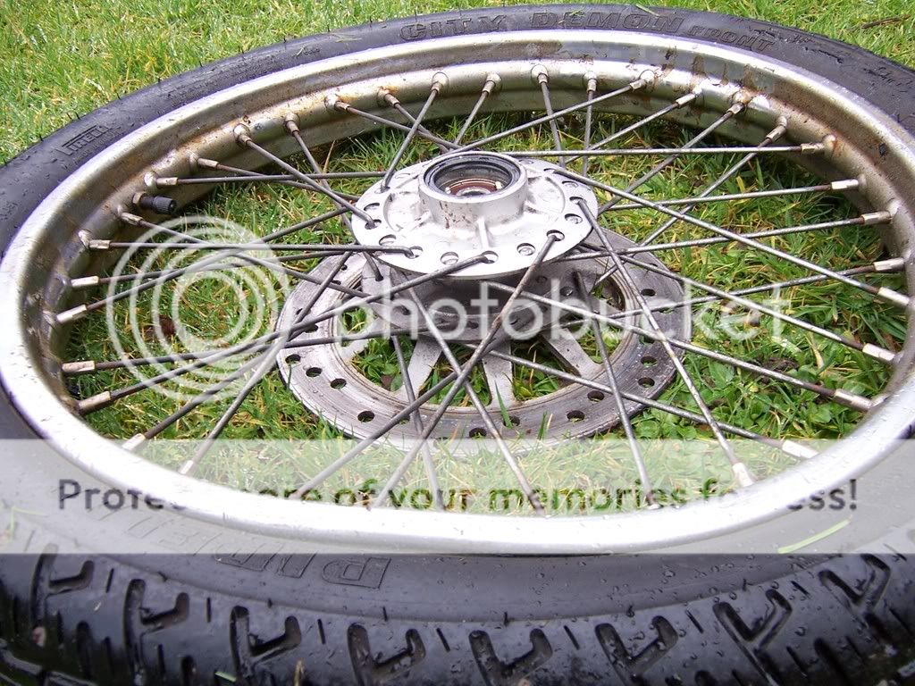

And here we have a couple of pictures of the bent wheel, was hoping it would be able to be "trued" out and straightened but thats unlikely having a closer look at it.

Yes you will have to repair the lockstop before you get the bike M.O.Ted.

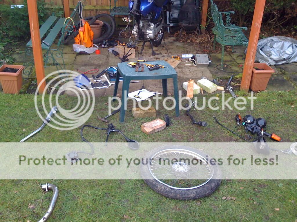

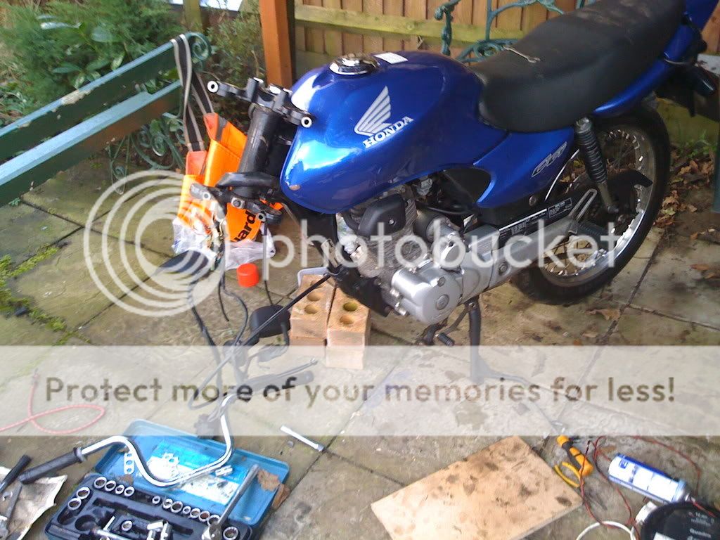

More progress:

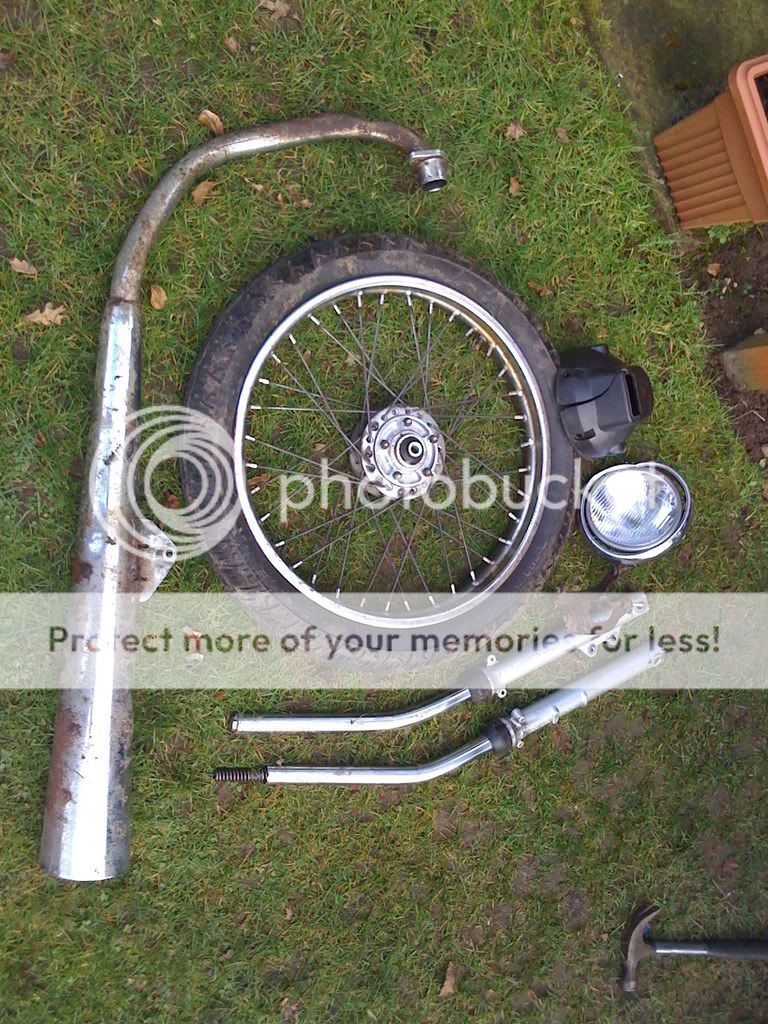

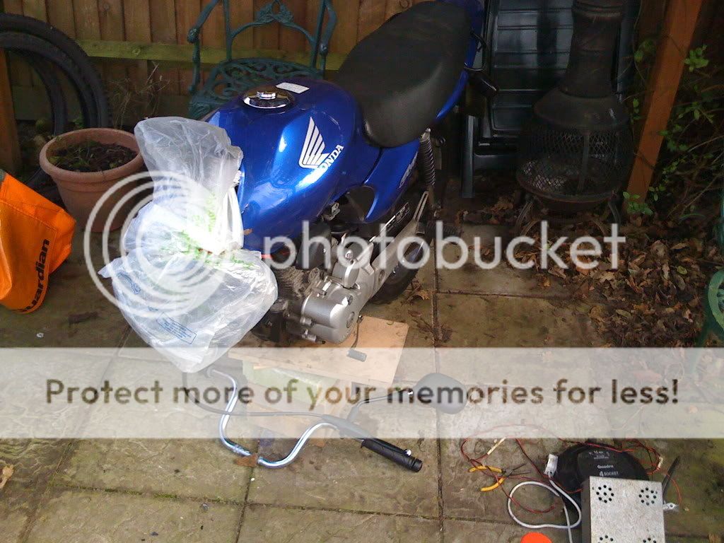

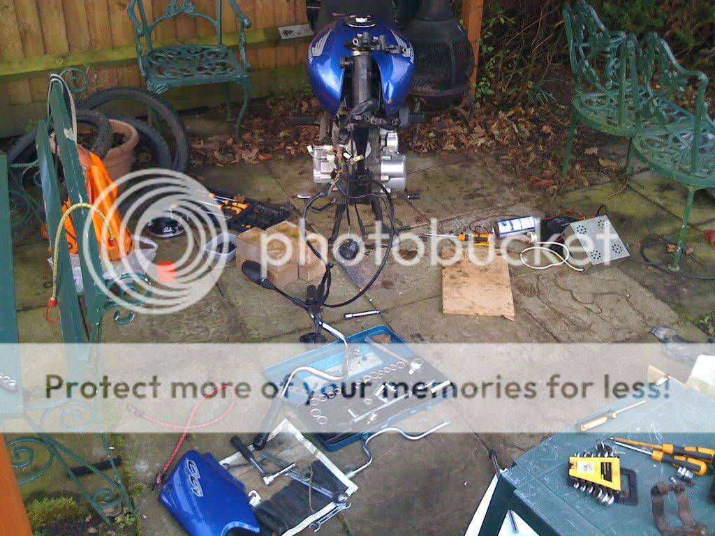

Managed to get the forks off, undid one of the forks completely, to have a bolt fling out of the top from the spring lol. Also got the exhaust off, and the foot rest bit as one side was bent.
https://i206.photobucket.com/albums/bb106/timmyboynorwich/Picture008.jpg
https://i206.photobucket.com/albums/bb106/timmyboynorwich/Picture007.jpg
https://i206.photobucket.com/albums/bb106/timmyboynorwich/Picture004.jpg
https://i206.photobucket.com/albums/bb106/timmyboynorwich/Picture005.jpg

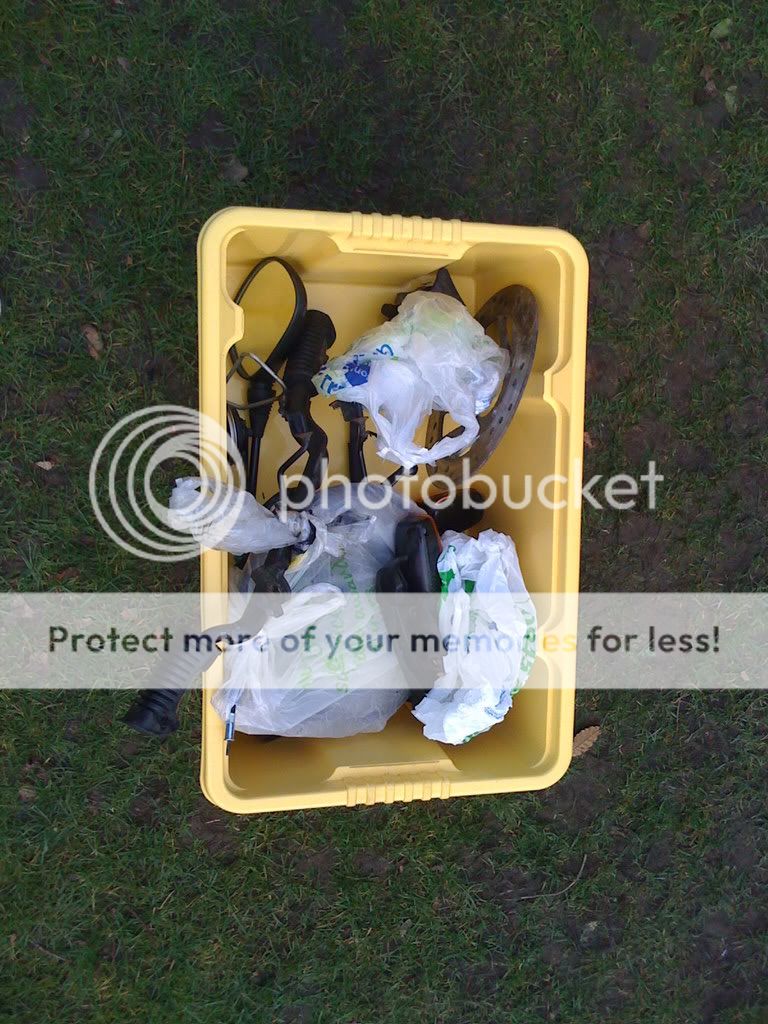

Bits I dont need:
https://i206.photobucket.com/albums/bb106/timmyboynorwich/Picture009.jpg
Bits I do need:
https://i206.photobucket.com/albums/bb106/timmyboynorwich/Picture006.jpg

PostPosted: 18:43 - 10 Mar 2009    Post subject: Reply with quote
Are you not going to keep the fork bottoms or are they damaged too?

that hub looks ok it the pic ,just get a new rim, spokes and nipples if you can build a wheel (or this is a perfect time to learn)
but if you cant and dont know anyone who can it might work out cheaper to buy a new wheel
I was thinking that myself.
I'd also be taking the tyre, and the headlight glass lense if it's salvageable.
Have you checked the headstock of the frame for signs of damage?

To repair a damaged lock stop:
File down the remains of the damaged stop until flsuh with the yoke.
Drill a hole to take an M10 or M12 bolt.
Tap said hole to take said bolt.
Screw on a nut (Or two) to the bolt all the way to the head.
Screw bolt into yoke.
If the bolt sits too low and doesnt stop at the lock stop, raise the height of the bolt by backing the bolt out of the hole and using the nut(s) to lock the bolt against the yoke.

alun111 wrote:
They are a bit scuffed at the top near the seals, but alot of the forks on ebay come with the fork bottoms.
The headstock bearings are screwed, they stop at 5cm intervals when you are turning the forks.
With regards to the headlight lense, i'll probably just be buying a universal headlight that will go on.

He didn't mean check the headstock bearings, he meant check the headstock for signs of cracking or bends.
You do know you could save the headlight lens and fork bottoms and sell them on Confused

The fork bottoms are scuffed, right near the seal too! Also the headlight lense is chipped, so not really sure why anybody would buy these items. Sad
The headstock area looks good all bar the lock stop, however this will soon be resolved as i just won a pair of forks and yokes on egay off a '500mile bike', £103 posted. Will update when i fit them.
