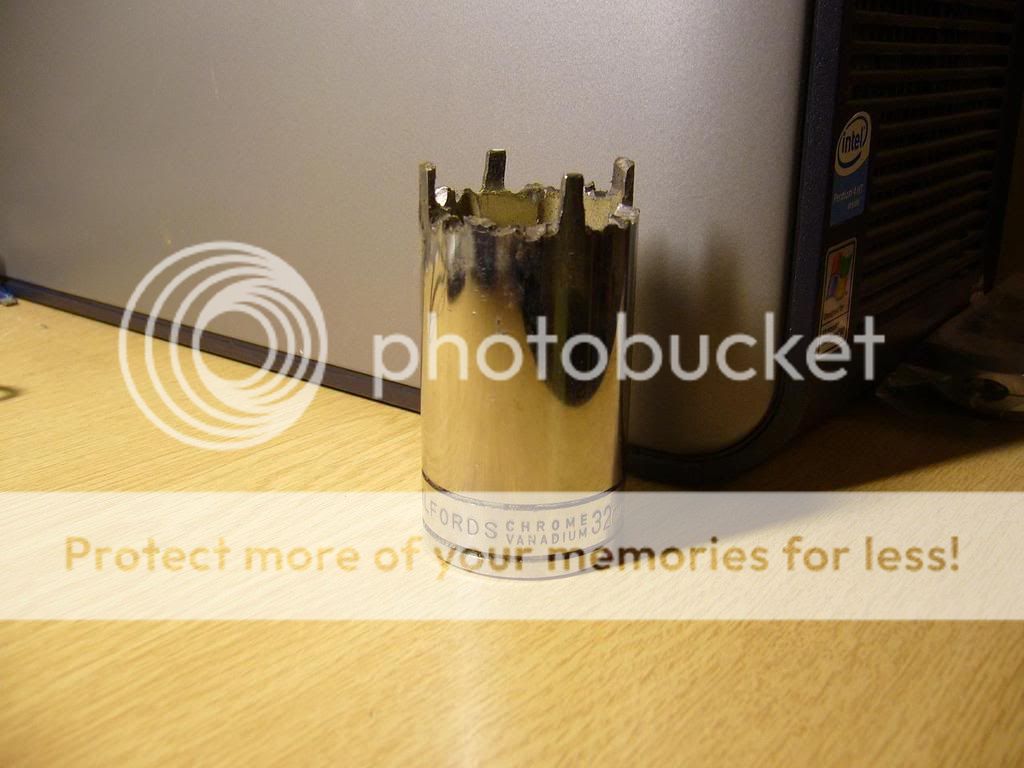

I am that hoover tube person.
This is a socket I butchered to make it fit the adjusting nut on my steering stem. Now I can set them first go with a torque wrench. It aint pretty but it works a treat!
I've seen them done before, and you're right it aint pretty... it's a work of art! I'm one of the fortunate ones that has 38mm adjuster nuts so a flat bicycle spanner does the job!

SoND wrote:
What did you butcher that with yen?
It was indeed an angle grinder. It looks worse than usual because it once had more pegs, but they were removed later on so it would fit the adjuster on my DR350 as well.
It's travelled a bit, so far it's been to south Wales and Greenwich. It may soon be posting itself up to Scotland for a friend's Africa Twin headbearing replacement.

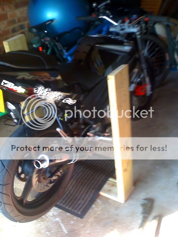

Just sat and thought about it and I've made quite a few over the years. Here's my favourite - a stand for my Hayabusa that allows me to remove the front and rear suspension including the swing-arm, and is sturdy enough to drag about the floor.
Now that, I like! Thumbs Up
