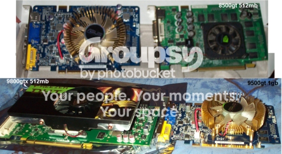

Some 9800gtx have 2 6pin, some have 1 6pin. Mine has 1, came with an adaptor to use 2 molex.
https://img.photobucket.com/albums/v612/SoND/cards.png
