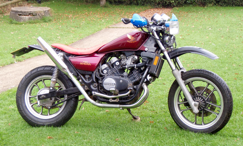

BTW (everyone else) Did I mention the Magna was modified?
https://www.pete.vnworks.net/rats/V30X-final2.jpg
