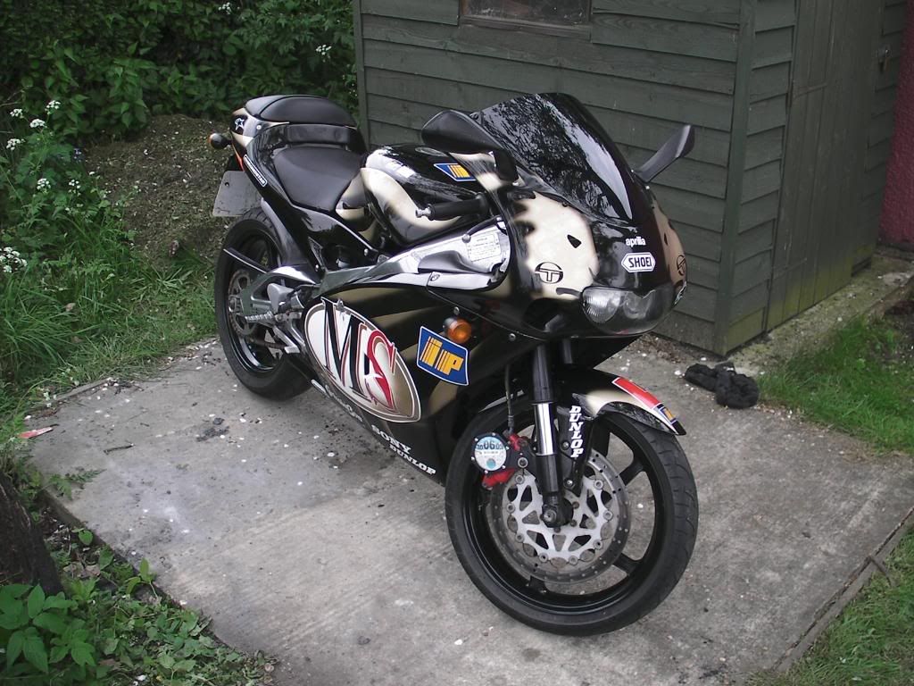

Well here it is.. my first bike.. at 25!
Absolutely love it, had it just over a week now and hasn't all been plain sailing, i've been having some starting problems but getting there now i think, and when its running its crazy amounts of fun Razz
Few bits and pieces on it, tinted screen, full arrow system, acumen alarm, smaller plate.
My next mods will be crash bungs/new inlet manifold (the rubbers cracking) along with boyesen reeds and a pipercross filter, then poss a 34mm carb eventually.
Dunlop d208 gp racers going on in the next week or two aswell Smile
A couple of pics..
