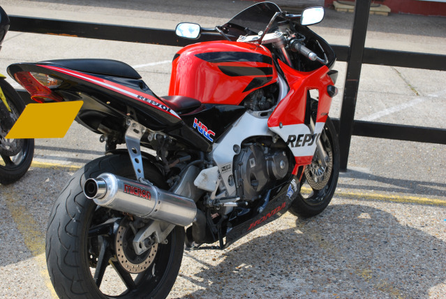

That bike looks pretty good though mate. I have a Honda CBR400 with a similar body-kit...
https://www.bikechatforums.com/files/my_honda_cbr_400rr.jpg
https://www.bikechatforums.com/files/dsc_0027_edit.jpg
