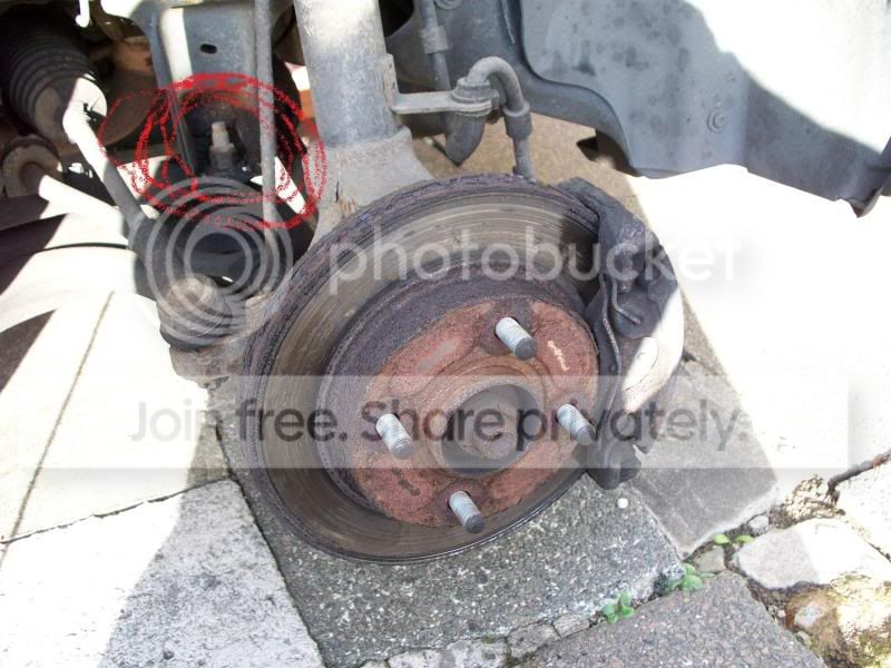

As you already know there fooked. But, is that car a ka? If it is, look at the picture and in the red circle the subframe/body mount looks fairly corroded. This can fail the mot if the tester has any clue what hes doing, failed two in recent weeks on those areas. Neutral

It is, and it does look rather corroded.
Might give it a rub down and coat it with some hammerite. Sound like a good plan?
(Fuck yeah, everyone in Workshop loves hammerite!)
I have a good friend who is a welder, so if it's fucked, he can fix it. Smile

I've not checked the other side yet, I'll check them both thoroughly when I do the brakes.
If it's particularly bad, then I'll just have to do what I can, and then flog it asap...
I really got ripped off when I bought this pos.

Nb
Joined: 17 May 2005
PostPosted: 17:30 - 14 Oct 2009    Post subject: Reply with quote
Yeah, clean it up and hammerite the crap out of it. And then grab some gravel and chuck it so it sticks on, nobody will see it. Mr. Green You can get a welding repair kit from ford, the repair normally costs about 250 pounds all in. Shocked
