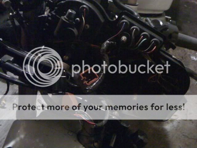

the zx7r i bought had a slightly messy electrics for indicators and im now sorting it out. now iv'e found a problem, basically if my clocks are plugged in all the indicators flash at the same time, yet if i disconect one of the cables for the clocks the indicators are fine.
https://i626.photobucket.com/albums/tt349/Kaiser_Damz/IMG_0211.jpg
its the brown one, if its plugged in it will cause all indicators to flash at the same time together, if its unplugged indicators are fine but obviously means the clocks wont work properly.
suggestions?

Could be a bad earth connection.
On the assumption there is a yellow on black wire in that block, try running a flying wire from the back of the terminal the yellow on black goes into (jam it in the back of the connector block so it is making contact with the terminal) to a good frame earth and see if the problem goes away.

My bad, it won't be the earth from the clocks themselves. I just had a look at a wiring diagram off the net and to be honest, it's a wonder they all don't do this. A lot is left to wishful thinking with the way the flasher repeater circuit works.
If you take the bulb out of the dashboard flasher repeater light with the clocks connected up, the flashers should work normally.
This being the case, it is probably a bad earth on the indicators themselves.
If you follow the yellow and black back from either of the front flashers, the two wires attached directly to the flashers will connect into the loom with bullet connectors. Probably not these but check them anyway.
Keep following the yellow on black back a bit more and there will be a second bullet connector designed to allow you to remove the fairing without actually having to detach both flashers (near a connector block with the headlamp wiring in it). Even money says that is not making good contact.
Circled on picture.
