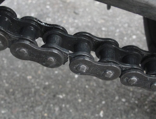

https://farm3.static.flickr.com/2769/4090450470_5ba63b0c7b.jpg
Shocked
Wondered what that strange clicking noise was for the past few weeks!!! Thought it was the slightly hooked teeth on the front sprocket and was planning to change the chain and sprockets anyway. Looks like I will have to do them sooner.
Didn't notice this last week, when I cleaned, adjusted and greased the chain, but have had a clicking coming through the pegs for a while now. I guess that it could have been snapped for a while but has only recently opened up like that (since the last adjustment)
Anyhoo, thought I'd share with the community as a reminder to do those daily checks.... And I'm also doing the lotto this week for defo.... Thumbs Up

Ouch. Although I would be surprised if that has been like that "the past few weeks". Might be worth a good look to find if something has damaged it (ie, something else making the noise).
What make of chain is it by the way?

Blimey Shocked Normally if the link goes on one side, the other follows almost at once, leading to carnage Shocked

I had a link half snap on me last year, felt a sudden click, but it was just before I stopped 100 yards down the road for a brew, looked down at the chain and nearly wet myself as we had been doing a few mph over posted on some very tight country roads.

I had the a similar thing happen earlier this year although not quite as bad as that. Was trying to patch up a small exhaust leak when I noticed the link directly behind the area I was working on was cracked although it hadn't opened up like the one in the pic above.
Very very paranoid about chains now because of that.
Best thing i've bought since I changed the chain was a loobman, only adjusted the new chain once in about 6000 miles since I put it on.
Still really paranoid though Crying or Very sad
As far as I know, the chain is a DID VM50X.
It was on the bike when I got it.
I don't know how old it is, how well looked after or even if it was brought from a reputable supplier?
I know for a fact that there was no 'visible' crack in the link a week ago, because I gave the chain a real thorough clean and adjusted it.
I spotted it today whilst greasing it.
I was very lucky as I had just been for a 15 mile blat, to warm the chain up for greasing.
When I did adjust the chain, there were 2 obvious tight spots which lead me to believe the chain was on it's last legs. I adjusted it to the maximum tolerance at the tight spot, but it was very loose between them.
So new chain and sprockets it is then.

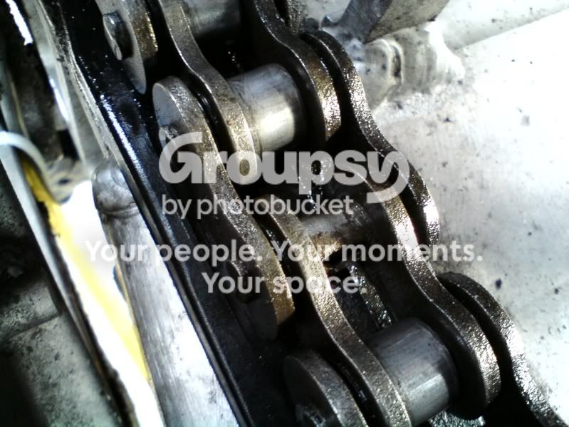

I had a very similar thing happen on my hornet several months back. Noticed the damage when cleaning my bike. The chain and sprockets had been clunking on acceleration too - up to about 40mph. My front sprocket was hooked like your's. I thought it was ok as it was only slightly hooked but apparently if it's hooked at all then it's fucked!
I think this damage was caused by the chain jumping off the front sprocket.
I can't remember what make the chain was but I think it may have been standard (on my hornet - so a D.I.D).

OK, I am not 100% certain that this was purely caused by the chain (and that there wasn't some pre existing damage that made it susceptable to this damage), but check the results of a chain snapping on Wildgooses Triumph Tiger:-
https://www.bikechatforums.com/viewtopic.php?t=49461
Chains do snap occasionally. Most of the time people get away with it. Sometimes there is some engine damage. Very occasionally they might get injured (although that does likely require the chain to move sideways when the end flings out).
