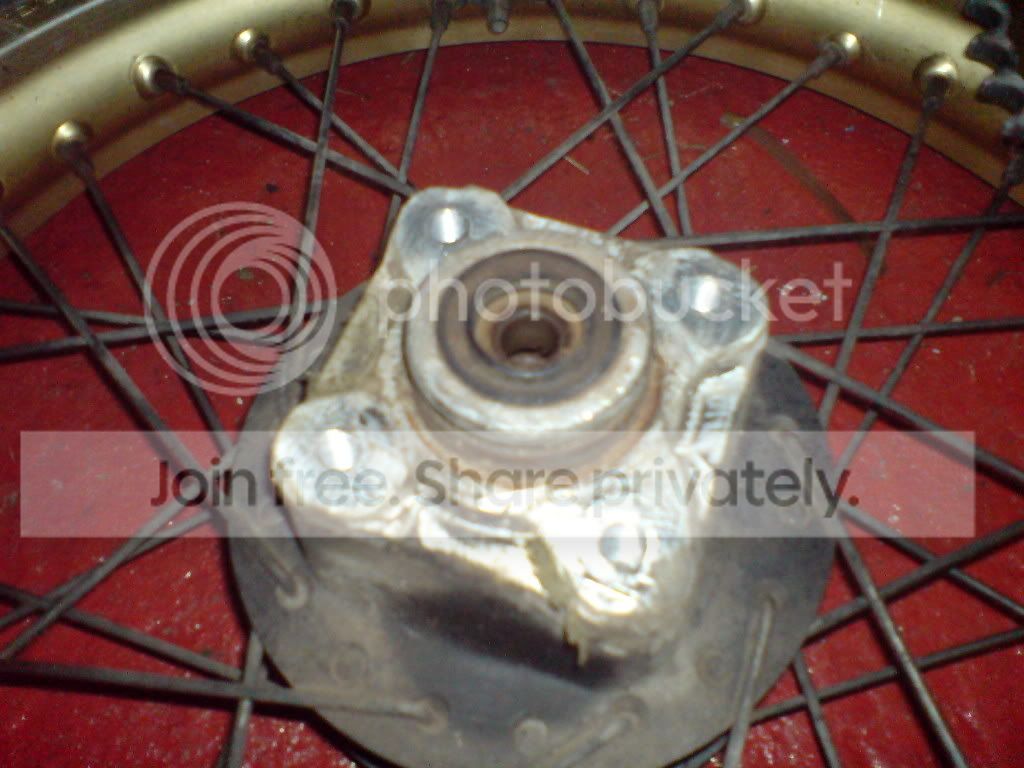

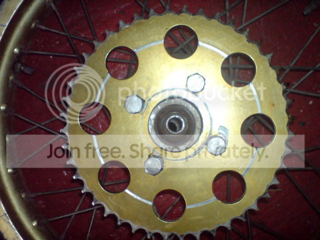

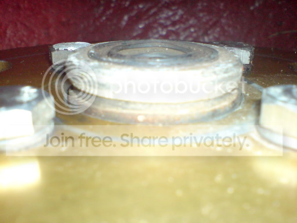

Here are pictures of what I had done. ( been like this 12 months now and no propblems what so ever.)
Ps them marks on the sprocket were cause when the circlip came off.
Pic one : The 4 bolts , 17mm heads.
https://i155.photobucket.com/albums/s297/honda_tlr/DSC00668.jpg
Pic 2 , the old circlip grove.
https://i155.photobucket.com/albums/s297/honda_tlr/DSC00670.jpg
Pic 3 , the drilled and tapped holes were the rubber cush drive used to be.
https://i155.photobucket.com/albums/s297/honda_tlr/DSC00672.jpg
