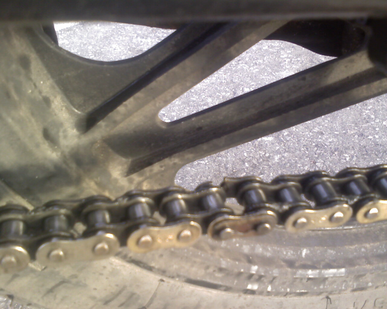

...after I had noticed a strange clunking sound emanating from under my feet. Carried on carefully until I got to my breakfast pit-stop (Tesco), and discovered this:
https://www.bikechatforums.com/files/image_005.jpg
Shocked
I'm guessing I was extremely lucky as it could have potentially been nasty.
Left the bike there in a more 'inconspicuous' location and got the shuttle bus into work. So now, I need to get the bike taken home (30 miles away). I'm with AutoAid, which should hopefully cover it, unless they can send someone out with a new master link and get it put in (not that I trust that chain any more)!
The funny thing is that the chain is an IRIS X-Ring jobbie and it wasn't cheap either (£60). But I have heard bad things about those chains... going for DID next time. Meh.

Actually... got one at home as the chain came with both types, just need the tool and I can sort it. The chain only has 8k miles on it and is nowhere near the adjustment limit.

I'm not a fan of soft links either, but that shouldn't have happened like that. I would keep the link and start making noises to your supplier or / and iris.

I actually heard it go. For the last few weeks there's been this on and off knocking around the front sprocket that would get faster as I went faster. I investigated it a few times and both sprockets aren't worn at all and are perfectly secure with everything in place. After slacking off the chain a bit it was fine. So I'm guessing that link gradually distorted on one side until it finally snapped. The rest of the chain was fine. I clean it once a week with paraffin and lube with 10w40 now through an automatic oiler thingy (Loobman, although I previously used the Wurth dry stuff). Also, the point at where it snapped doesn't look like a part of the link that would be worn down by normal use, so I'm looking at weak metal perhaps? I fitted the chain last April so it isn't old either.

UPDATE (for those who care!): Got recovered and taken home, gonna claim it back off AutoAid. The guy also fitted my 'real' link that I managed to dig out of the garage, which saves me waiting for the tool and having to take the train to work tomorrow.
He also mentioned that those split links are weak because of the way that they are pre-riveted on one side (the side that failed in this case) which was interesting. Well, I know not to be lazy next time and do it properly. I went over the whole chain with a fine tooth comb and couldn't find anything else wrong. Result! Thumbs Up Karma

There's nothing wrong with split links, especially on a 125, it definitely shouldn't have snapped like that. I run split links on the 500's and have never had one fail.

I have always maintained that split links are dangerous. People try to tell me it's because I haven't fitted them properly.
I've found them broken in exactly the same way as above but minus the keeper plate (and lying on the road half a mile back following an abrupt loss of power). What's interesting is the order it happened. I always thought the keeper plate had somehow pinged off leading to excessive force on the back plate which eventually cracks and splits.
Could be it happens the other way round which would be harder to detect on a casual inspection, I usually just looked to see the clip was still in place when I checked my chain. Could very easily have missed a cracked back plate.
Anyway. Solution is the same as I came up with a number of years ago. Don't use split links.
