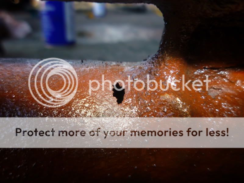

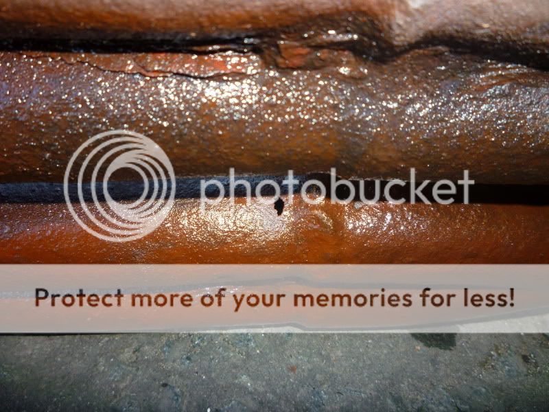

PostPosted: 16:48 - 19 Feb 2010    Post subject: Stipped off the exhaust, found a hole in the downpipes! Reply with quote
Came home after work and attacked the bike with a ratchet! What a pain in the arse! Got the whole exhaust system removed (quite proud of myself really Razz) but while cleaning the downpipes I found a hole!
https://i4.photobucket.com/albums/y118/Wonderboy_001/P1000369-1.jpg
https://i4.photobucket.com/albums/y118/Wonderboy_001/P1000368.jpg
I'm guessing that is the cause of the noise then? Can it be fixed or do I have to buy a new downpipe? Sad

PostPosted: 16:53 - 19 Feb 2010    Post subject: Reply with quote
Told you about the collectors Laughing
They can be welded, I did one on a CBR6 last weekend. Give then a good poke first to make sure that there are not any other weak areas.
New stainless steel downpipes can be had for around £100 off ebay.
PostPosted: 16:55 - 19 Feb 2010    Post subject: Reply with quote
That should be weldable, but given how rusty they are a few more bits are probably just about to blow.
If you can get replacements for reasonable money the do.

I would say that it added to the noise. I think the pipes are not sitting correctly in the head, probably due to knackered exhaust gaskets. Its very hard to tell when your not actually next to the bike.
When the exhaust is cold stick your finger over the hole and see what happens to the noise. Even better if you can then cover the end of the can.

looks to me like theres a second hole at the top right of the second pic.

This is the best way I know how to find out where an exhaust is blowing - before the pipes get to haot, place the palm of your hand around the area you think the exhaust is leaking. You'll feel the hole well before you see it. (bit late now I know).
I usualy find that welding up rotten exhausts is like pissing against the wind - you fix one hole and it'll just blow elsewhere. You might be able to save a few quid by making one good exhaust out of two crap ones.
Where the downpipes are bolted to the head, (or "not" as the case may be), looks very bodged up. You need to clean out the exhaust ports really well before sticking some new pipes on. Are all the mounting studs ok?
Well that was an idea - strip the rust off it, get it welded the paint it with black exhaust paint. It would save a lot of money but I would hate if it were to develop another hole a month later, but I suppose it's taken 16 years to get that one.
As far as I could see they were also no gaskets fitted to the downpipes either. The studs seem to be fine which is good Smile
well spotted Thumbs Up
I would 100% invest in some new downpipes rather than spend alot of time and money playing about with a knackered set.

Damon wrote:
Where's that? I can't see it from the picture Neutral Your probably right, its just money, getting a decent second hand set would be the best option.
