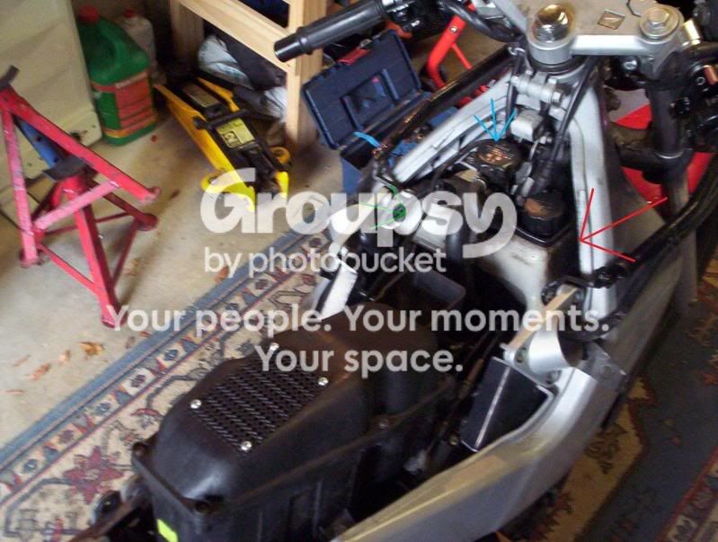

Here is a pic of my old NSR to try help clear it up,
Red arrow is where the two stroke oil goes, Green arrow is the coolant expansion tank, Blue is where you fill up the cooling system.
https://i55.photobucket.com/albums/g123/ncrn/cooloil.jpg
skatefreak
Joined: 06 Feb 2010
PostPosted: 10:57 - 10 Mar 2010    Post subject: Reply with quote
Ahaaa!
ncrn, thats the ticket!
So i got the tanks right, just have to check the water in the system has some antifreezy stuff in it!
I would have thought there was as te bike has been kept outdoors and its been pretty cold lately...
Always best to check tho so the coolant will have a smell wont it...
Will get right onto it Smile
