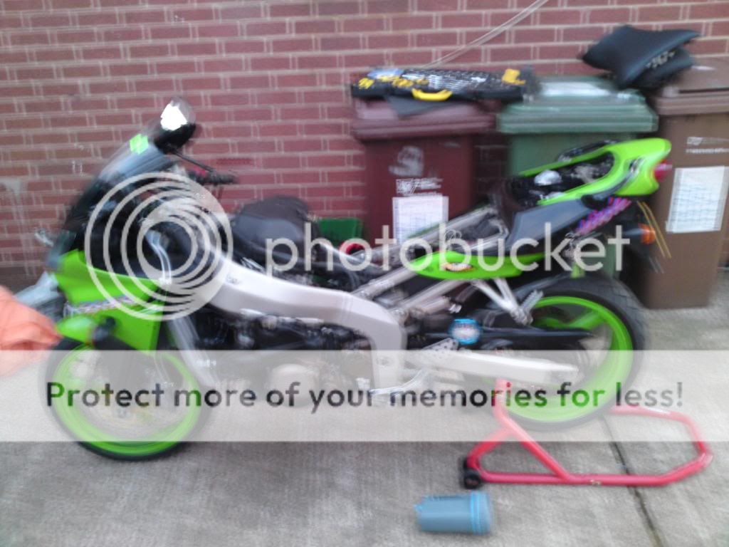

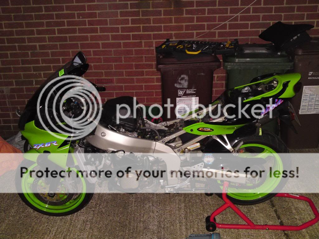

rite well i cant seem to find the ones of removing the restrictors but heres a couple of me stripping it down...
https://i999.photobucket.com/albums/af114/brettfev/05122008042.jpg
https://i999.photobucket.com/albums/af114/brettfev/DSC00073-1.jpg
https://i999.photobucket.com/albums/af114/brettfev/DSC00074-1.jpg
https://i999.photobucket.com/albums/af114/brettfev/DSC00075.jpg
iv got a picture of the restrictors somewhere aswell. you wont believe just how small they are!
