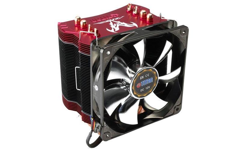

https://www.pcspecialist.co.uk/images/products/1870/1_big.jpg
TITAN FENRIR TTC-NK85TZ/V2
Fenrir-TTC-NK85TZ has many rich characteristics; comparing with the original heat pipe size at 6mm, Fenrir possesses 4 larger 8 mm diameter copper heat pipes with the direct touch design to maximize the overclocking performance up to 160W and succeed in offering the best cooling performance. The 12cm giant fan with built-in PWM speed control technology will operate automatically to solve overheating problems and provide a silent environment.
The Fenrir, especially suitable for Intel LGA1366 and LGA 1156 (TTC-NK85TZ/V2) is absolutely the best thermal solution for your computer.
Hows that? better or not? im trying to avoid buying things and adding them on.
