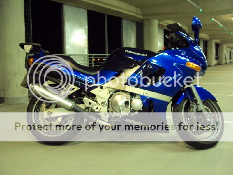

They rock - get an E as opposed to a D if you can.
ZZR Whoring:
https://farm4.static.flickr.com/3436/3225833572_736eecd2f7_b.jpg

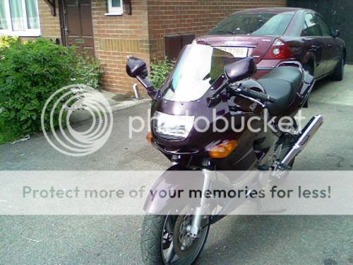

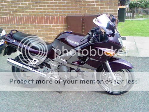

Al-right, if you insist, meet Ron
https://i235.photobucket.com/albums/ee81/paddy2007dug/newbike.jpg
https://i235.photobucket.com/albums/ee81/paddy2007dug/newbike2.jpg
