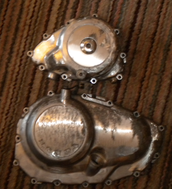

I noticed in another thread that somebody painted the engine cover.. shown below.
Is it safe to do so and what's the best method, as this would look pretty nice on my bike?

Take the covers off, carefully scrape off the old gasket, remove the filler cap and inspection covers.
Brush liberally with Nitromorse paint remover. Leave to stand for 10 minutes. Rinse off. Apply more nitromorse to any left over bits, re-rinse.
This'll leave you with clean, bare metal.
https://www.bikechatforums.com/files/covers.png
Rub down any corrosion with wire wool. Thoroughly wash in hot soapy water then rinse to degrease them. Mask off the threads for the filler cap and inspection covers.
I like to warm parts in the oven before painting (warm, not cook).
Apply lots of thin coats of plastikote BBQ paint, letting them almost dry between coats (about 5-10 minutes depending on temperature). Try to put too much on at once and it'll run.
Leave to dry for 24h. Remove any traces of overspray from the inside and gasket facings (those green plastic pot scrubbers are good for this) and refit using a new gasket.
Remember this is high temperature paint. It'll be soft until it's been heated up a couple of times or left to harden for a week or so. Be careful not to mark it the first couple of times out and try to avoid getting it splattered with dirt.
