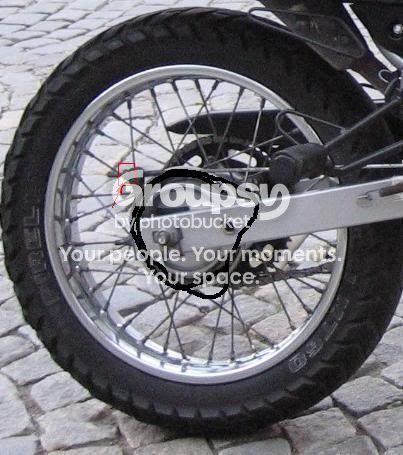

Hi guys, recently removed the back tyre for the first time in order to get a puncture fixed at a shop.
All went quite well, except when I removed the thing from the side of the tyre/bike, on the opposite side of the sprocket.. a little thing fell out as I carried it into the garage with all the other bits.
It's a Honda XR125.
I've circled the main thing I think it fell off as I carried it away from the bike:
https://img143.imageshack.us/img143/6296/wtf2d.jpg
And here's a crude drawing of the part. It's pretty small, a few cm long/wide with a hole through the middle, cylindrical a bit. :
https://img717.imageshack.us/img717/6509/whatisits.jpg
I don't have pics as it's at a friends (closest to me at time of puncture). Going to pick up tyre now shortly so hopefully someone will clue me in before I get sorted and mess this up.

I'm guessing that it is the part that connects the brake actuating lever to the rod from your rear brake pedal.

https://i42.photobucket.com/albums/e312/Dazbo666/Bike%20Bits/wtf2dedit.jpg
There may possibly be a nut that goes on the threaded rod as well

If it's the bit off the brake rod, it's called a brake trunnion.
https://i48.photobucket.com/albums/f216/stinkwheel/drumbrake/Image016.jpg
