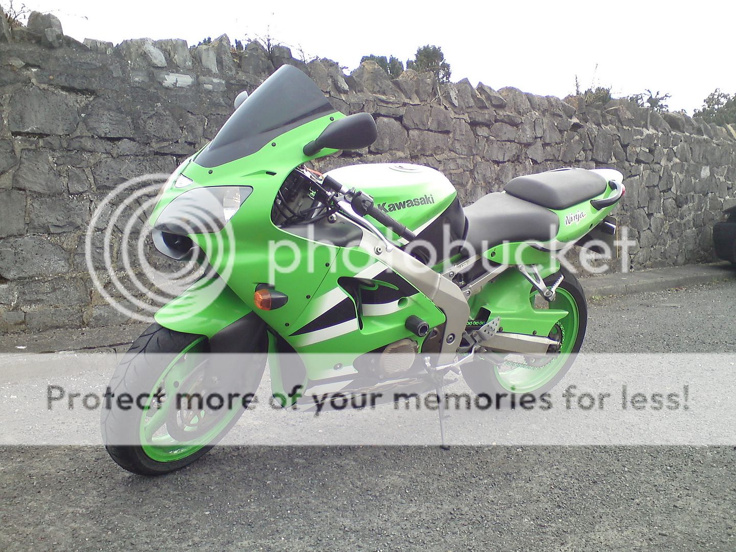

How she was pre-crash
https://i123.photobucket.com/albums/o297/Gfxs/ZX636/DSC00173.jpg

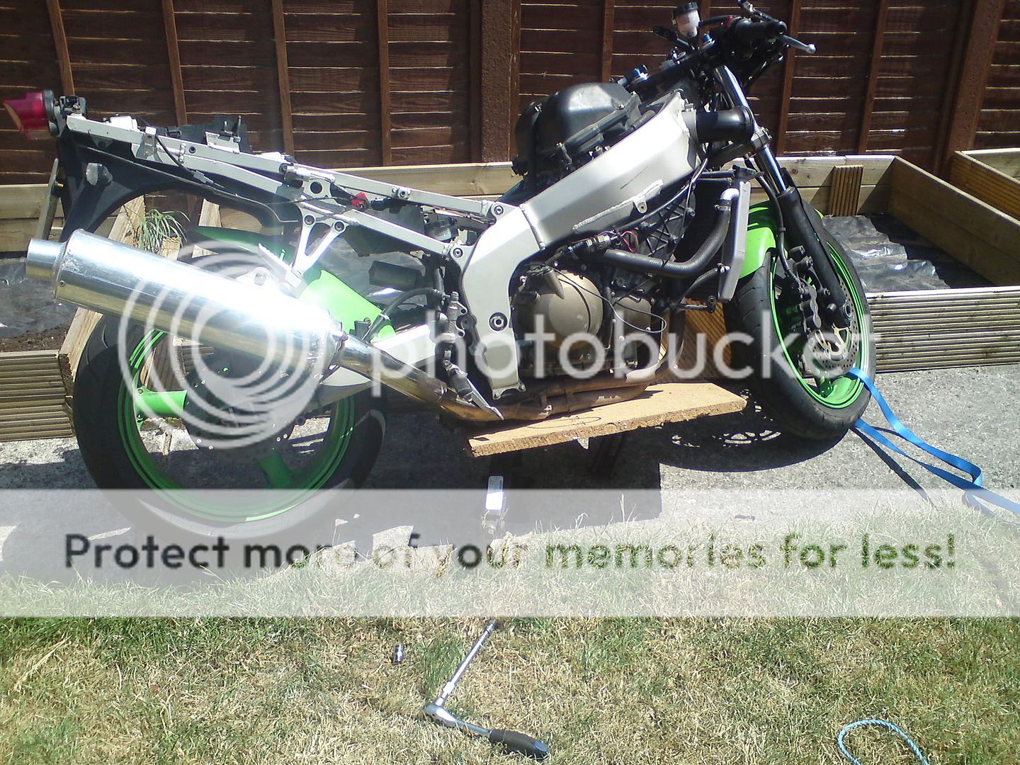

First things first was to strip the bike down so i could inspect the broken parts

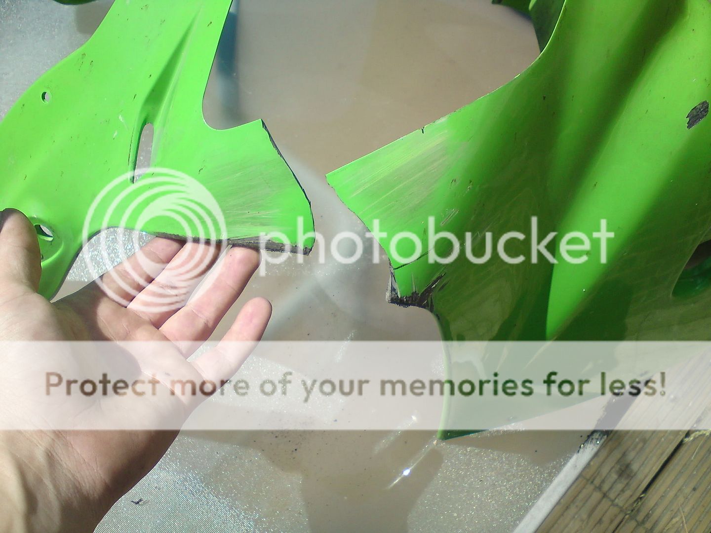

The right side fairings etc all took a big knock
https://i123.photobucket.com/albums/o297/Gfxs/ZX636/DSC00330.jpg
https://i123.photobucket.com/albums/o297/Gfxs/ZX636/DSC00333.jpg

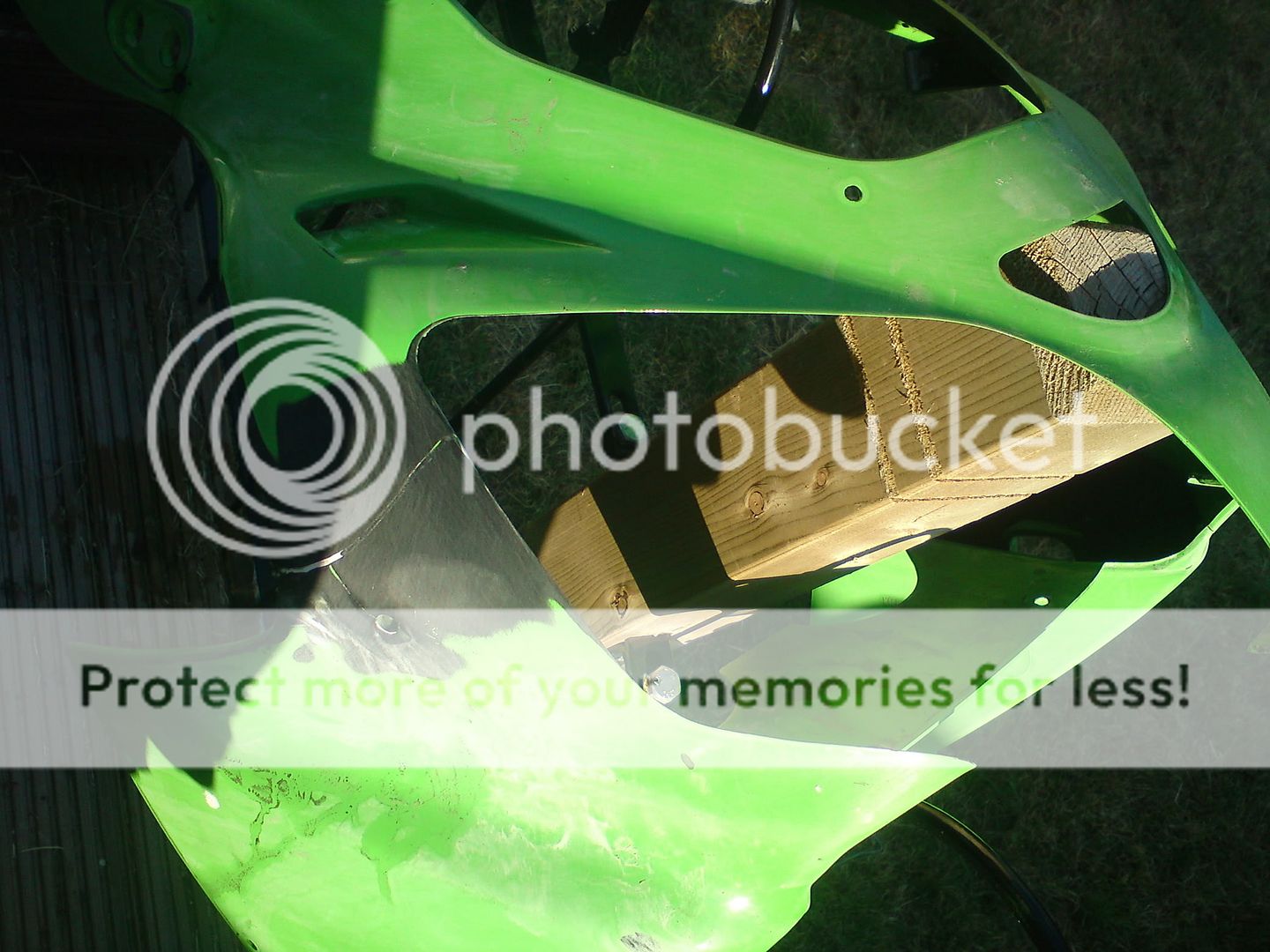

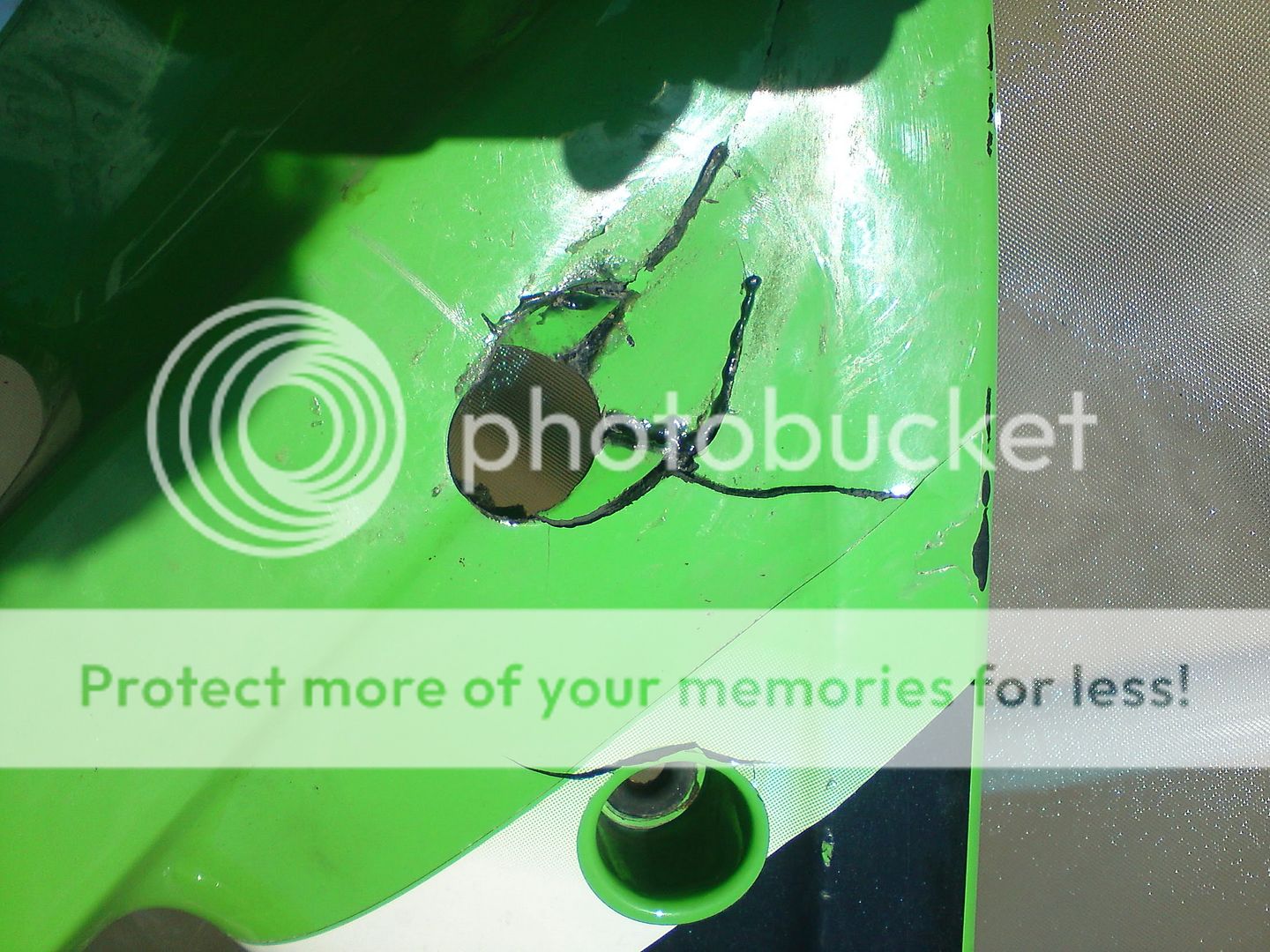

So got to repairing them, out comes the plastic welding rods and mini blow torch
Nosecone welded and fillered needs just the hole filling now

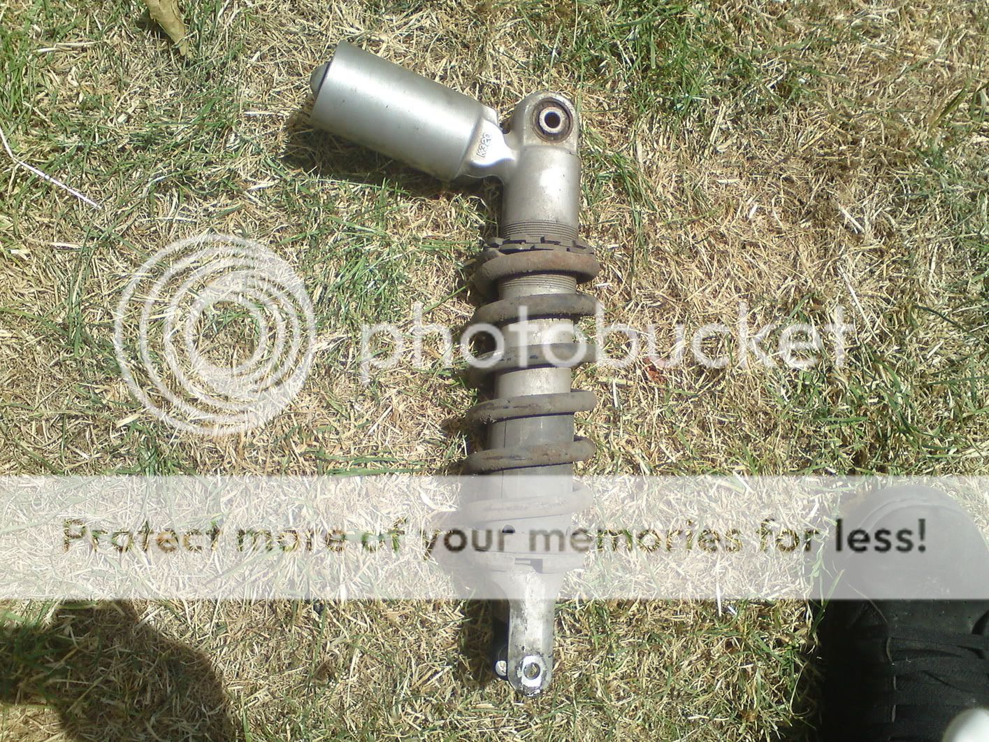

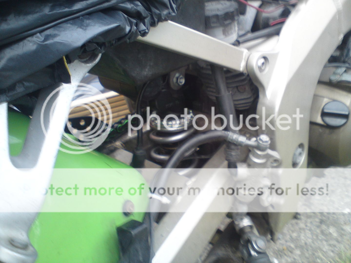

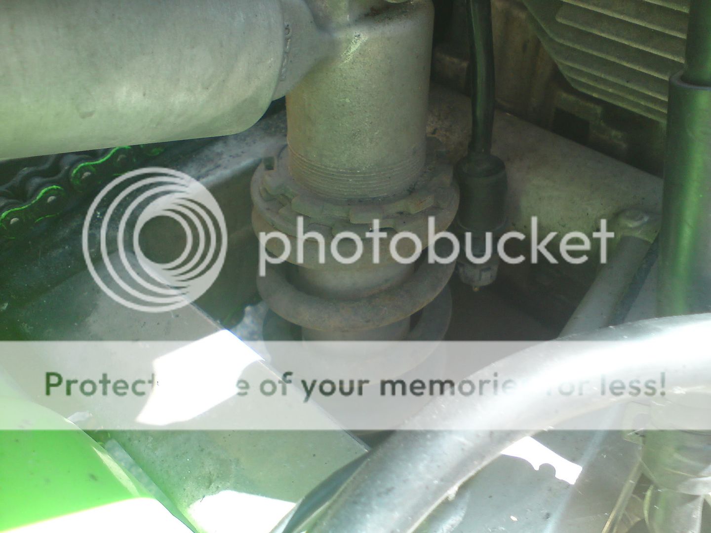

The bike being a 2002 and it still had the original shock felt a bit soggy now and again, so i looked around and sourced a 2008 zx6r shock for 45 posted, i knew it wouldnt be a straight fit but wasnt afraid of slight modifcations to make it fit.
What was in there
https://i123.photobucket.com/albums/o297/Gfxs/ZX636/DSC00353.jpg
Bodged up jack to get rear in air
https://i123.photobucket.com/albums/o297/Gfxs/ZX636/DSC00352.jpg
What came out
https://i123.photobucket.com/albums/o297/Gfxs/ZX636/DSC00354.jpg
The 08 shock wouldnt fit past the bush at the bottom mount of the suspension knuckle so out came the angle grinder and file, and after a hour of tinkering around in it slots
https://i123.photobucket.com/albums/o297/Gfxs/ZX636/DSC00355.jpg
Looks alot better and from just sitting on it feels alot stiffer than the old shock

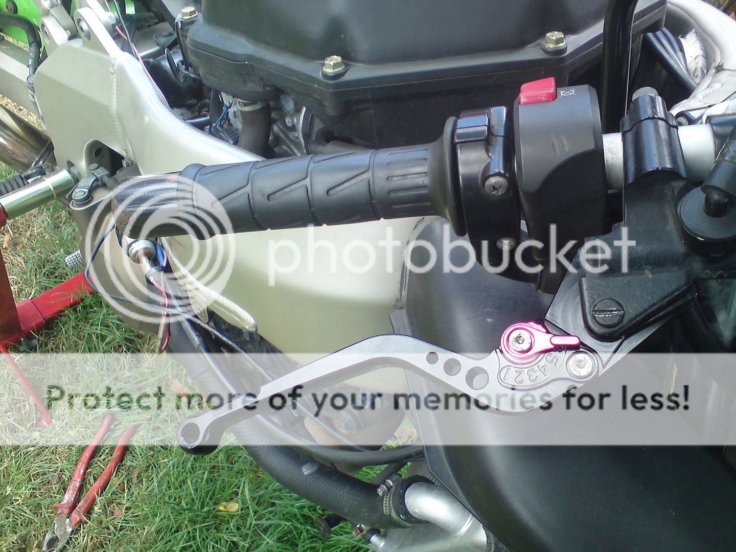

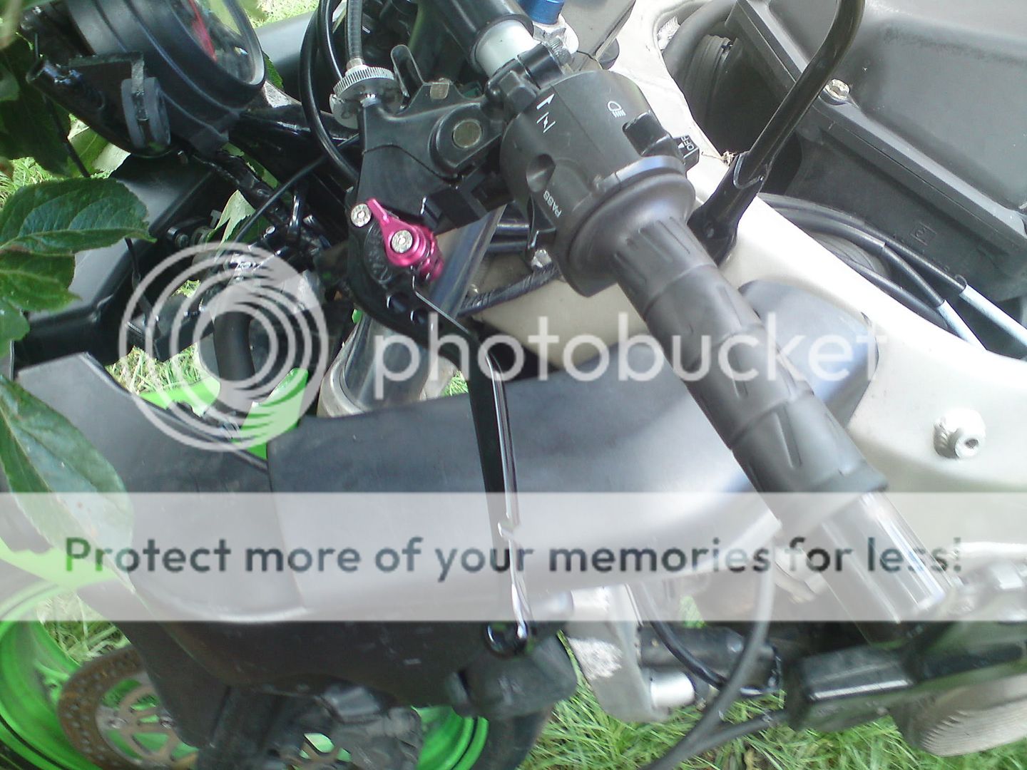

New levers and renthal -1 sprocket fitted up
https://i123.photobucket.com/albums/o297/Gfxs/DSC00387.jpg
https://i123.photobucket.com/albums/o297/Gfxs/DSC00389.jpg
