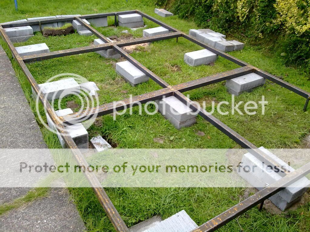

Then came the job of putting all the breeze blocks in place, digging them down and levelling them, this was actually a bit harder than I expected it to be.. Specially when being watched by “The Boss” !!

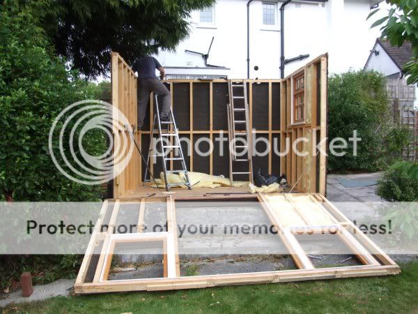

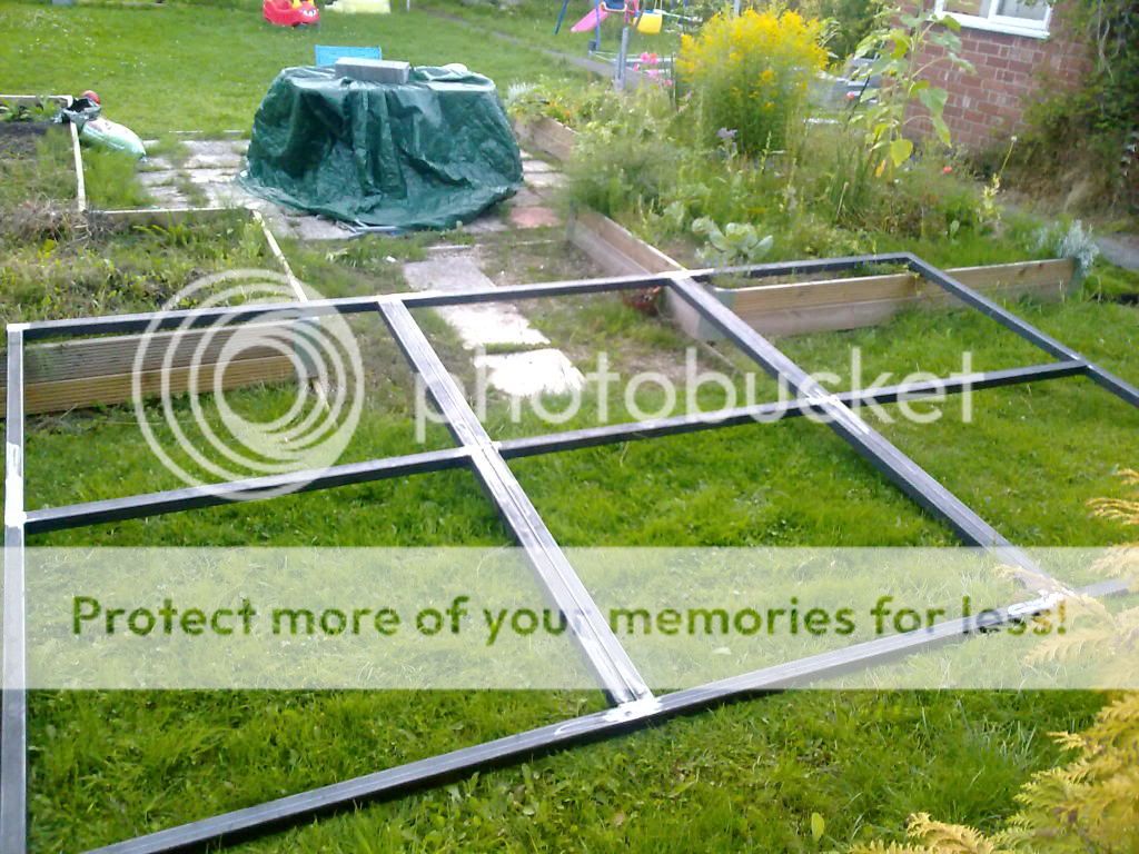

We phoned to see when the shed would be delivered – when on the phone to them, only then did they think it wise to tell me the base comes in 3x equal sections sections, making my previous hard work completely void, I was not amused. The chap on the phone explained that the sections are 14ftx8ft divided equally into 3 (i.e 56”x96” each). Fine I thought, will just make a metal frame (well, dad will make a metal frame), that will sit on top of my blocks, that will support every side of all 3 sections.. sorted.
https://i1016.photobucket.com/albums/af282/Oliver7978/12082010557.jpg
https://i1016.photobucket.com/albums/af282/Oliver7978/16082010583.jpg
So – D-Day comes, the blokes arrive to start putting up the shed, I’m happy my base is exactly as it needs to be, as they’ve told me it should be… what could possibly go wrong??
Well, turns out the joists are actually 18" apart and not 1ft as i was origionally told (not that it matters now with the metal frame anyway) and the base isn’t actually 14ft x 8ft, but 13ft8” x 7ft8” – so the base doesn’t actually sit on all the edges of my frame, and is too small:

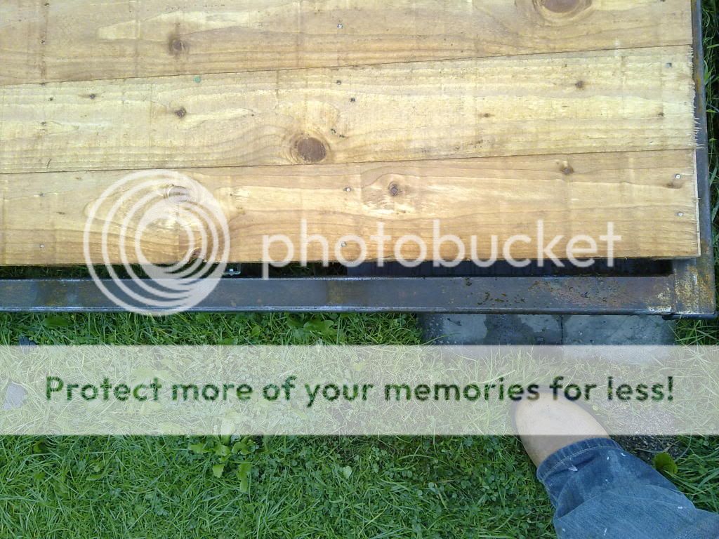

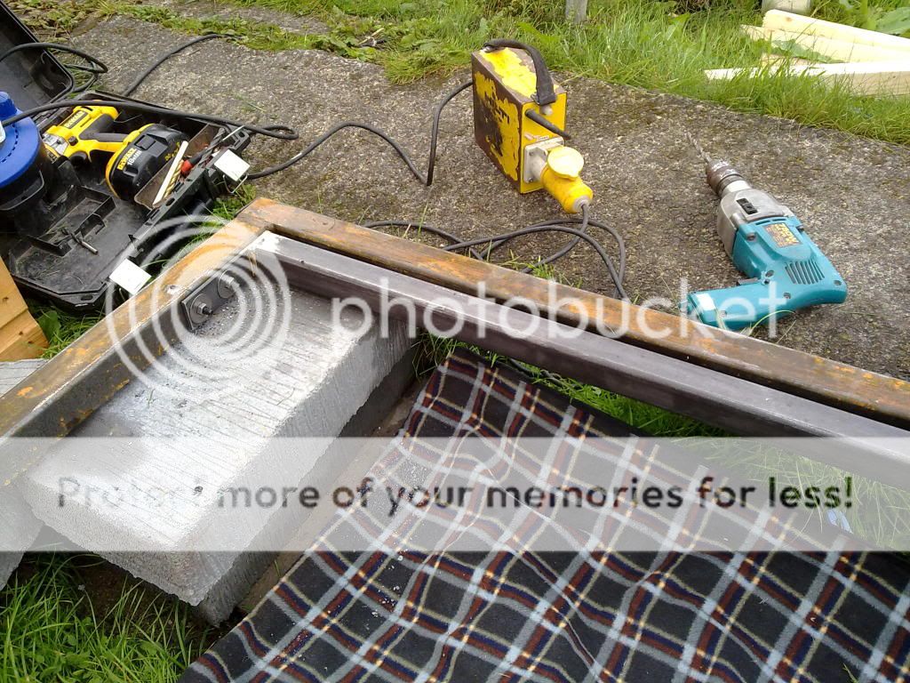

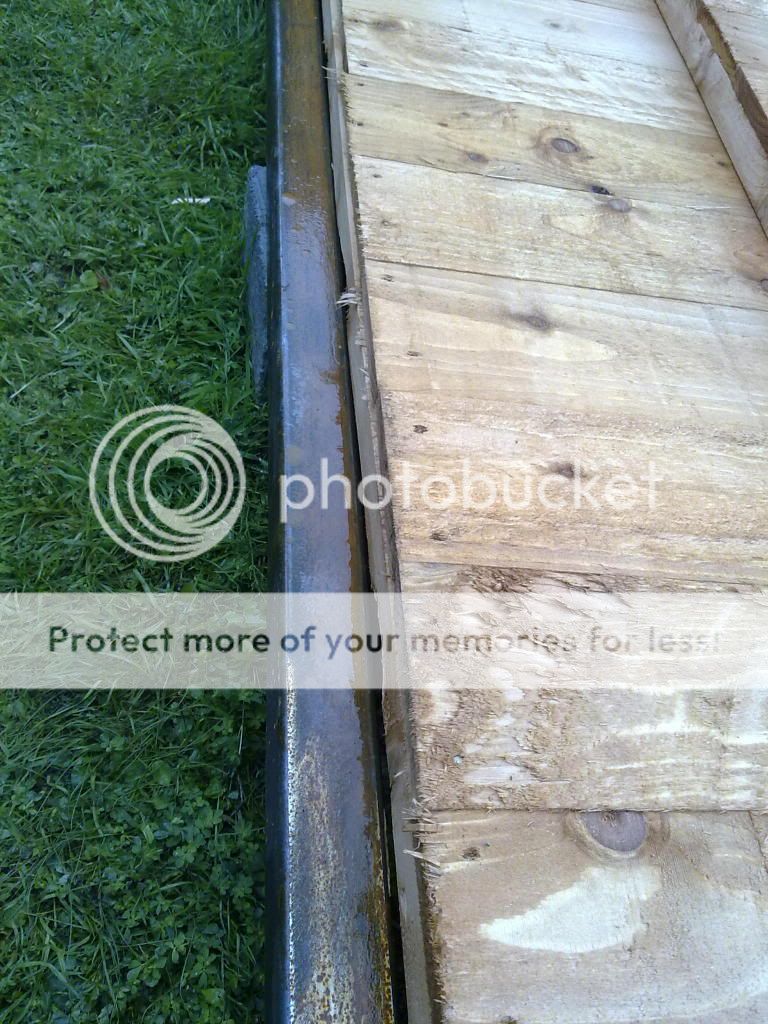

So after a quick phone call to my dad, some magical brackets turned up to sort out all my problems, well, the shed one’s anyway. The plan was to bolt the new brackets onto the inside of the frame to support the edges of the base:
https://i1016.photobucket.com/albums/af282/Oliver7978/21082010591.jpg

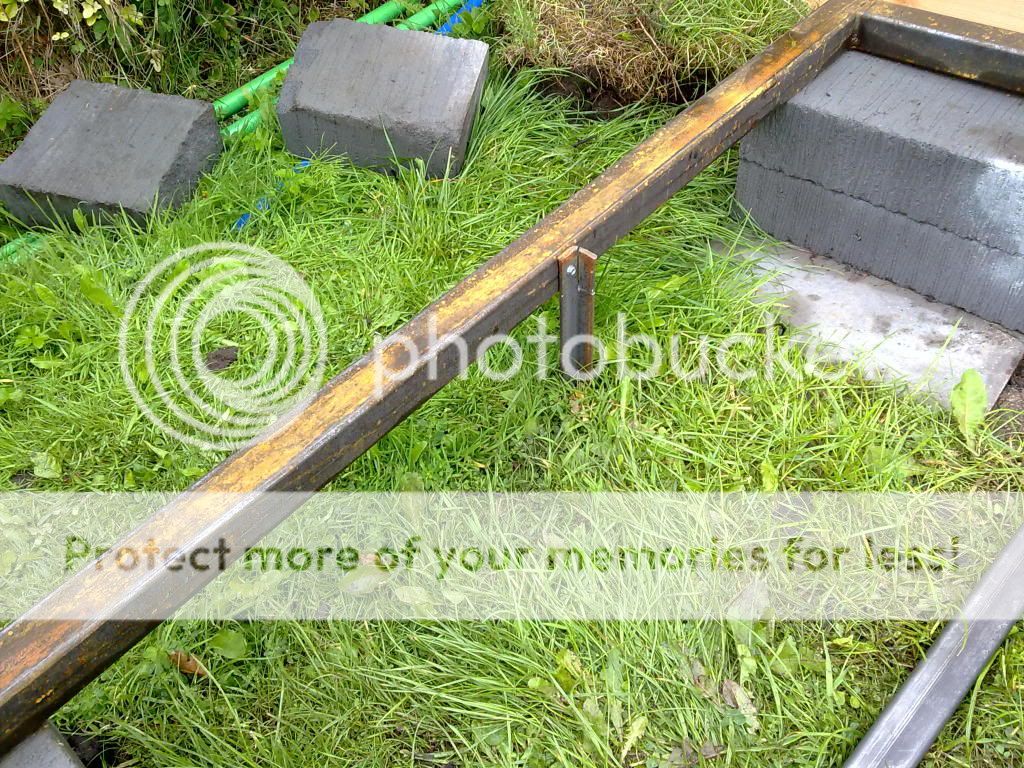

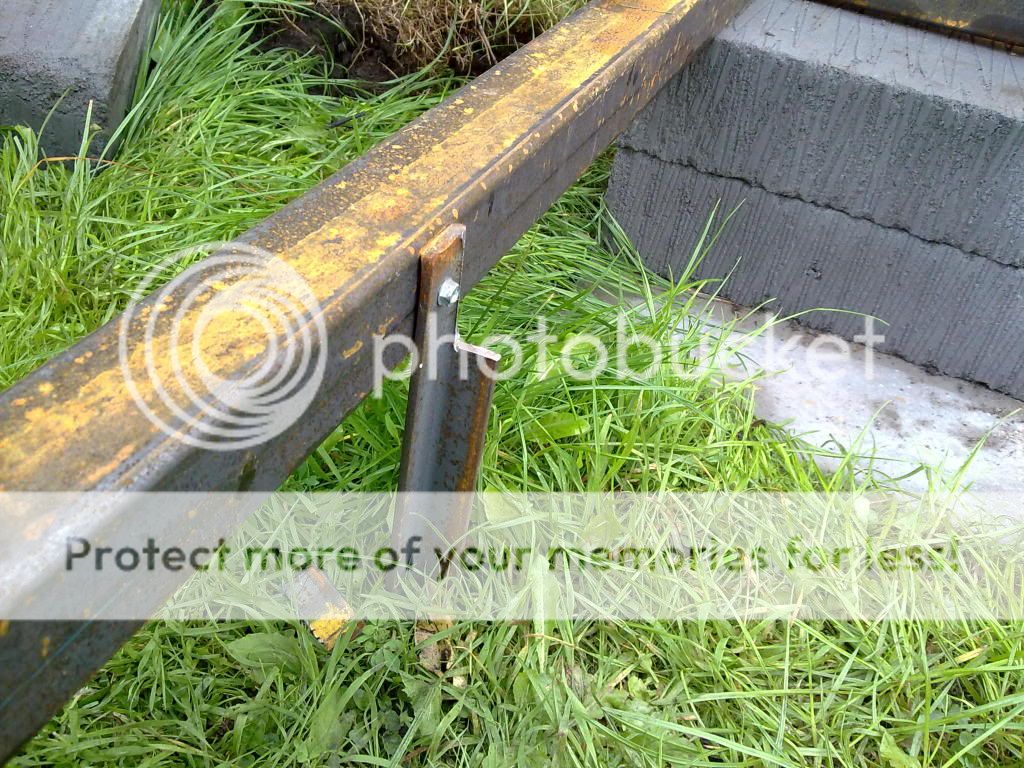

There were a few little problems, I’d hammered some sections of 4ft long angle into the ground and bolted them to the metal frame, just to help keep it in one place, so some of these needed attacking with the grinder:
https://i1016.photobucket.com/albums/af282/Oliver7978/21082010592.jpg
https://i1016.photobucket.com/albums/af282/Oliver7978/21082010593.jpg

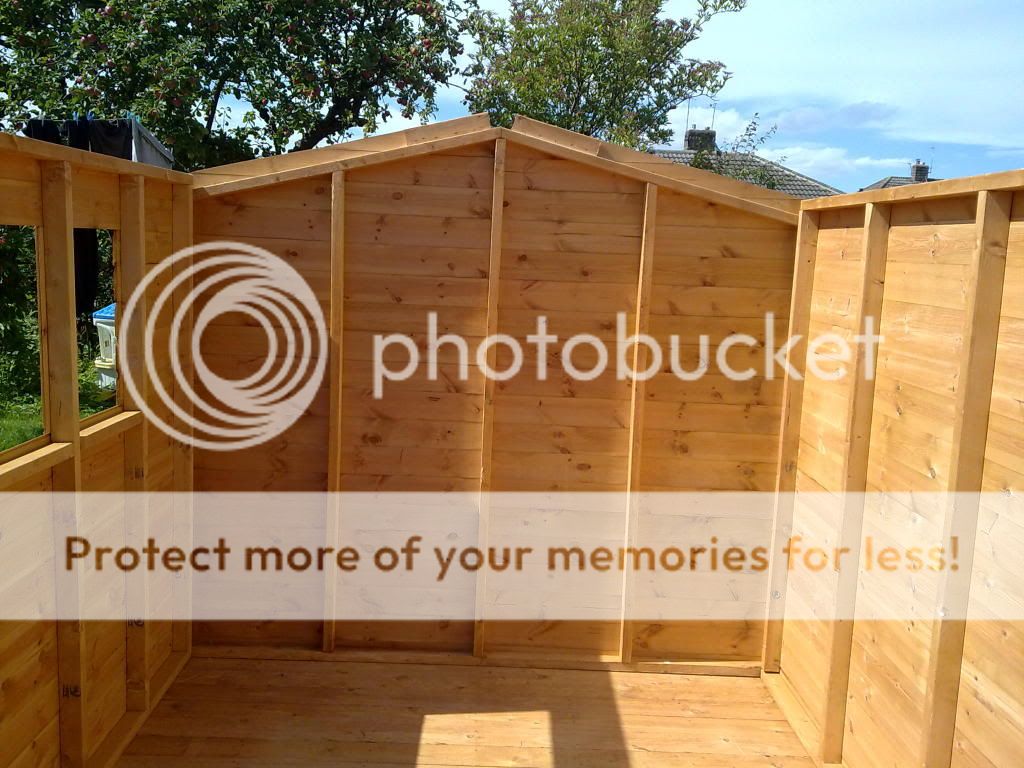

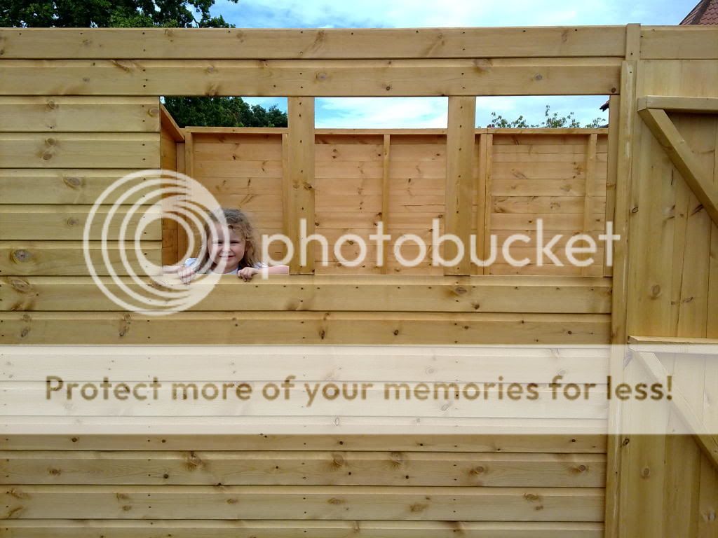

Then once all the new brackets were on, we put the visqueen / damp proof sheet stuff down, plonked the floor on top, then started putting the sides up.. these went up rather quickly and with little fuss:

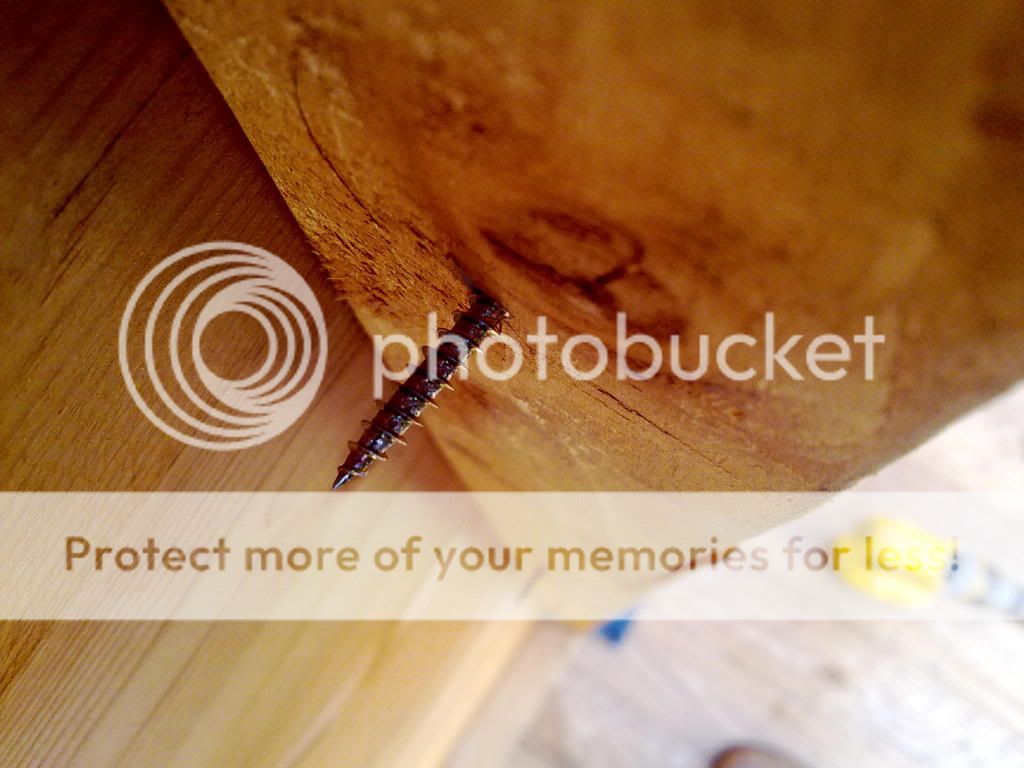

The only problem really was the screws I was using were, in places, a touch too long – but never mind, nothing the grinder cant sort out!

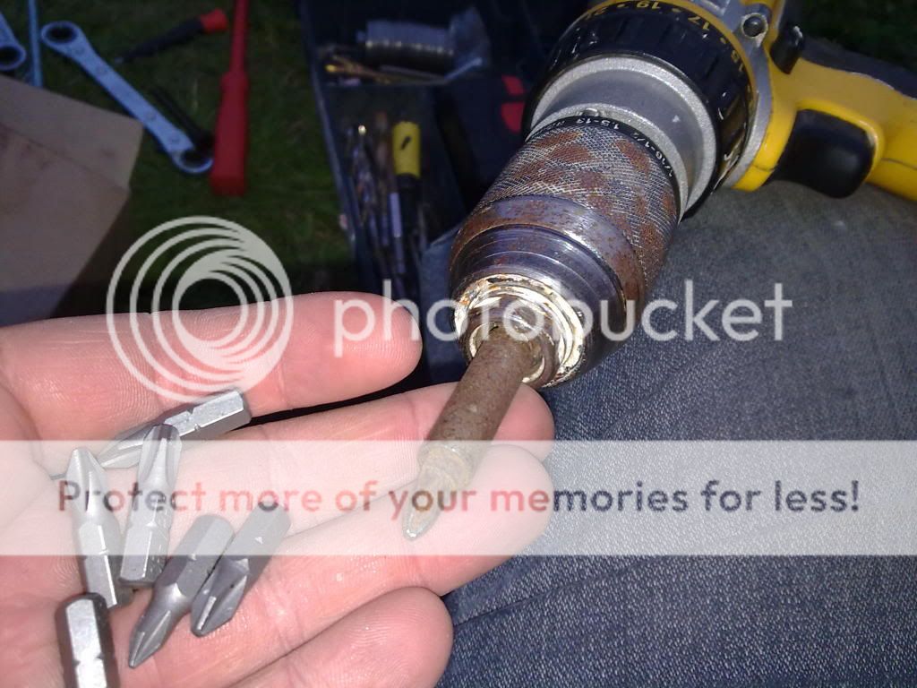

Incidentally – I’ve had the same screwdriver bit + Extension for years and years, and even though I’ve got handfuls of new Philips / dewalt etc screwdriver bits, I still keep using the old one that’s covered in rust – because it works and seems to fit most screws nicely, and I like it !

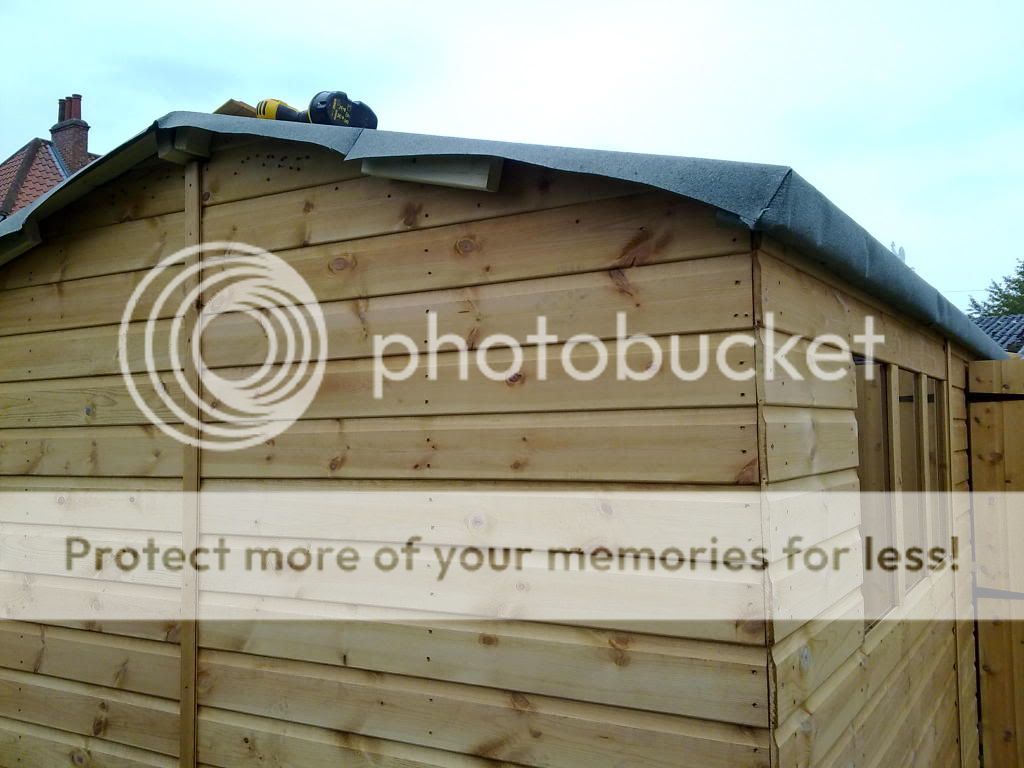

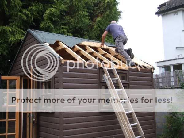

Then the roof went on, again – this was relatively easy, 2x people push one half up from one side, whilst someone on the inside guides it into place… then repeat on the other side, sorted.
Then to felt the roof, I agreed to let my mate climb onto the roof to secure the felt – as I’m such a kind chap! Then i tidied up the corners a bit, need to go over most of the roof with some proper roof tacs as I only used a staple gun!!
