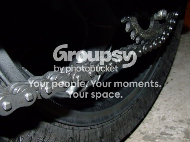

I was off to have a nice day in scarbough today. 70 MPH on A64 then a huge CRACK! Im lucky it didnt hit me or my gf.
Just thought id share my day Crying or Very sad

nasty, how old was that chain ?

Name and shame the chain....But in that photo it looked very dry.

Aye we are very lucky. Had chain about a year. Was lubed very recentaly too.

look at the state of the chain! I am fairly certain that if this chain was cleaned and lubed as often as it should be this wouldn't of happened.

That is a very manky chain. I clean mine once a week and lube it twice a week.
Once you've initially cleaned it up, it takes all of 5 minutes to clean and lube the chain with a paraffin soaked rag and a toothbrush dipped in oil.
And £200 recovery charge? Why haven't you got break down cover?
You say the chain was a year old, but how many miles had it done?

chains proably done close to 7,000 miles, i admit i had negleted the chain at the start of this year. Since then ive lubed it often, bout every 2 weeks with chain spray wax. Shame its come to this Sad

Its completely filthy though Confused

The pic of the chain i put on is the side which faces the wheel, From the side which can be viewed it doesnt look too bad.
Recently i noticed tight spots, i adjusted it too suit. Ive learnt my lesson. If i get tight spots in my chain and have problems ajusting it (which i did, took me ages) then just buy a new chain. This weekend its cost me nearli £400 for the recovary and all the parts to fix the bike.
So anyone out there who feels they need to change, DO IT! As your bike cud end up like mine Sad
Just because you can't see it, doesn't mean it doesn't need cleaning Wink The wheel side of my chain is just as clean as the outside.
