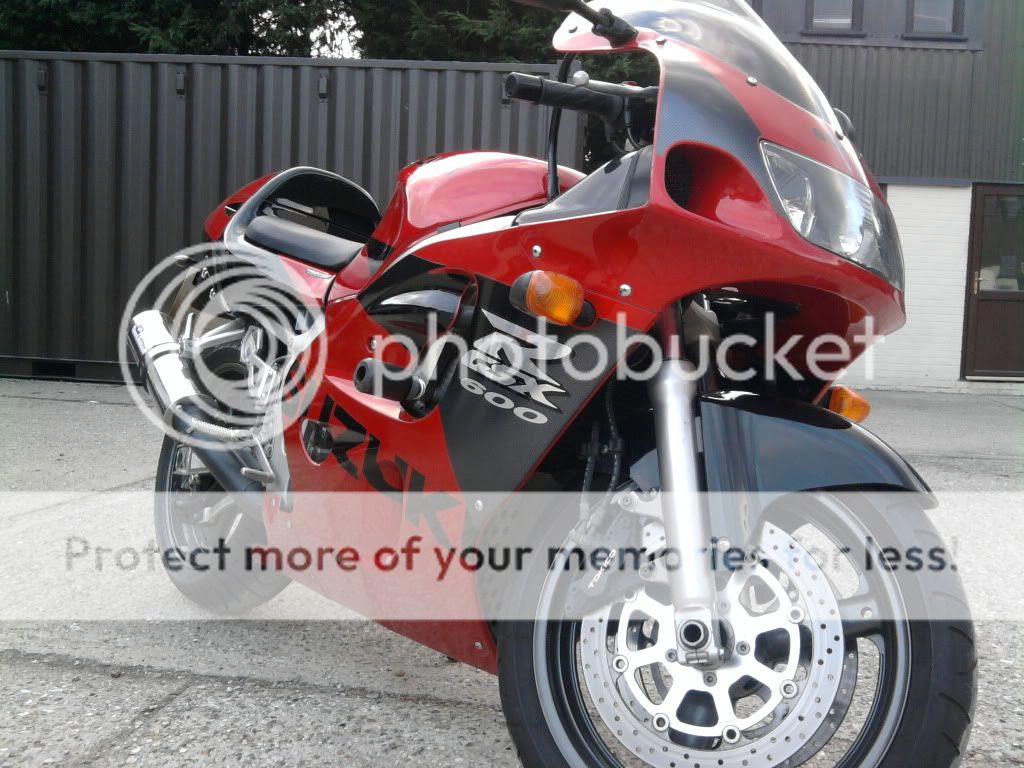

Redoko
Joined: 04 Nov 2009
PostPosted: 12:48 - 04 Sep 2010    Post subject: Reply with quote
Not bad at all, enjoy her. Thumbs Up
Welcome to the SRAD group. Smile
https://i1003.photobucket.com/albums/af159/Redoko1992/Photo0137.jpg
