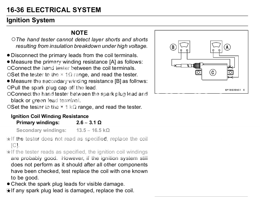

The coils are on the other end of the spark plug caps. Below is the bit in the workshop manual showing how to test the ignition coils.

A workshop manual is a worthwhile investment. The bit I've put below is from a KLE500 manual which uses many of the same parts as your bike.
Have a bit of thick cardboard ready to put the tank down on.
Right click and view image to see full size.
https://i48.photobucket.com/albums/f216/stinkwheel/coiltest.png
