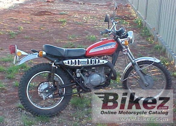

and the frame looks like.... a ts250 from around 74
https://www.bikez.com/pictures/suzuki/1974/9580_0_1_4_ts%20250_Image%20credits%20-%20Matthew%20J.%20Morling.jpg

Hard to tell from the pics but it looks to be quite a small bike so could be a TS125. What are the wheel sizes?
I had a TS250 like that one back in the day but a '76 model - fun bike.

Frame loop is much taller and narrower on the SP to accomodate the big 4-stroke single. Shocks are more inclined. Tank & Mudguards all a lot different, as well as the forks and hubs.
Didn't 'quite' look like the TS250, so wondered whether it may be TS125/185.
https://www.motorcyclespecs.co.za/Gallery%20%20A/Suzuki%20TS%20185%2071.jpg
https://www.suzukicycles.org/photos/suzuki-history/1971/1971_TS125_450.jpg
Those are earlier mid-70's TS's, later ones had more inclined shocks and angular MX body-work.
Looking at them, they have twin diagonal frame rails coming down from the cylinder head area towards the swing-arm pivot, where the 'mystery-bike' and the TS250 seem to have a single back-bone coming down the middle.
Looks like a TS250 chassis then.
And I WONDER whether the engine might actually be 125?
Back in the early '80's old 250's were almost worthless, and one with a dead engine absolutely so. A CZ125 was pretty un-valuable also, and could be written off as beyond ecconomic repair come MOT time for something as daft as a duff regulator.... Slotting a working CZ125 motor into an old 250 Chassis, would have made a cheap learner legal.... Or it could have just been a low rent field bike excersize.
BUT looks like an early TS250 frame & cycle-parts, rather than a 125 or 185, and from the frame shape, probably pre-77.
