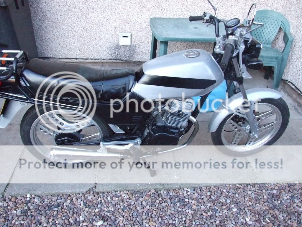

I bought it back in May for the grand sum of £200, taxed & tested, but dead! It had a siezed engine, and gawd alone knows how it got its MOT cert, as the forks seals were shot and the head-race bearings notchy, and the back suspension was sloppy AND siezed!
https://i178.photobucket.com/albums/w269/teflons-torque/Little%20Dreams/pi6f8a01.jpg
This had been procured a few weeks before, for £300, and was a runner, except when we started to try and tidy it up, the list of faults grew rapidly, and the faulty carburettor causing it to run a 'bit rough' became the least of our worries when I discovered some-one had removed chunks of the frame with an angle grinder, and drilled holes in other bits of it! So it became a 'donor' for the other bikes, and offered up its engine for the one above.
Anyway, over Easter, I had swapped the motors over and made sure that it ran, and with the red bikes carbs and exhaust, but didn't actually ride it. After checking the viability of the motor swap, I started stripping it down and renovating it.

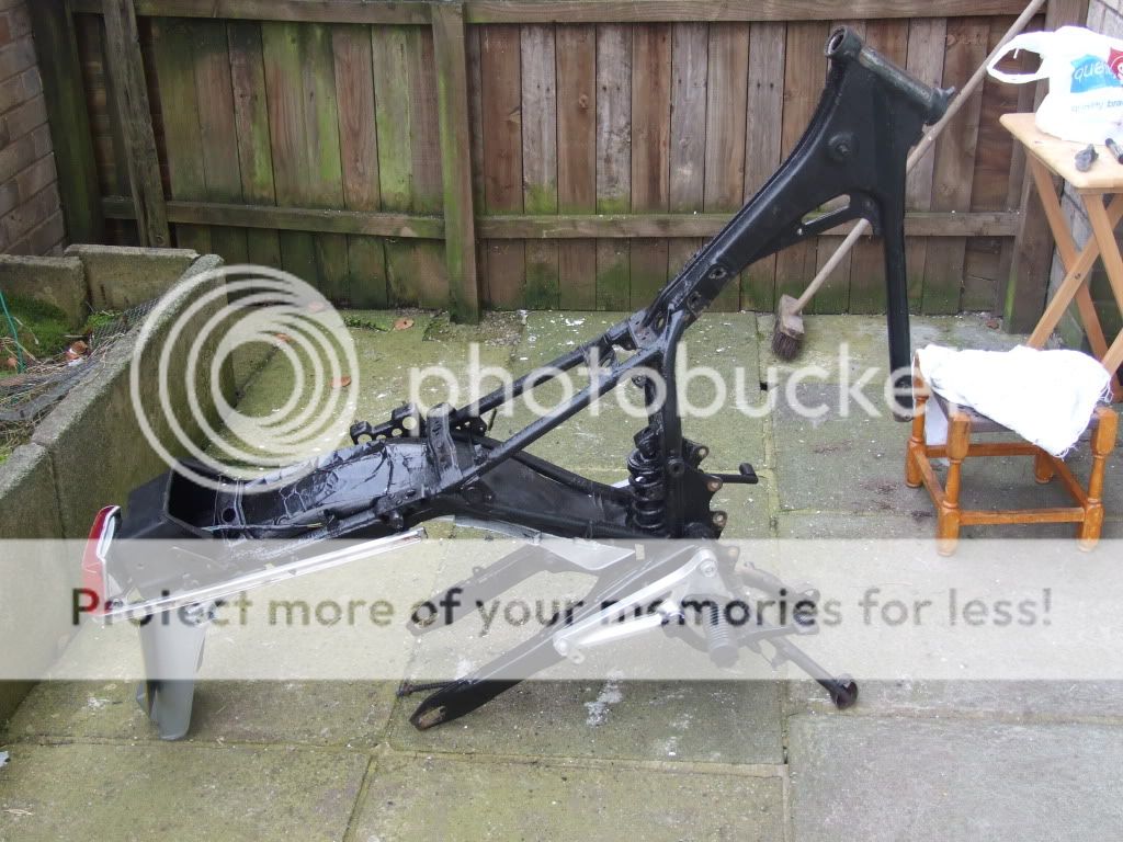

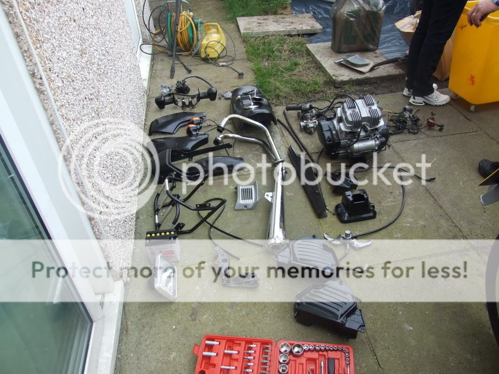

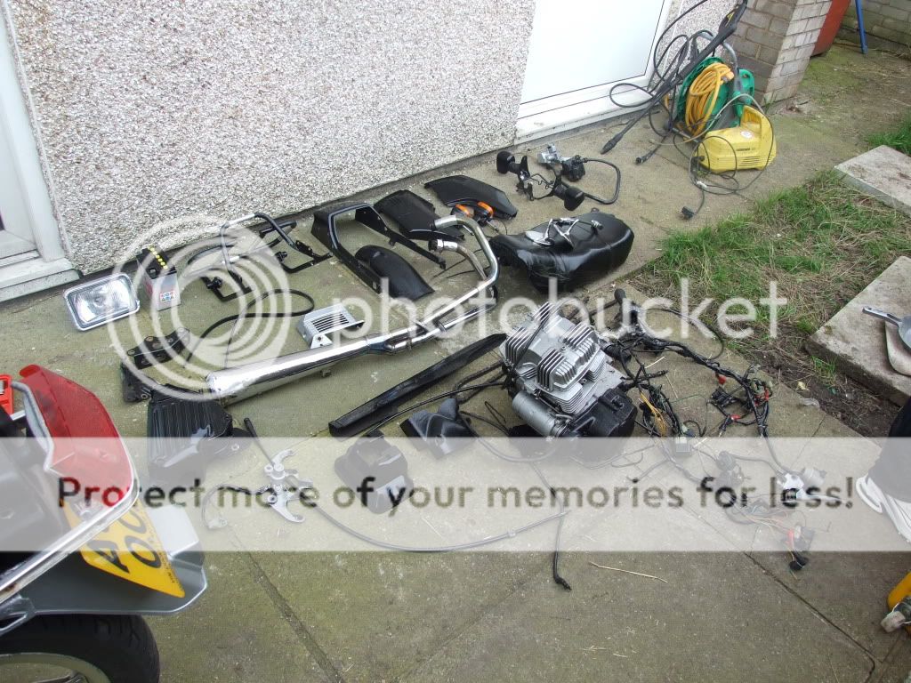

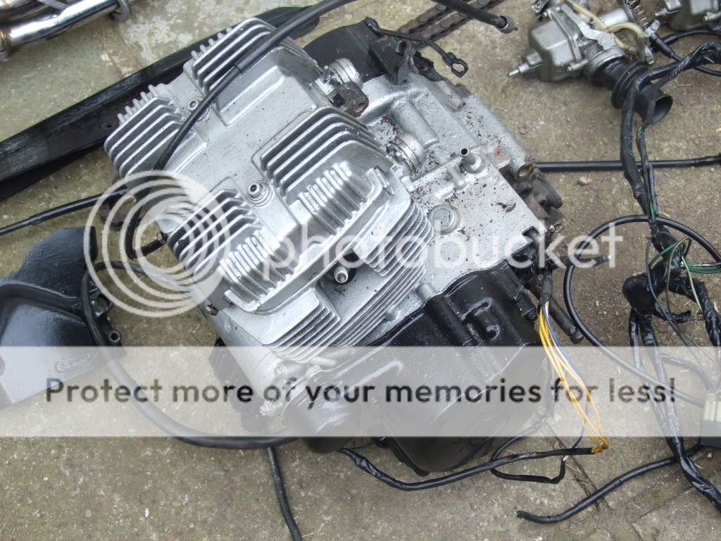

https://img.photobucket.com/albums/v106/sfpeddler/jens%20bike/1ee484f5.jpg
Bought like this and looks 10000000 time better in the pic lol, the guy mustve had share's in hammerite/underseal and pvc tape as thats all it was made out of.
Had it 2 days then it and thought i better have a look at it, by the end of the day it looked like this
https://img.photobucket.com/albums/v106/sfpeddler/jens%20bike/0d264eba.jpg
https://img.photobucket.com/albums/v106/sfpeddler/jens%20bike/9b15e700.jpg
https://img.photobucket.com/albums/v106/sfpeddler/jens%20bike/55c3b7f0.jpg
https://img.photobucket.com/albums/v106/sfpeddler/jens%20bike/8320e3a8.jpg
Frame went total strip down and back to bare metal before new swingarm was sourced.
Has had new bearings and seals etc etc and is now in filler/primer ready to be resprayed (no pics atm) its in a basic rolling chasis state atm, but as always is on the back burner atm whilst I get my new garage/shed build
