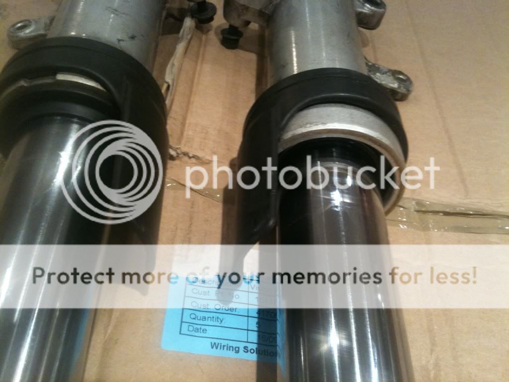

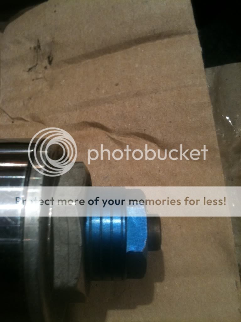

only annoying thing is they have a seal missing which I guess I can salvage from my old forks
https://i878.photobucket.com/albums/ab349/slyrob/a487b5ef.jpg

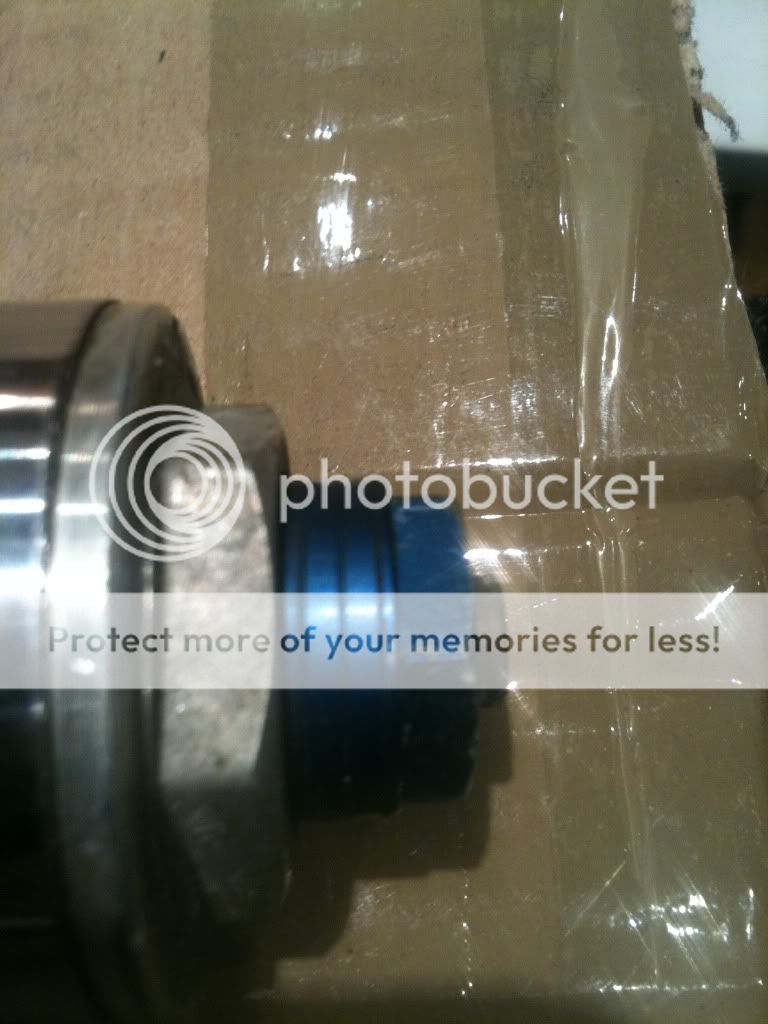

and there is a big difference in the adjustment of the two forks is this normal???

In terms of adjustment, set them to default... or say if its 12 notches to go from soft to hard, do all at lowest and work from there...that way YOU know its perfect and even.

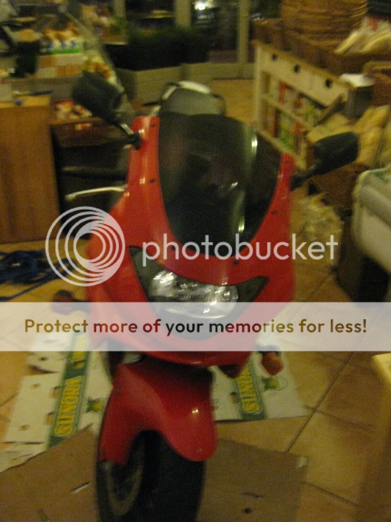

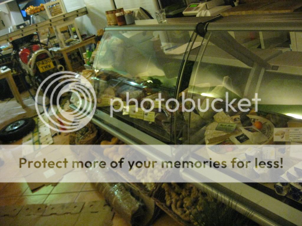

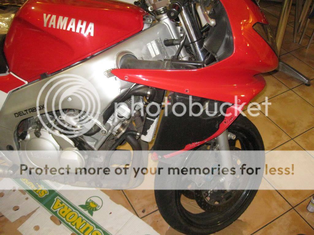

well folks that was an interesting night/morning. first of all welcome to my new garage!
https://i878.photobucket.com/albums/ab349/slyrob/IMG_1693.jpg
First job was dragging the damn bike to my shop with a locked front wheel and clearing a bit of floor space to work in. Then I set about removing the front fairings to find some where to hoist the bike from. Luckily this was a fairly quick process as the previous owner had failed to replace more than half the fasteners in any location that wasn't visible! I took photos while I worked and used different plastic pots for different areas of the bike when I removed fasteners and other bits so that they would go back quicker

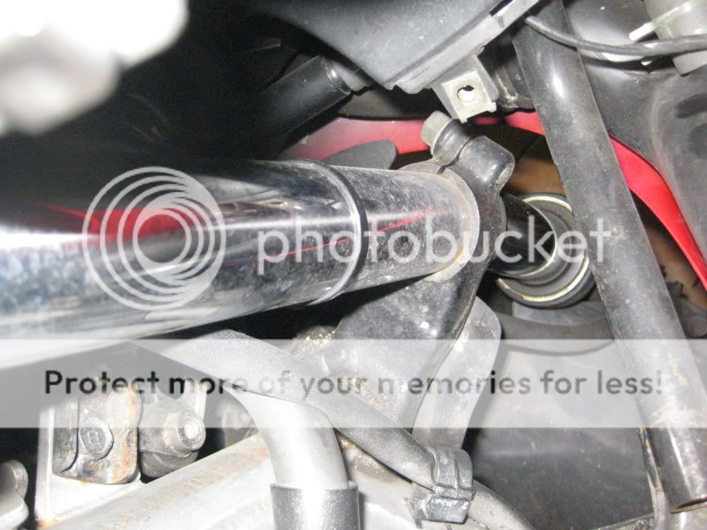

heres a quick look down the fork from above
https://i878.photobucket.com/albums/ab349/slyrob/IMG_1677.jpg
once I had the fairings off i noticed this
https://i878.photobucket.com/albums/ab349/slyrob/IMG_1681.jpg
this
https://i878.photobucket.com/albums/ab349/slyrob/IMG_1684.jpg
and this
https://i878.photobucket.com/albums/ab349/slyrob/IMG_1688.jpg
....................................balls

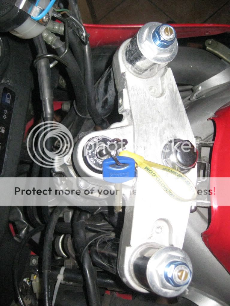

because i'm lazy I didn't take off the nose cone which made getting to the bottom yoke bolts a bit of a bastard but eventually i got a ratchet on them. The top yoke is easy to loosen but as I found out last night this doesn't matter too much when the forks are bent. The right fork came out with a bit of WD40, violent twisting and a lot of swearing, the left fork however decided that things had been far to easy for me and that now was the time to get involved. After an hour or so of trying to loosen it I resorted to a big hammer, even with the hammer it was another half hour before it dropped out. I'm sure at some point today I will have to deal with the consequences of hammering stuff at 3am but it was worth it.
Nowt wrong with them forks, it'll polish out!
https://i878.photobucket.com/albums/ab349/slyrob/IMG_1695.jpg
https://i878.photobucket.com/albums/ab349/slyrob/IMG_1694.jpg
once the forks were out I set about cleaning the replacements and swapped a dust seal from the old ones to replace the missing one on the new forks.
It was immediately apparent when offering up the left fork that the bottom yoke was no longer straight so I used a socket the same radius as the yoke hole with a tyre iron bar attached placed it inside the yoke and lovingly forced it back in line 1mm at a time. I'm not suggesting this is a sensible way to straighten yokes but it was all I had available!
After an hours work the new forks finally slid into place Shocked and I had a beer and a smoke to celebrate Smile
I replaced the back of the front mudguard first then the wheel then the callipers then the mudguard. Then using the photos I took before the strip down as a guide a adjusted the height of the forks before tightening the yokes and replacing the clip ons.
NOTE: photos taken before are very helpful when re routing cables and brake lines around the forks to avoid pinching or pulling when steering.
Then came the exciting part of trying to release the ratchets bit by bit to avoid dropping the bike on the floor, I suggest having help when doing all this but amazingly I couldn't find anyone to spend their Friday night in a shop with me!
Once the bike was safely down I replaced the broken foot peg and replaced the fairings.
Some time around 5.30 or 6 this morning I finished and cleared up ready for business.
So, looks like I need a clutch cover, front wheel, discs and pads before I can ride again but at least it is rolling Thumbs Up

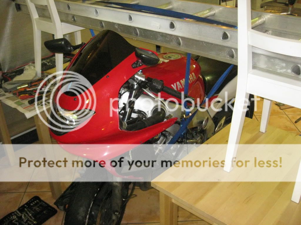

slyrob
Joined: 03 Jan 2010
PostPosted: 16:49 - 27 Nov 2010    Post subject: Reply with quote
just like it never happened Thumbs Up
https://i878.photobucket.com/albums/ab349/slyrob/9f73de95.jpg
Pitslayer wrote "it could be Ndubz.....ruining this once great place with donkey gobbling loafer knobbing "music".
silky666 wrote "In my eyes, when you shake cocks with the devil, you may as well go for the full reach around"
Villers wrote "as reliable as a ginger stepchild on smack"
Tim..
Joined: 11 Oct 2006
PostPosted: 16:52 - 27 Nov 2010    Post subject: Reply with quote
Love the improvisation Thumbs Up . Wouldn't have trusted the chairs myself but fair play for getting it all done.
www.marshallracing.co.uk
slyrob
Joined: 03 Jan 2010
PostPosted: 17:00 - 27 Nov 2010    Post subject: Reply with quote
wasn't sure about them myself but I figured the bike weighs 220/230 kg, split between two chairs with weight distributed on the back wheel, I weigh 100 kg so if I can jump on them and they don't break then it should be all right. I also tried to make sure the weight was pulling straight downwards and found the set up surprisingly stable..........even when hammering the crap out of it Thumbs Up there was no slippage of chair at all, in fact i found that I could move them a millimetre once under load
