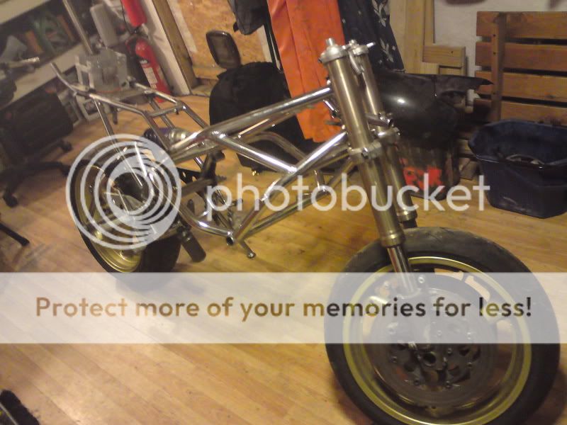

Well thought id share a few pictures of my dads Moto Martin project.
History: He got it about 11/12 years ago after swapping it for his gsx1000 katana. It was in abit of a state then and was put off the road in 99. It sat up until about 6 months ago when he decided to rebuild it. He decided to change the standard wheels and front end for more modern gear.
Trying to find a front end with enough offset was an issue to clear the frame. But settled on a zx9r front end which just gives enough clearance. The wheels are a mix of Bandit 1200 back and zx9r up front.

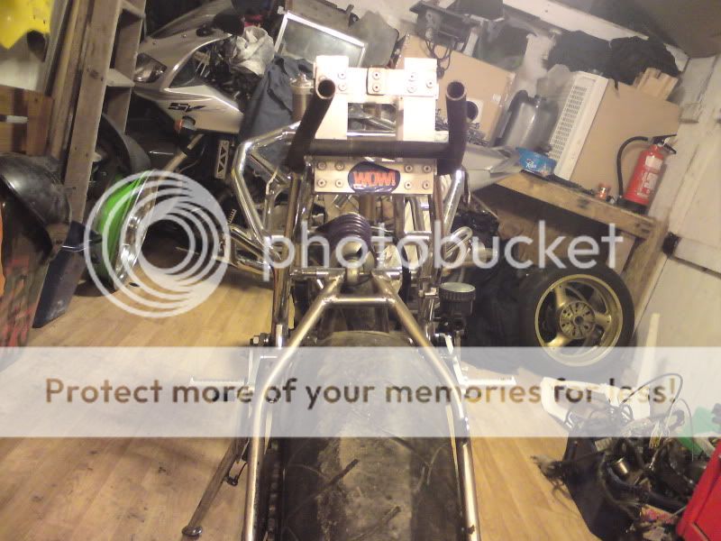

The swingarm needed to be widened to accomadate the 180 tyre over the standard 150.
Heres a pic of the widening
https://i128.photobucket.com/albums/p183/babykat250/Moto%20Martin/DSC00082.jpg.
https://i128.photobucket.com/albums/p183/babykat250/Moto%20Martin/DSC00083.jpg
https://i128.photobucket.com/albums/p183/babykat250/Moto%20Martin/DSC00081.jpg
https://i128.photobucket.com/albums/p183/babykat250/Moto%20Martin/DSC00080.jpg
It was running a standard gs1000 motor before. It will be running an early GSX1100 motor with a 1170 wiseco big bore.

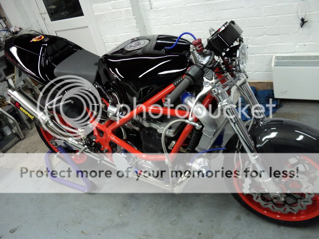

i'm just gonna put this here Laughing
https://i825.photobucket.com/albums/zz174/magpie79/DSC00051.jpg
kat250
Joined: 22 Feb 2005
PostPosted: 09:32 - 17 Feb 2011    Post subject: Reply with quote
Looks a tad shorter and appears to has had a lot of frame work Wink or it may even be a oilboiler frame Smile

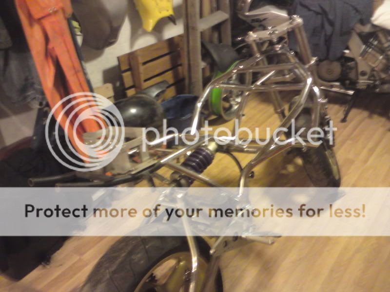

PostPosted: 11:11 - 17 Feb 2011    Post subject: Reply with quote
Something doesn't look strait is it the sub-frame..?
I've all ways liked the French chassis when I saw a CBX motor in one, nice..
If you don't pay your exorcist you can get repossessed.
If you have to rev it! Don't Buy it!
kat250
Joined: 22 Feb 2005
PostPosted: 11:27 - 17 Feb 2011    Post subject: Reply with quote
To be fair it prob doesnt help at the angles im at the wheel not sat in place correctly(no spacers yet) and the back of the sub frame just there to hold on the tail unit but still probably isnt straight Laughing

PostPosted: 09:06 - 18 Feb 2011    Post subject: Reply with quote
I notice afterwards that the shock loosely fitted and it was probably a mock up shot.
