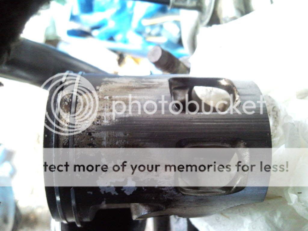

It wasn't like a locked up and wouldn't turn over siezed, more like ran like shit and made scary noises as you say.
Could be a dodgy rebore, or a dodgy piston. Have you got a picture of the piston?
I was thinking it could be a dodgy rebore. It was on a .75 oversize when I bought it so its nipped up three times in 16,000 miles!
https://i979.photobucket.com/albums/ae271/RxsOllie/SNC00075.jpg
Thats the only picture i've got. It did that in about 70 miles.

PostPosted: 09:40 - 04 Nov 2010    Post subject: Reply with quote
I would say the bore was under done. I've seen it happen on other bikes. Often happens where a barrel is honed instead of actually rebored, meaning people put a bigger piston into too-small bore - leading to the kind of carnage you have.
Having said that, if it was on .75 at a mileage when the original bore should just be nicely bedded in, that would suggest something else. RXS bores/pistons normally go to at least 40K even when relentlessly and mercilessly thrashed.
I'm wondering if there's crap in the oil tank, causing an intermittent blockage. Oil pumps rarely fail, certainly not after such a low mileage.
PostPosted: 11:41 - 04 Nov 2010    Post subject: Reply with quote
To add an extra thought into the mix, not sure Yamaha sell .75 o/s pistons and a fair chance it is a cheap pattern piston. Some pattern pistons are pretty useless and prone to seizing.

PostPosted: 19:34 - 04 Nov 2010    Post subject: Reply with quote
Tef here (Snowies been at my lappy again!)
Those skirt appatures looked suspiciousely dremmelled to me, so checked e-bay for pics of new pistons.
https://i.ebayimg.com/13/!B))K,IQB2k~$(KGrHqR,!iQEw5yWTwYrBMO5DdEM!!~~_12.JPG
[img]https://i.ebayimg.com/07/!B7Rs(K!!Wk~$(
KGrHqN,!k0Ey+jC1sigBMzvJSioig~~_12.JPG[/img]
I cant be sure but does look like some-one may have tried opening them up. Poss bad DIY porting job?
Quoted oversizes were +50 & +100 too, as Keith said

You can get .25 for the RXS for sure, pretty sure .75 is also quoted in a parts list I have from Mitsui too.
A poor porting job is certainly a possibility. Why do people do it? It always ends in tears.

This is the piston I bought (crappy pattern one)
https://www.wemoto.com/bikes/Yamaha/RXS_100/83-85/picture/Piston_Kit_0.75_Oversize/
I havn't touched it, thats how it came.
I snapped a ring so had to use an old one but that wouldn't have made any difference.
I checked everything again tonight. The oil tank is squeeky clean. When you take the bleed screw out of the oil pump it flows out fine. Also all the marks on the pulley line up as they should.
That fact that it was smoking before tells me the pump must be alright.
What else could have caused it?

There's very little difference between one of those pistons and the ones that come in a Yam box. Shouldn't make any difference at all.

Well scoring & nip means that the piston has got too big for the bore, doesn't it?
So its either bore to piston tolerences weren't right, OR, its got too hot, whichmeans, mixture or ignition.
Given the possibilities & unknowns, going pre-mix, is unlikely to help. Thats just another variable to start messing with.
