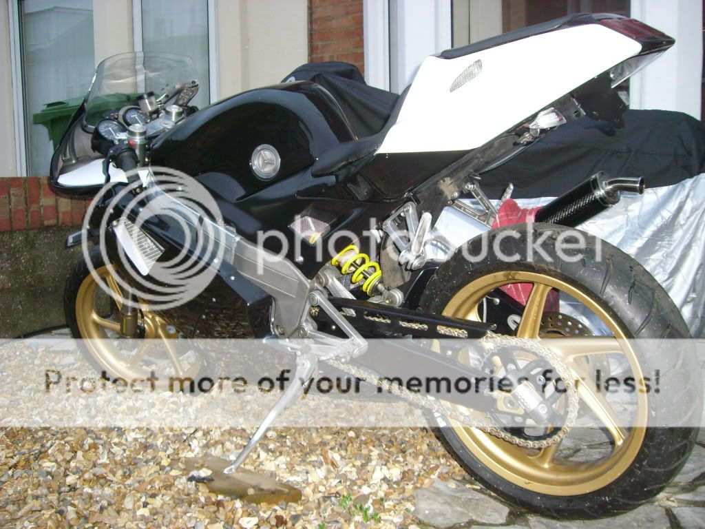

lol, i finished my build. took over a year. hours added up though arnt too bad, i was spending maybe 2 weekends a month on her, sometimes less. bikes been MOTed, insured, dynoed and is on the road! yay lol enjoy.
shaun
https://i788.photobucket.com/albums/yy161/lizard821000/SL700772.jpg
https://i788.photobucket.com/albums/yy161/lizard821000/SL700777.jpg

cheer lads, was a struggle toward the end like, finding out my mains where fked after the build rubbed me the wrong way! lol had to pull and strip the bottom end. all pannels were proffesinaly sprayed, costom decals too but not had the weather to fit yet. bmw solid gold wheels Smile she certainly is pretty alright. thanks for ya coments.
