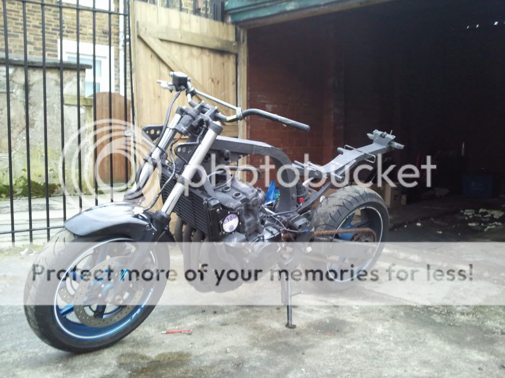

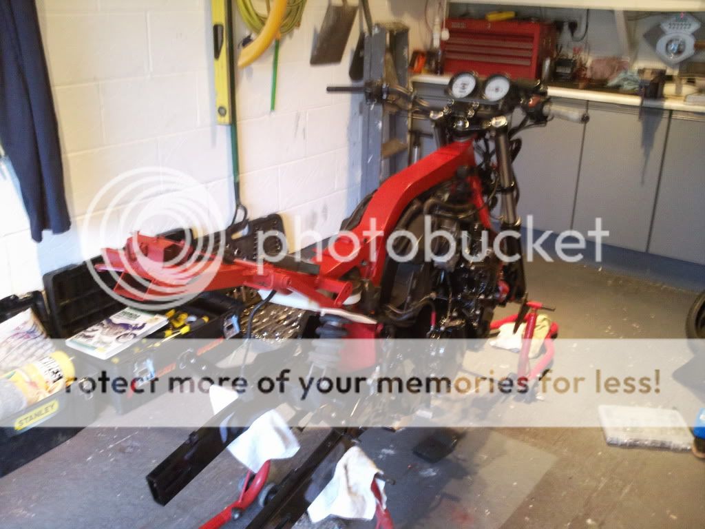

so far all ive done is strip the bike and look online for bits i want/need

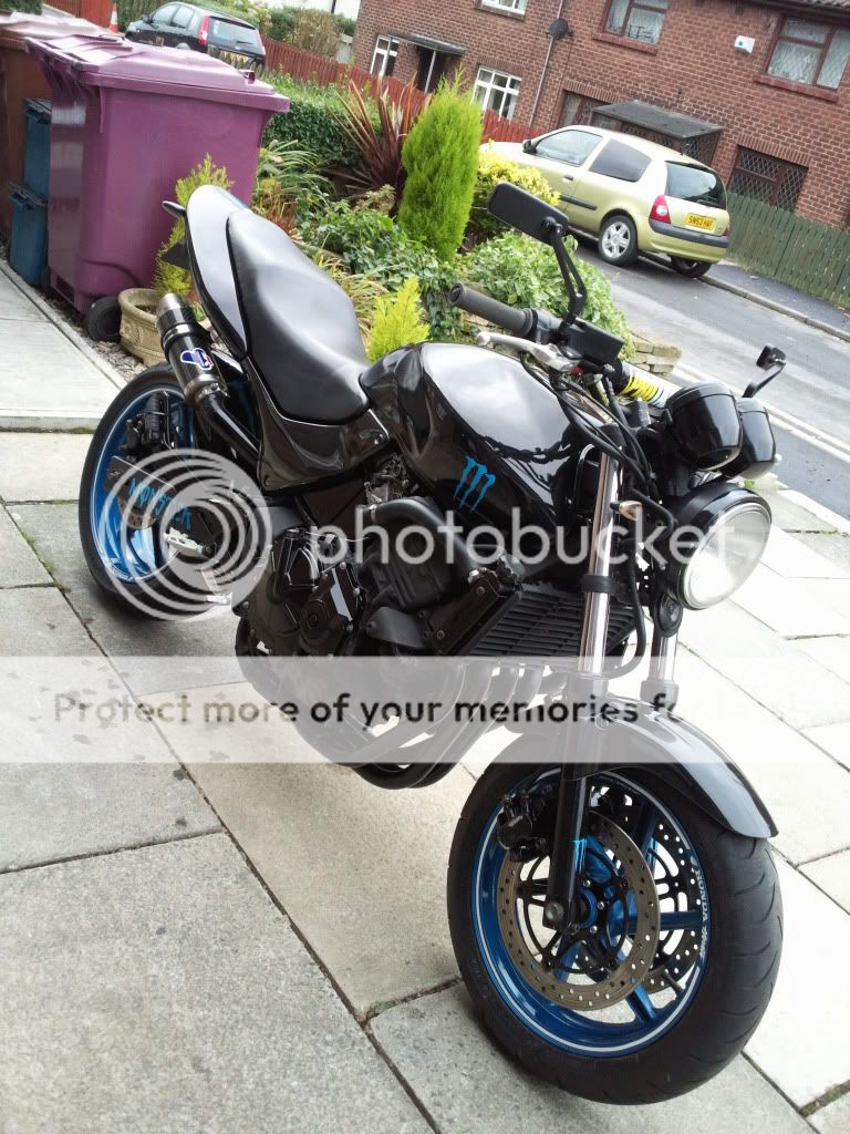

The bike before i started ...
https://i387.photobucket.com/albums/oo314/dazmilliken/Photo205.jpg
progress so far ...
https://i387.photobucket.com/albums/oo314/dazmilliken/Photo043-1.jpg
https://i387.photobucket.com/albums/oo314/dazmilliken/Photo051.jpg
https://i387.photobucket.com/albums/oo314/dazmilliken/Photo053.jpg
https://i387.photobucket.com/albums/oo314/dazmilliken/Photo054.jpg
The bike is now completely stripped, engine out etc... (i just have no photos)
i will take more pics and keep you updated as the build continues Very Happy

Is it just me that thinks that front tyre looks really chunky? What size is it?

the front tyre is standard size ... 130

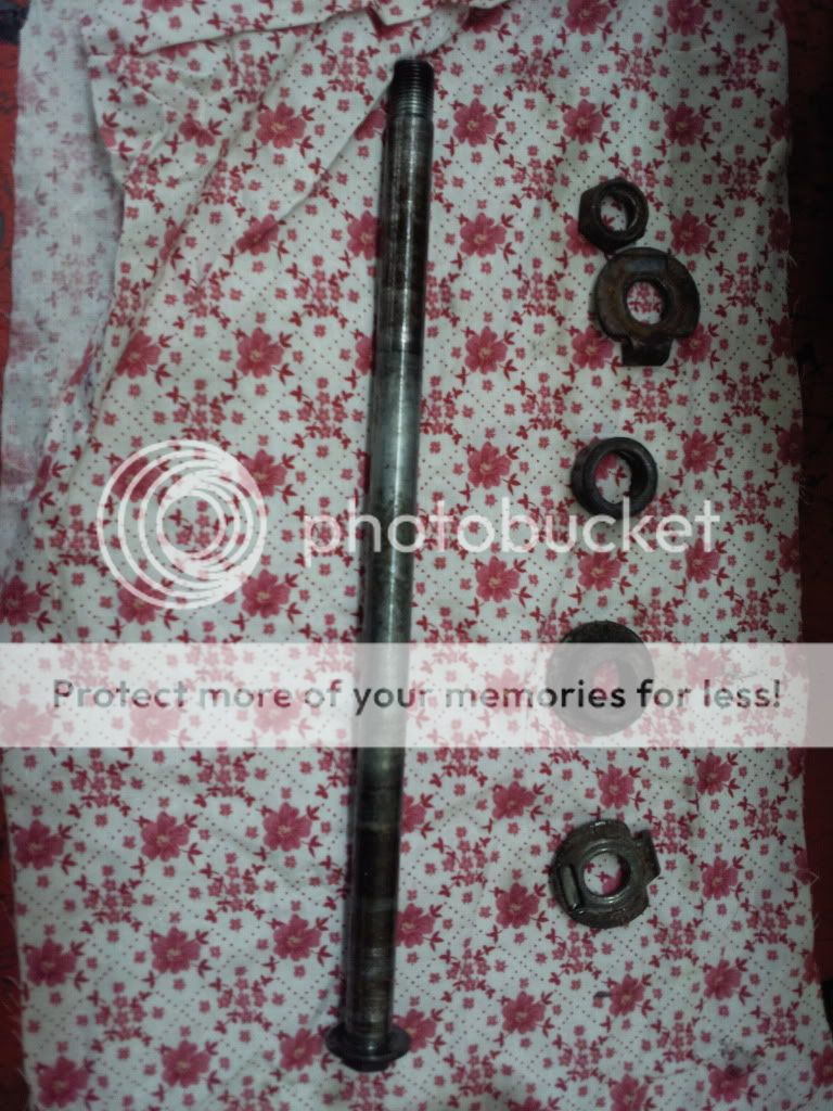

The rear wheel spindle and spacers as they were ..
https://i387.photobucket.com/albums/oo314/dazmilliken/Photo056.jpg

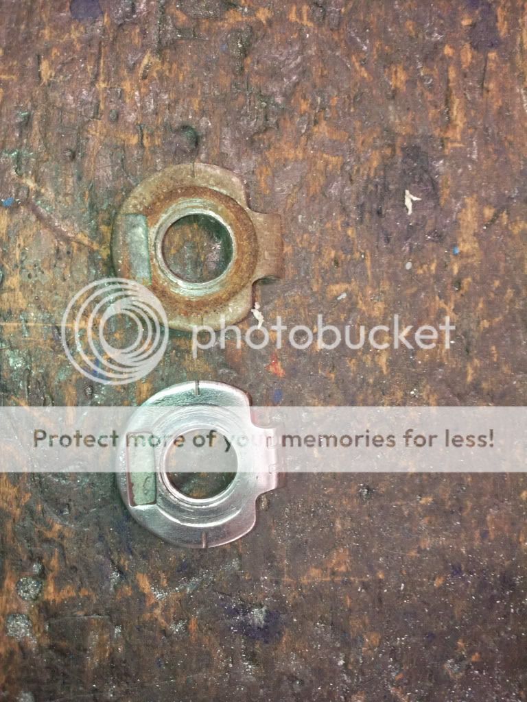

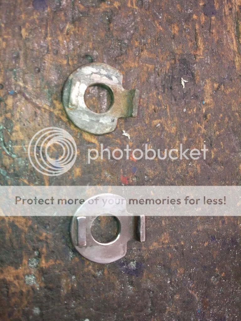

rear wheel alligners (before and after) ..
https://i387.photobucket.com/albums/oo314/dazmilliken/Photo057.jpg
https://i387.photobucket.com/albums/oo314/dazmilliken/Photo058.jpg

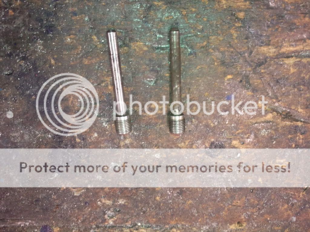

Calliper sliding pins ..
https://i387.photobucket.com/albums/oo314/dazmilliken/Photo059.jpg

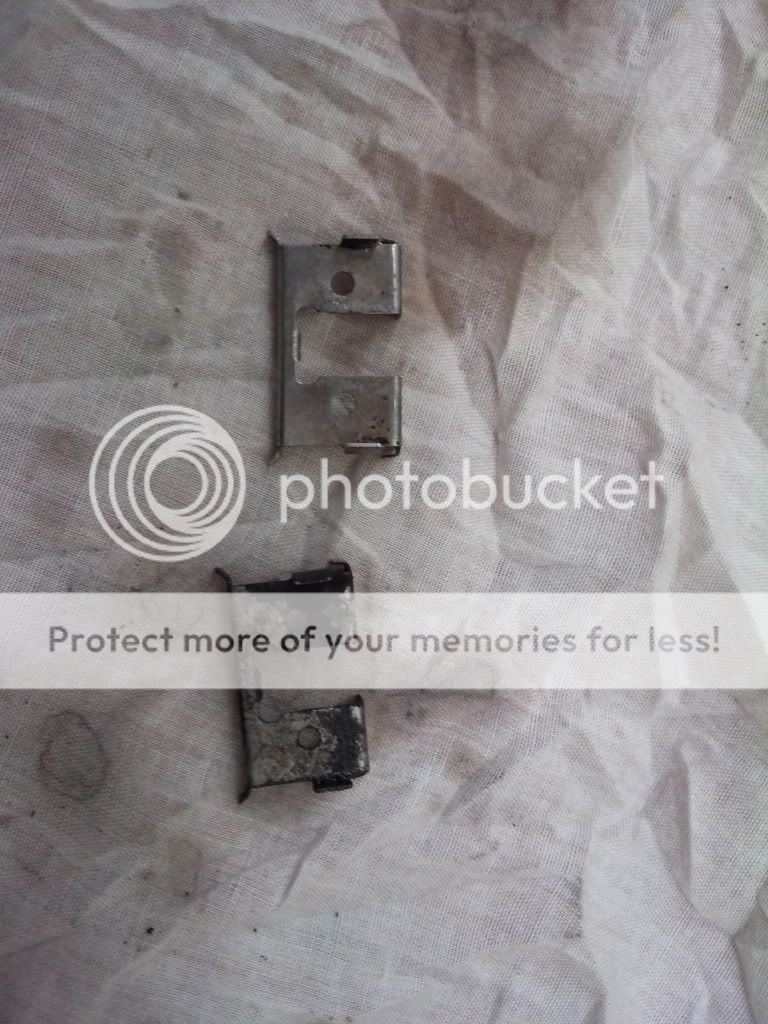

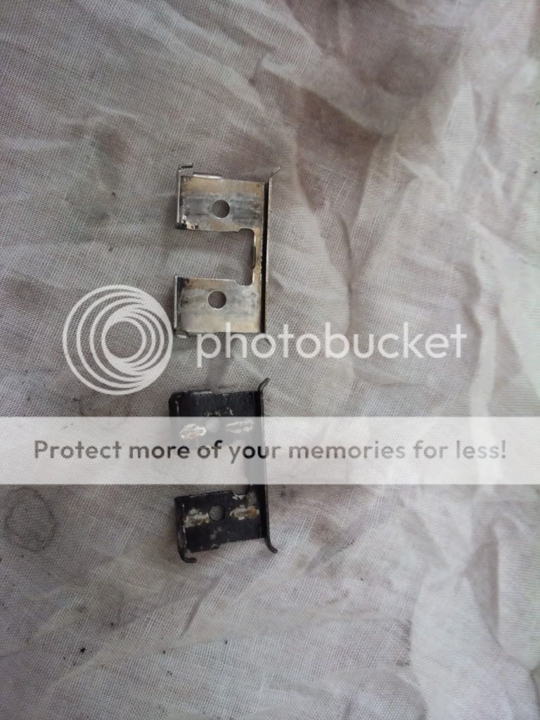

Brake pad holding things :unsure: (before and after)
https://i387.photobucket.com/albums/oo314/dazmilliken/Photo060.jpg
https://i387.photobucket.com/albums/oo314/dazmilliken/Photo061.jpg

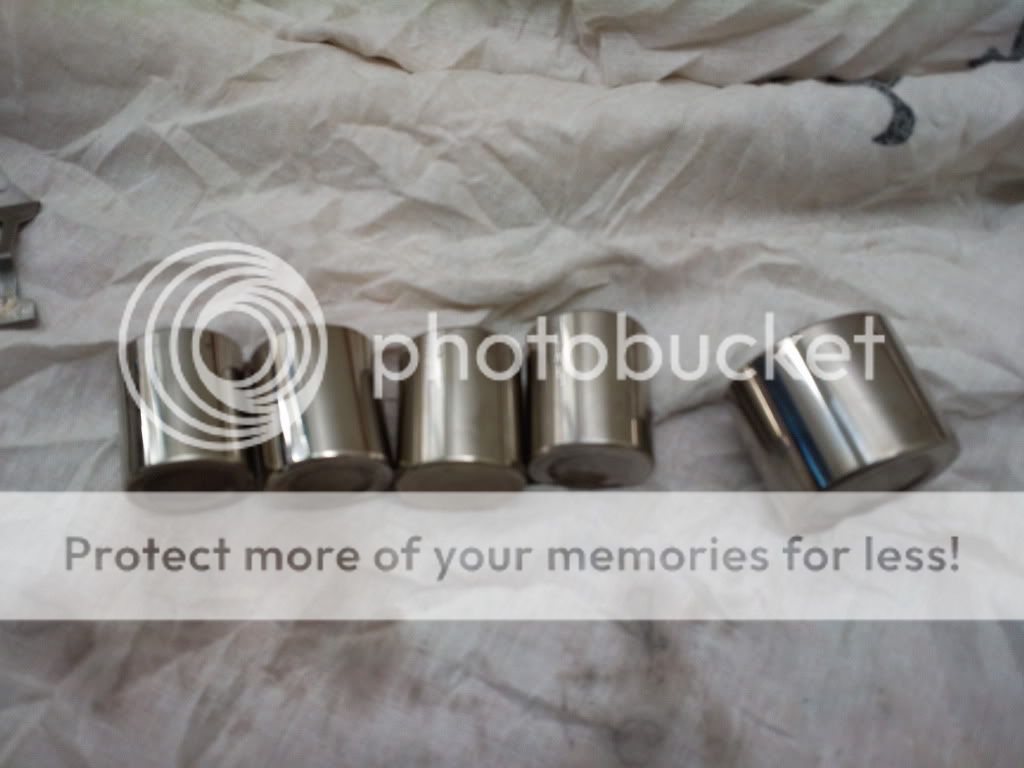

Calliper pistons ..
https://i387.photobucket.com/albums/oo314/dazmilliken/Photo062.jpg

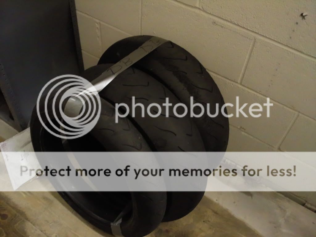

not alot of progress but got the new rubber for the bike today
2 rear metzeler racetech k1's
1 front metzeler racetech k2
£70 = BARGAIN Wink

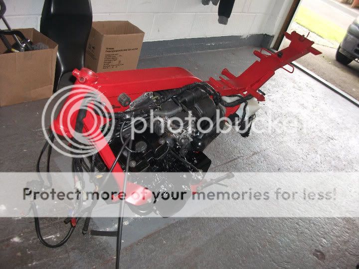

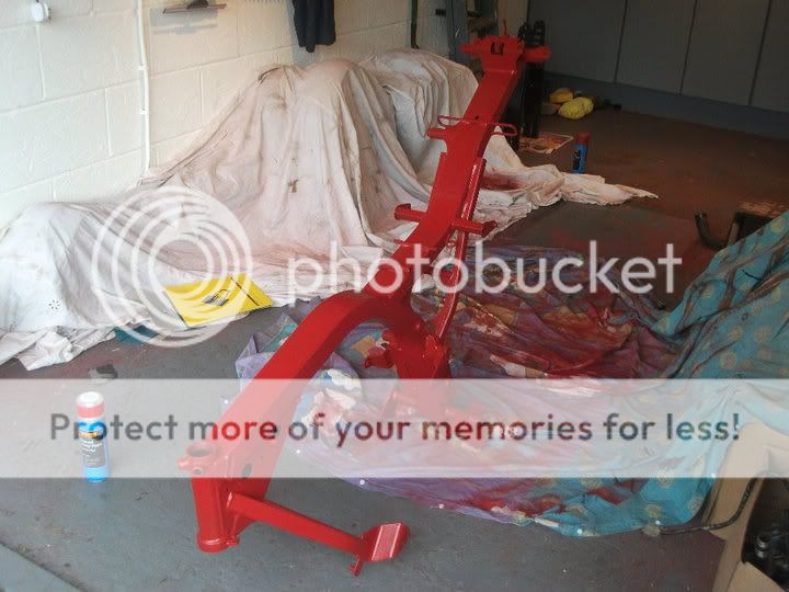

Frame painted ...
https://i783.photobucket.com/albums/yy112/DiggiDamoo/daz/daz5.jpg

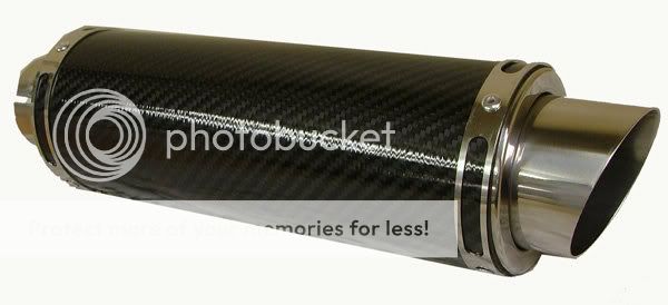

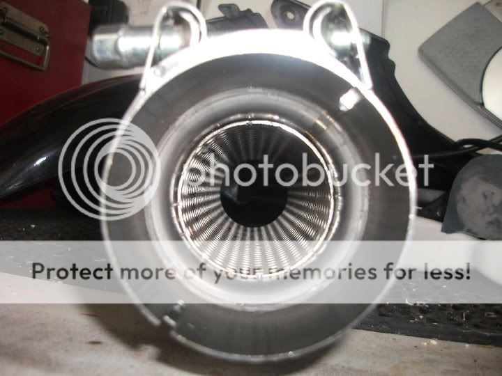

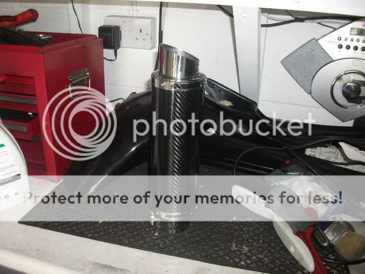

New exhuast ...
https://i783.photobucket.com/albums/yy112/DiggiDamoo/daz/daz6.jpg
https://i783.photobucket.com/albums/yy112/DiggiDamoo/daz/daz8.jpg
https://i783.photobucket.com/albums/yy112/DiggiDamoo/daz/daz9.jpg

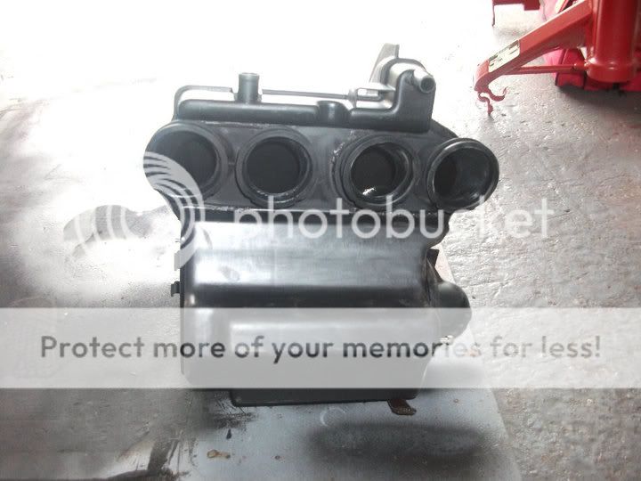

New airbox ...
https://i783.photobucket.com/albums/yy112/DiggiDamoo/daz/daz7.jpg

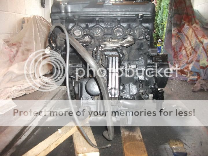

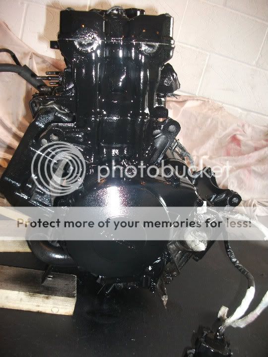

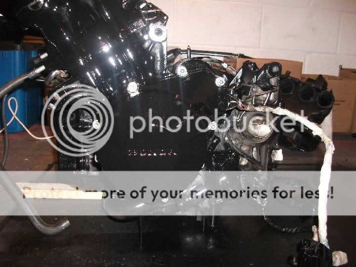

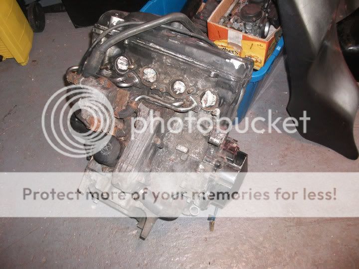

Engine before cleaning and painting ...
https://i783.photobucket.com/albums/yy112/DiggiDamoo/daz/daz10.jpg

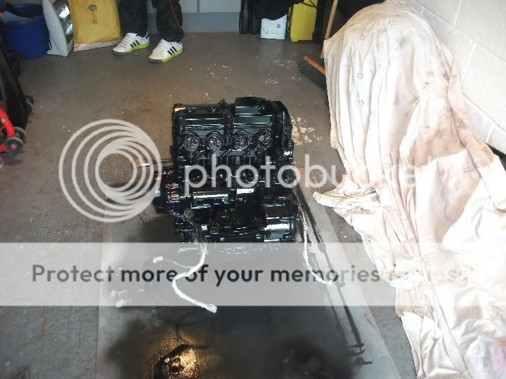

Engine after priming ...
https://i783.photobucket.com/albums/yy112/DiggiDamoo/daz/daz11.jpg
https://i783.photobucket.com/albums/yy112/DiggiDamoo/daz/daz12.jpg

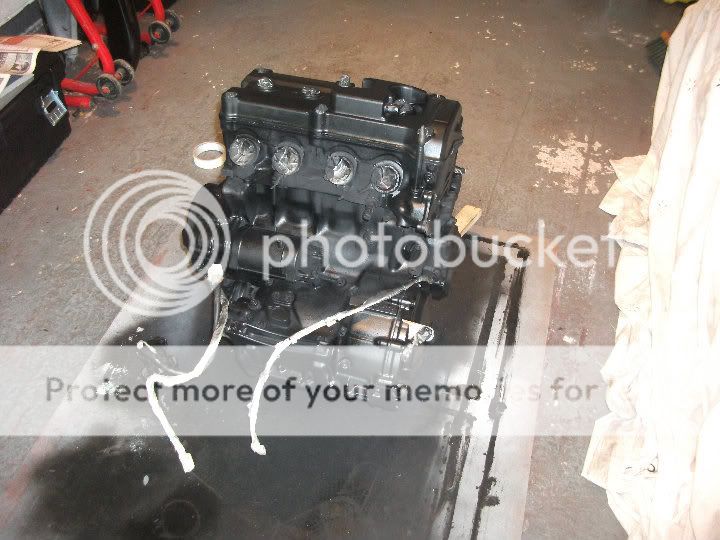

Engine 1st coat ...
https://i783.photobucket.com/albums/yy112/DiggiDamoo/daz/daz13.jpg
Engine 2nd coat ....
https://i783.photobucket.com/albums/yy112/DiggiDamoo/daz/daz14.jpg
Engine New bolts ...
https://i783.photobucket.com/albums/yy112/DiggiDamoo/daz/daz15.jpg

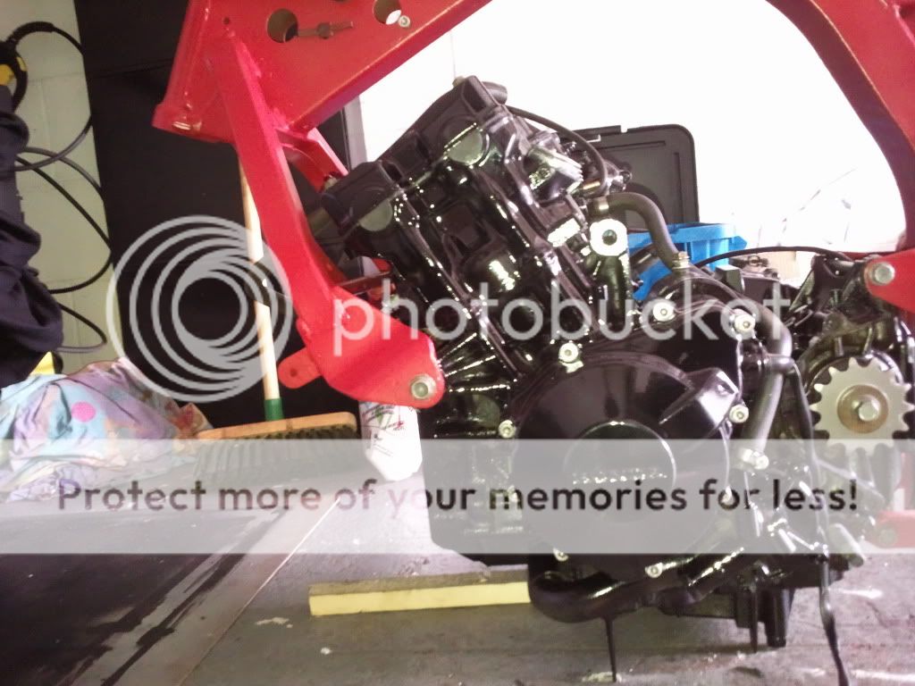

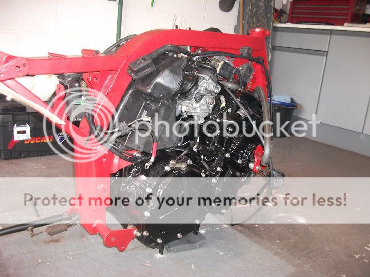

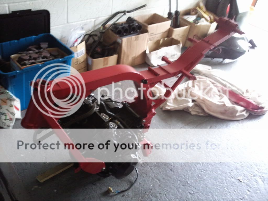

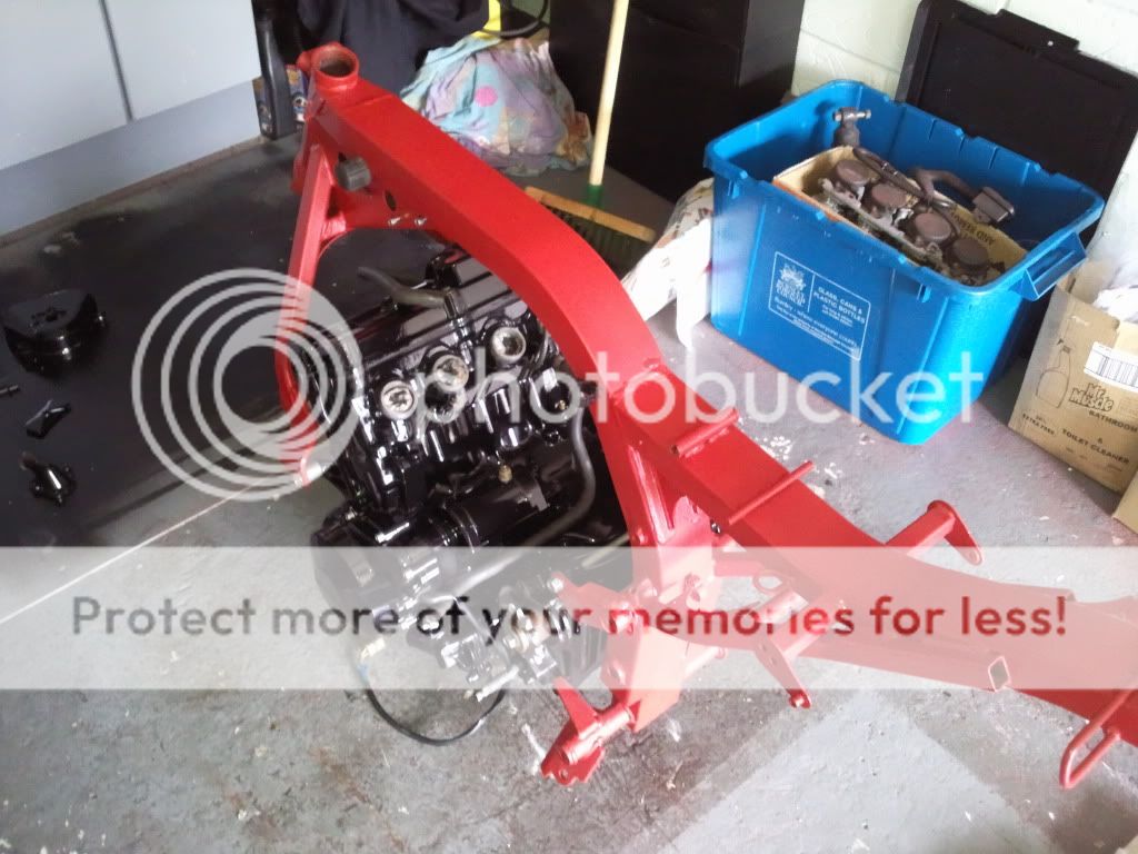

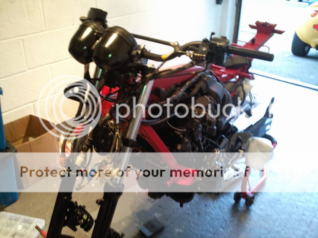

Engine in frame now Very Happy
https://i783.photobucket.com/albums/yy112/DiggiDamoo/daz/Photo005.jpg
https://i783.photobucket.com/albums/yy112/DiggiDamoo/daz/Photo004.jpg
https://i783.photobucket.com/albums/yy112/DiggiDamoo/daz/Photo003.jpg

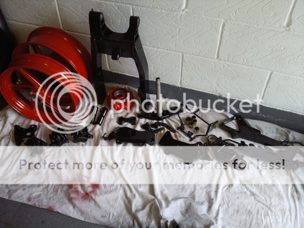

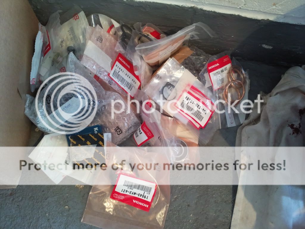

My pile of parts from Mr Honda
https://i387.photobucket.com/albums/oo314/dazmilliken/34-2.jpg

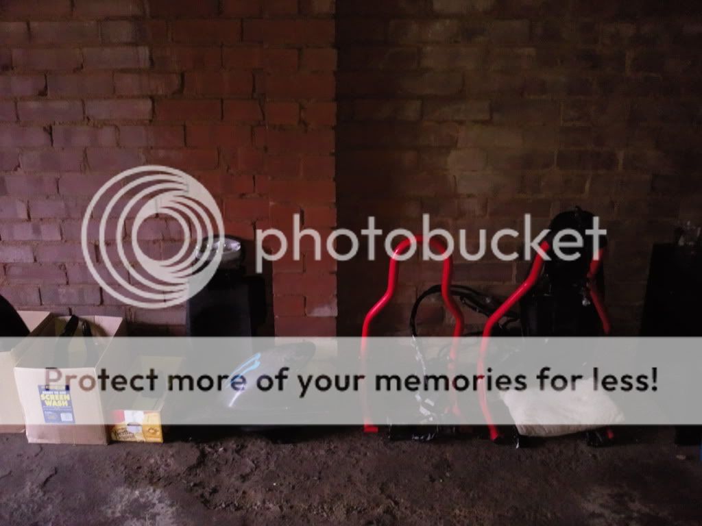

All the stuff from Mr powdercoating man Very Happy
https://i387.photobucket.com/albums/oo314/dazmilliken/32-1.jpg

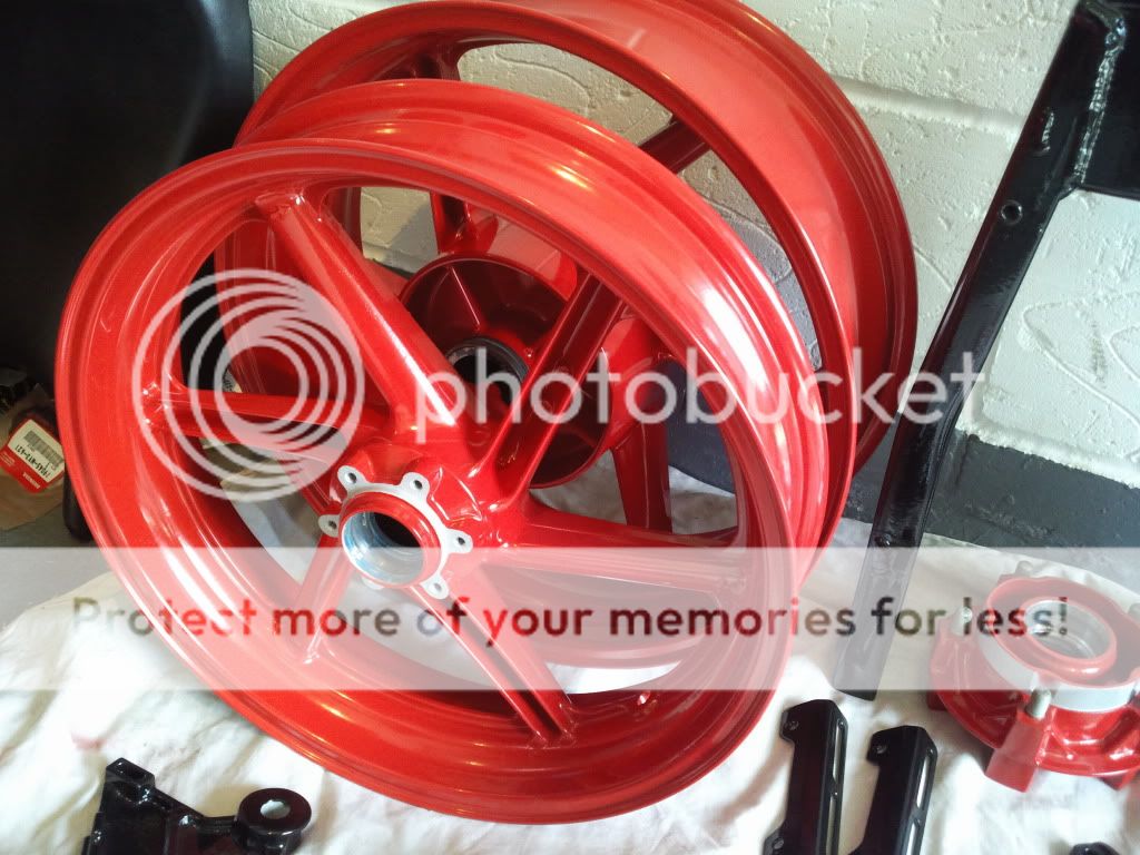

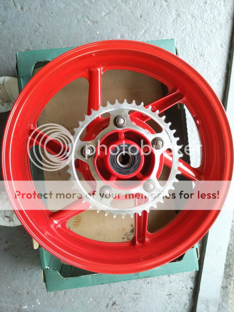

Wheels Wink
https://i387.photobucket.com/albums/oo314/dazmilliken/33-1.jpg
New rear sprocket on
https://i387.photobucket.com/albums/oo314/dazmilliken/35-1.jpg

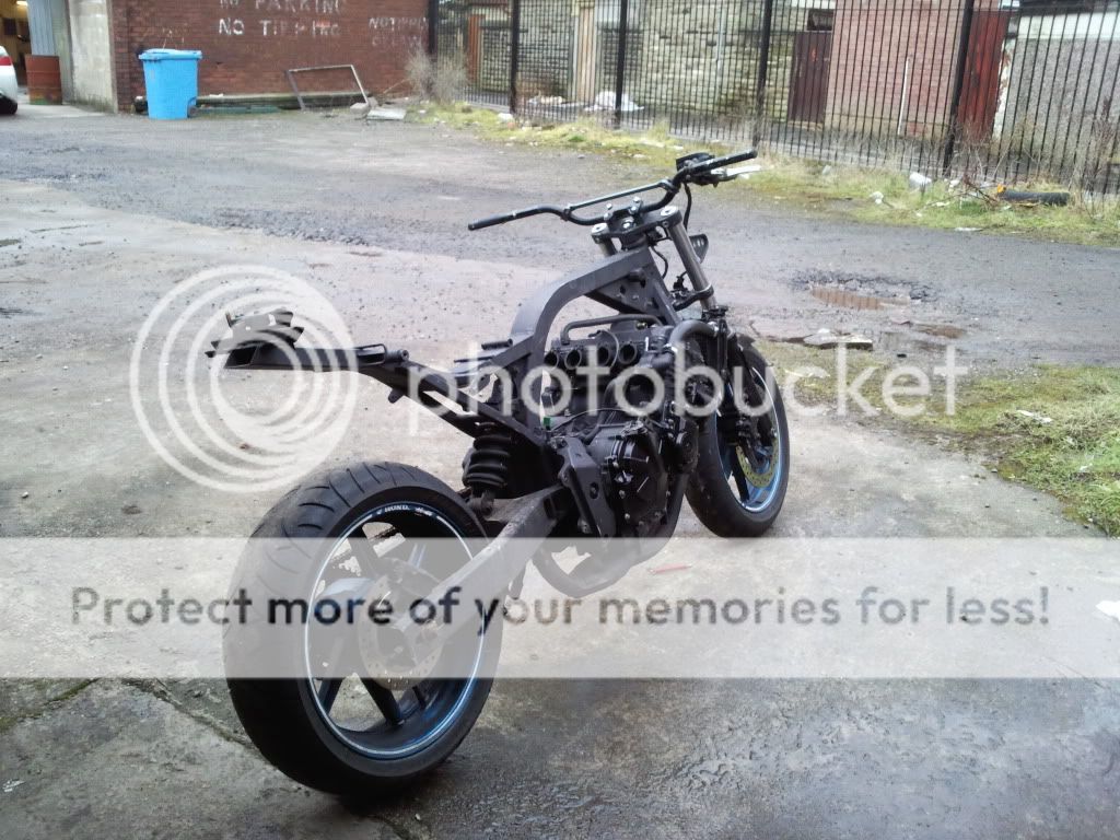

how it stands atm
https://i387.photobucket.com/albums/oo314/dazmilliken/36-1.jpg
https://i387.photobucket.com/albums/oo314/dazmilliken/37-1.jpg

How'd you go about painting the engine? Mines gonna be done soonish, day job?
1998 CB600F Hornet
m0l0t0v
Joined: 20 Sep 2006
PostPosted: 04:36 - 19 Aug 2010    Post subject: Reply with quote
DazHornet wrote:
i sold the project as it was, in a million pieces, and then bought it back a month later exactly the same ha and this is how it is now i wont do lots of talking ill let the pics do all the work
Neutral
What?!
Red and black, nice Thumbs Up
I wish I had 4k to spend on mine. Sad
DazHornet
Joined: 24 Sep 2009
PostPosted: 09:27 - 19 Aug 2010    Post subject: Reply with quote
yeah the engine took me a day, i used heat resistant satin black to prime it (could also use heat resistant matte) did 3 thin coats of this
satin takes 15mins to dry fully so that didnt take long.
then i painted it with hammerite smooth black (its heat resistant and i used it for casing covers in lastbuild and it didnt mark one little bit) i used a full can of this in thin coats to make sure it was a good job. leaving it to go very sticky before adding a second coat.
worse thing you can do with hammerite is wait for it to dry before doing another coat it just fooks up. wait for it to go tacky and then apply another coat and you will get perfect job Wink
