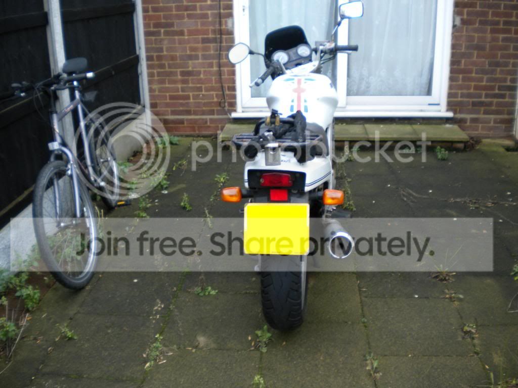

My NTV is/was a bit like that;
The headlight is held on by bicycle light brackets. The brackets were designed for bicycle forks so were tiny, I bent the metal so they cupped my forks, then secured with jubilee clips, rubber gloves and some long bolts. Then it turned out the bracket wasn't long enough to fit all of the wiring behind, so we cut up some old wood brackets and bolted them on the ends, then drilled some extra holes for diddy indicators as the originals were part of the headlight bracket assembly. Job jobbed.
https://i235.photobucket.com/albums/ee81/paddy2007dug/NTV600/Picture014.jpg
https://i235.photobucket.com/albums/ee81/paddy2007dug/NTV600/Picture002.jpg
Also the tail light is a bicycle light as the wiring was bollocksed, the light holder was designed for a bicycle seat pole with a fat diameter, but the best place I could put it was my pillion grab rail. Obviously it was a very loose fit. The solution, wrap a sponge around it first. If you look carefully you can see it in this picture:
https://i235.photobucket.com/albums/ee81/paddy2007dug/NTV600/Picture004.jpg
Loads of other small stuff but they are the main two.

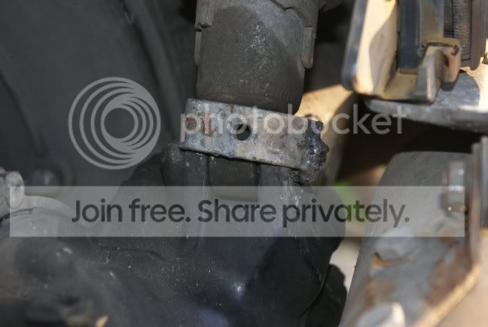

Had a bolt snap in the rear hub on a pan euro, no spare bolt and couldn't get broken bit out so refitted broken one (pushed it back in) and welded a bit of metal to it and bent it round the shocker.
Result, bolt not screwed in but the newly attached bit of metal would stop it falling out
https://i370.photobucket.com/albums/oo141/bramble43/shockbracket.jpg

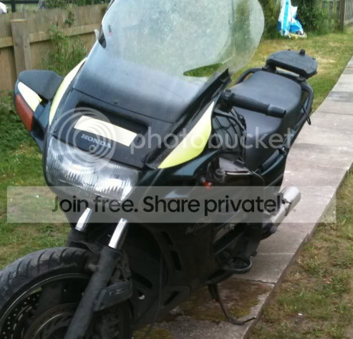

Another one.
A mate, who is a BCF member had an unplanned bike/car/tarmac interface which removed his left hand mirror and indicator.
The result was this below. Just an orange bulb in the indicator bulb holder and it stayed like this for weeks before the inevitable and it got stripped for very few parts
https://i370.photobucket.com/albums/oo141/bramble43/indicator.jpg
Looking at it the pic shows an almost roadworthy bike, do not be fooled

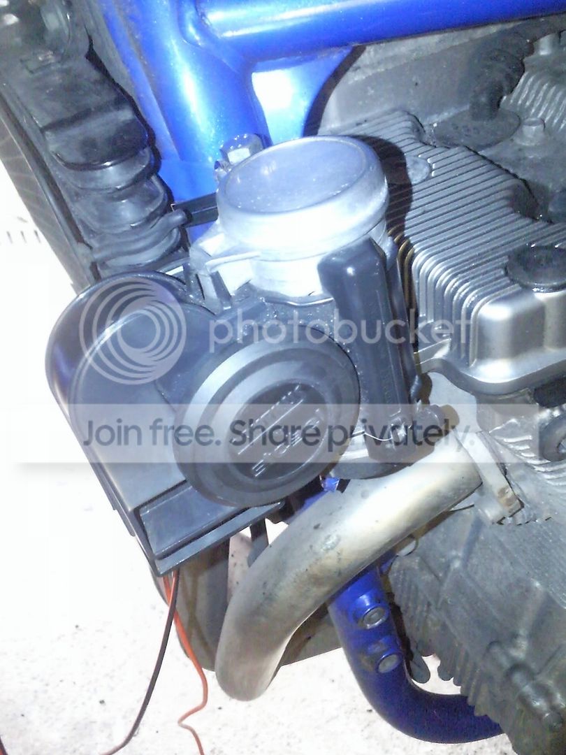

I have part of a curtain pole bracket modified and used to mount my Stebel Nautilus horn....
so, from this bracket...
https://www.terrysfabrics.co.uk/images/P/poles-apart-Chrome-support.jpg
to this mounting solution...
https://i42.photobucket.com/albums/e312/Dazbo666/Bike%20Bits/Photo065stebelsecured.jpg
(The hex bolt against the frame is the one that fixes the Stebel into the P-shape of the bracket)
https://i42.photobucket.com/albums/e312/Dazbo666/Bike%20Bits/Photo066stebelcomplete.jpg

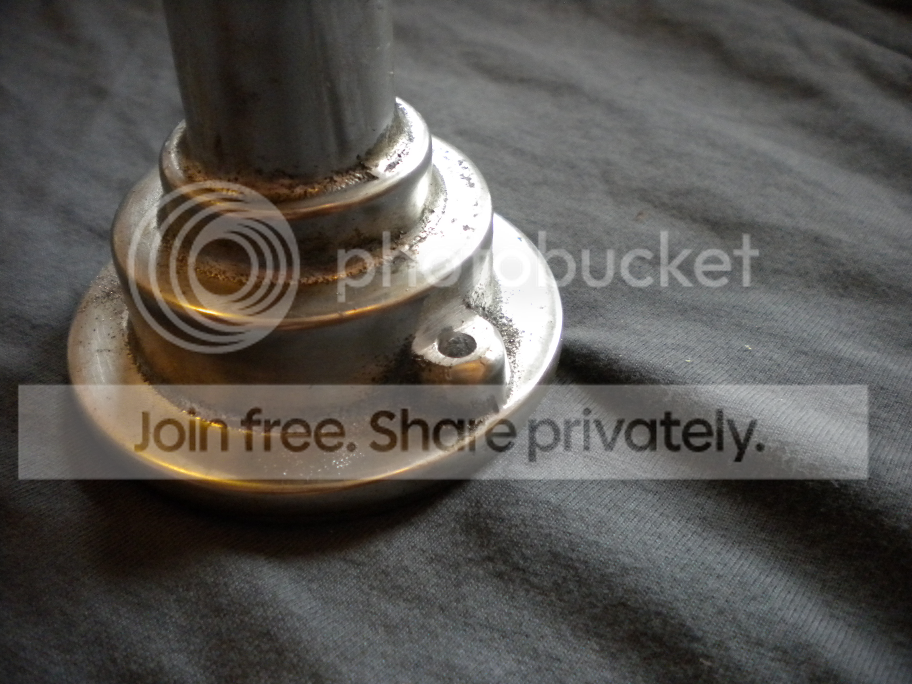

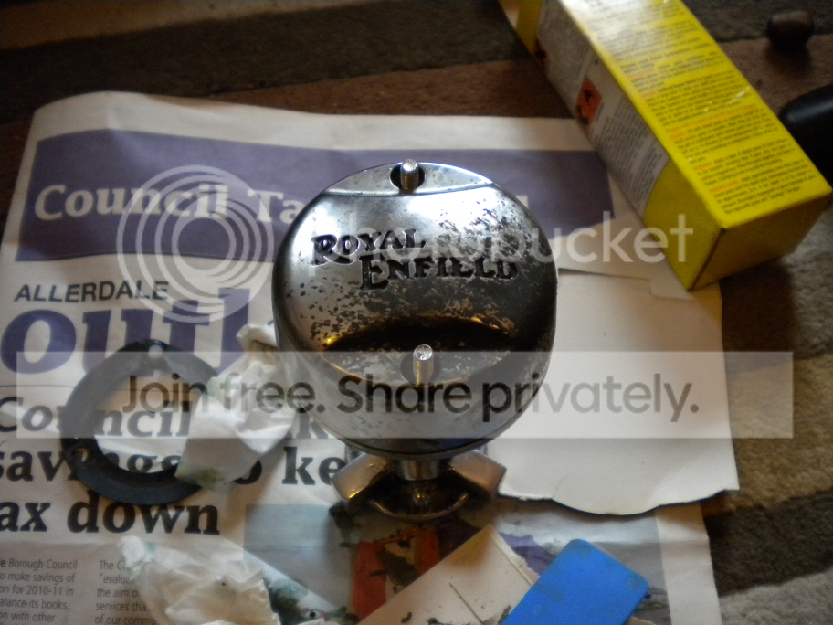

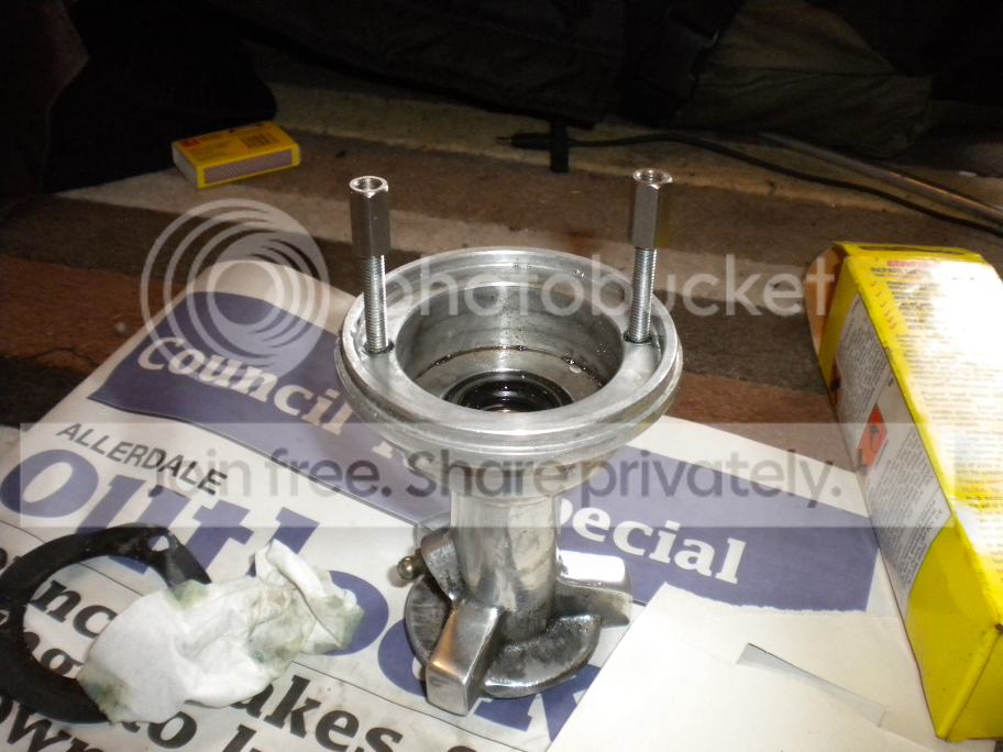

Stripped thread holding stator plate onto the distributor casting of my Enfield:
https://i48.photobucket.com/albums/f216/stinkwheel/distributor/DSCN0679.png
Drill out hole all the way through. File rounded end of casting square:
https://i48.photobucket.com/albums/f216/stinkwheel/distributor/DSCN0680.png

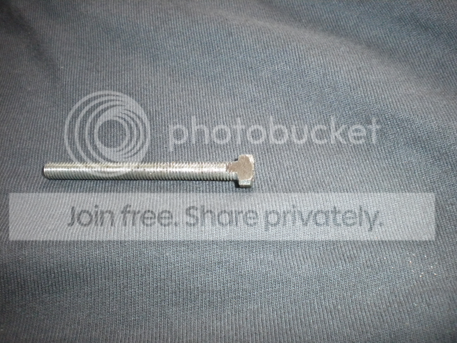

Grind flat onto end of a bolt:
https://i48.photobucket.com/albums/f216/stinkwheel/distributor/DSCN0682.png

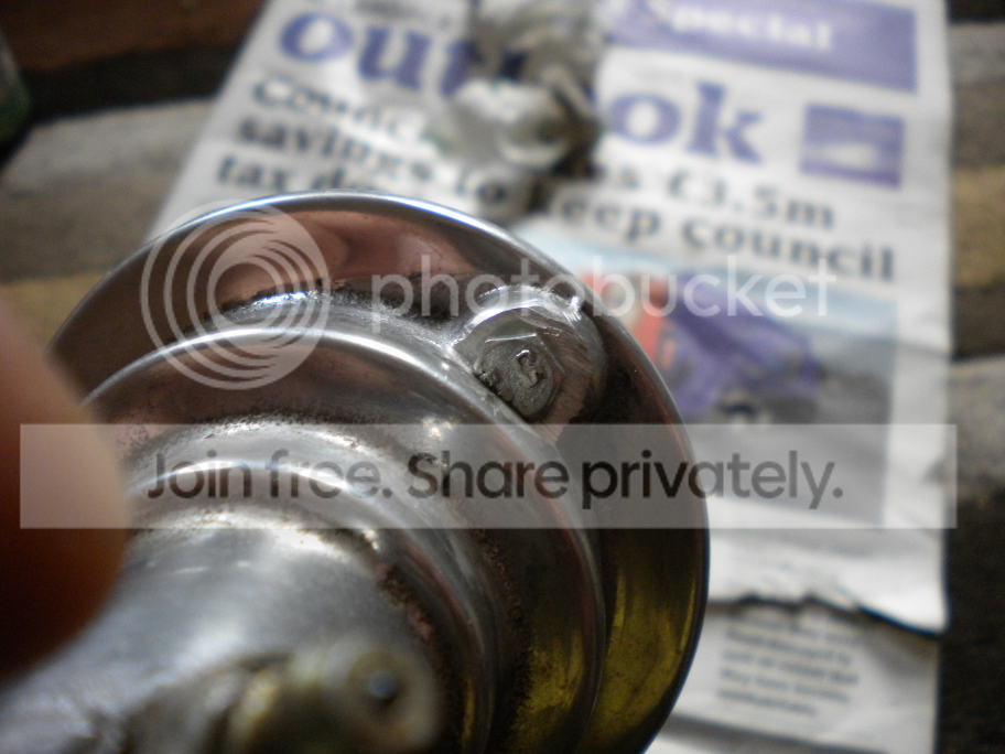

Push bolt all the way through and glue in place with green bearing seal:
https://i48.photobucket.com/albums/f216/stinkwheel/distributor/DSCN0683.png

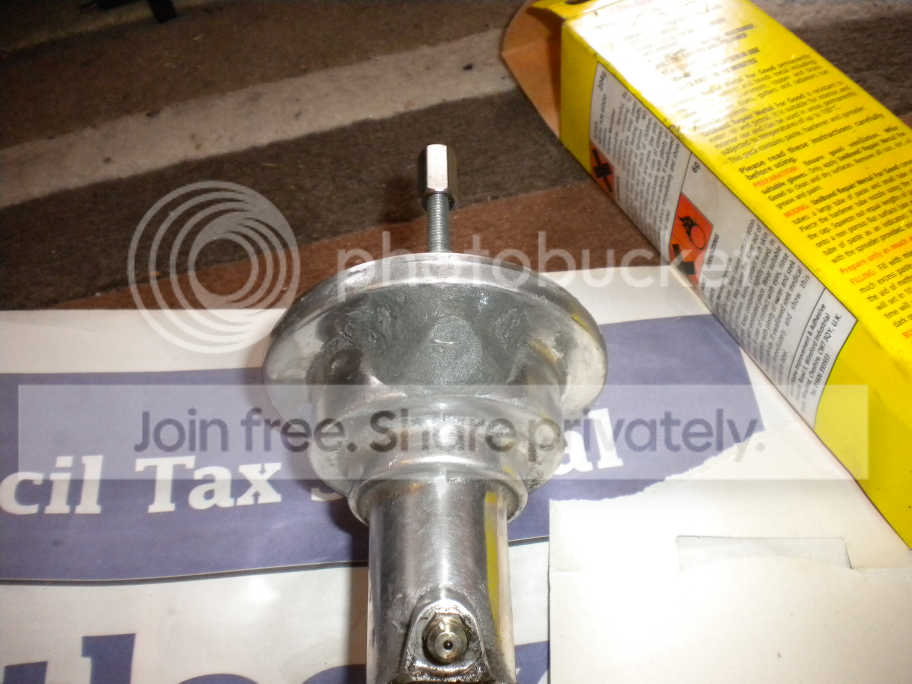

Chemical metal over the back to stop it pushing out easily:
https://i48.photobucket.com/albums/f216/stinkwheel/distributor/DSCN0684.png

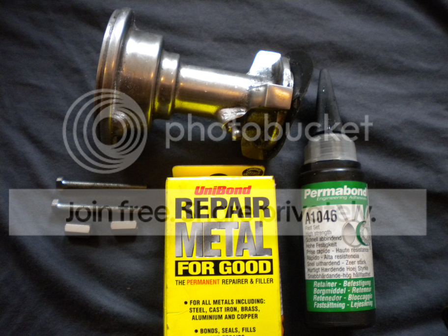

Repeat for other side and the job's a good-un:
https://i48.photobucket.com/albums/f216/stinkwheel/distributor/DSCN0685.png
https://i48.photobucket.com/albums/f216/stinkwheel/distributor/DSCN0686.png
