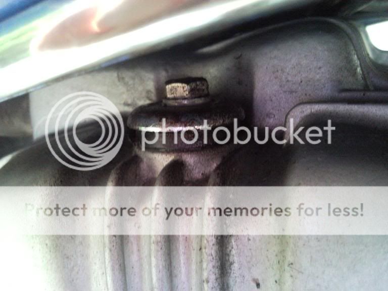

PostPosted: 19:19 - 01 Jun 2011    Post subject: Reply with quote
Are you on about the rubber inserts that the bolt sits on?
https://i979.photobucket.com/albums/ae271/RxsOllie/SNC00161.jpg
The bit under the washer?
Both of mine leak Laughing
