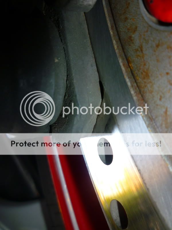

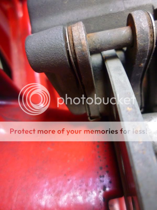

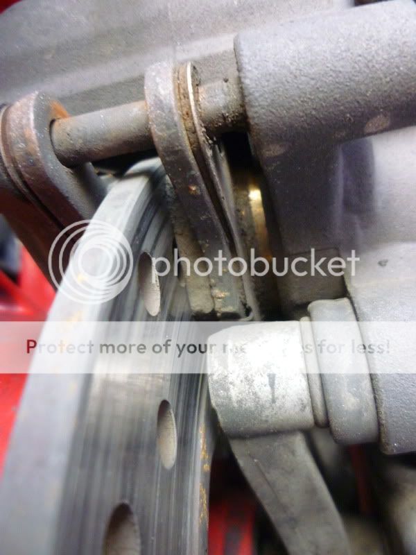

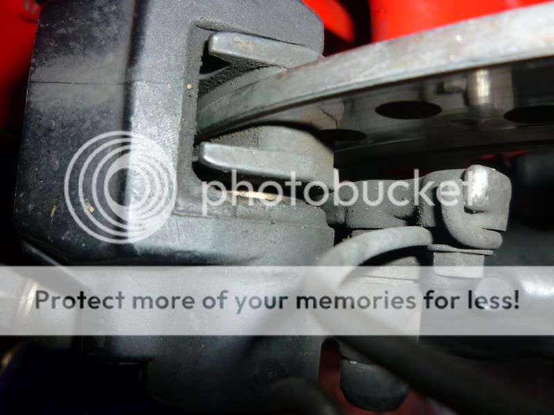

Hello,
Was out earlier in the week for the first time since the good weather started. I noticed that my bakes were terrible, it felt like they were almost non existent. Checked both fluid reservoirs and they're fine. Took a few pictures of my pads as well:
https://i4.photobucket.com/albums/y118/Wonderboy_001/P1000945.jpg
https://i4.photobucket.com/albums/y118/Wonderboy_001/P1000946.jpg
https://i4.photobucket.com/albums/y118/Wonderboy_001/P1000947.jpg
https://i4.photobucket.com/albums/y118/Wonderboy_001/P1000948.jpg
There's clearly still a little bit left on the pads, would think that would effect the brakes that much to be honest.
Any suggestions?

Loads of meat left on those mate, getting low is when you can no longer see the line that goes through the middle (around 1mm or less)

They look fine to me, but if I were you I'd be more worried about the calipers being seized than anything else. As I recall the CBR600 in your avatar has sliding calipers, and so it could be that the sliders are corroded and the calipers don't want to move.
I'd take the whole lot off, strip and clean it, and free off the pistons if they are stuck. If the brake fluid is old, a fluid change would not go amiss.
PostPosted: 17:11 - 08 May 2011    Post subject: Re: Poor Braking... How do these pads look? Reply with quote
StevenF wrote:
You can see in these two pictures that the pad pins here are bone dry and you can see little brown blobs of corrosion where the pads meet the pins. I'd say thats in definite need of a strip and clean. Copper grease is good for pad pins and sliders, but obviously you must not get any on the pad material.
If I were you, I'd also pump out the brake pistons and put a smear of red rubber grease on them, and then push them back in... unless they are also very corroded in which case you need to replace them along with the calpier seals too.

Ah didnt realise they were sliding calipers, they should be quicker to service then with half the pistons and seals Smile Thumbs Up

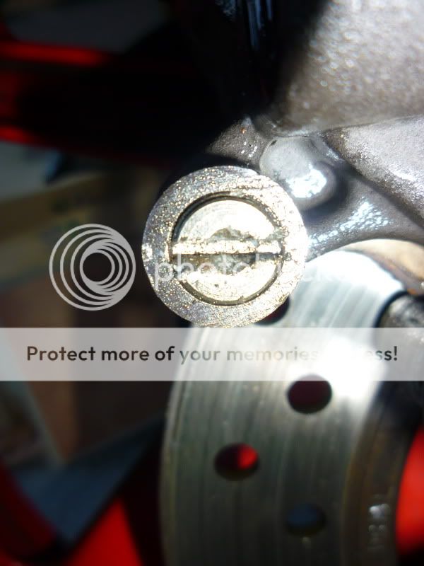

Came across a problem! Twisted Evil
The rear pad pin won't turn, the metal just disintegrates when I try turn it with a screw driver:
https://i4.photobucket.com/albums/y118/Wonderboy_001/P1000951.jpg
Once the pads are out, do I just start cleaning them up?

I'd run over the pad pins with a fine emery paper to get rid of any corrosion. If they are badly pitted, or have grooves worn in them they'll need replacing. That one there will probably need replacing as you've rounded the head off.
tatters
Exxon Valdez
Joined: 05 Jan 2004
PostPosted: 22:49 - 08 May 2011    Post subject: Reply with quote
Thats not the pad pin but a brass cap, the pin has a allen type bolt head under the cap.
If the cap wont come off when heated you need to drill it.
