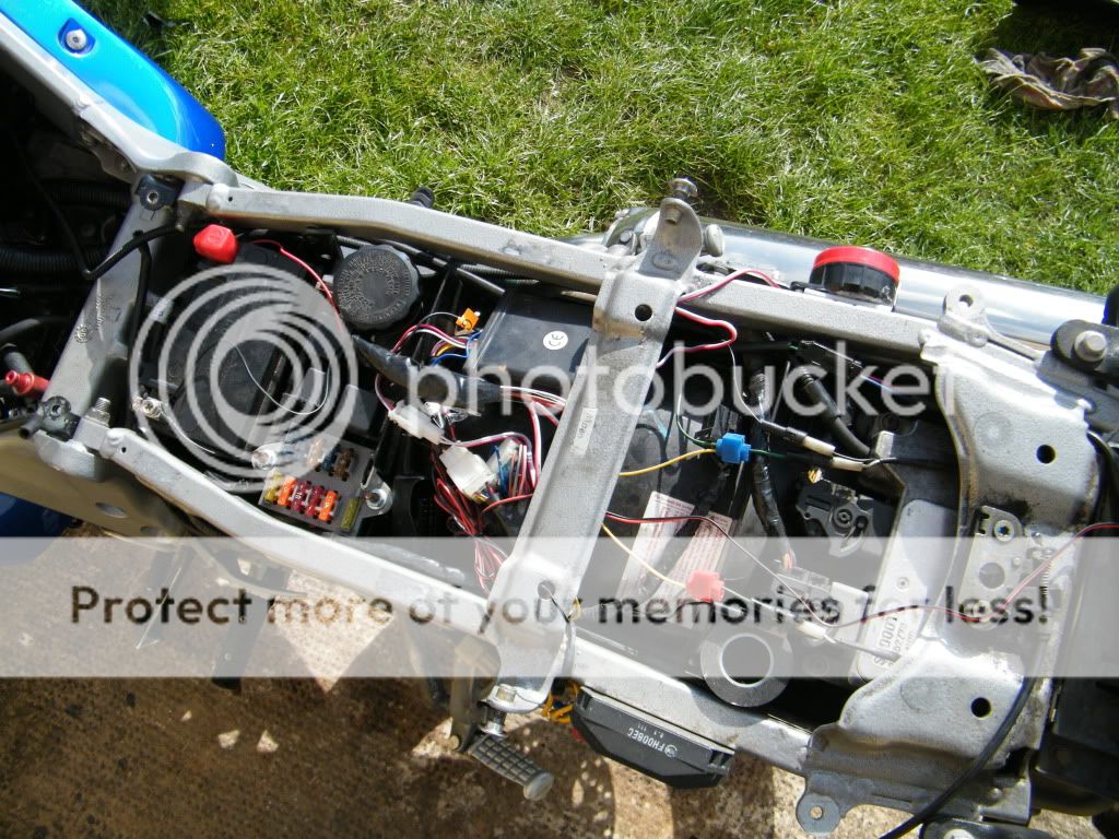

Right. stripped the rear end to get to it, so piccies.

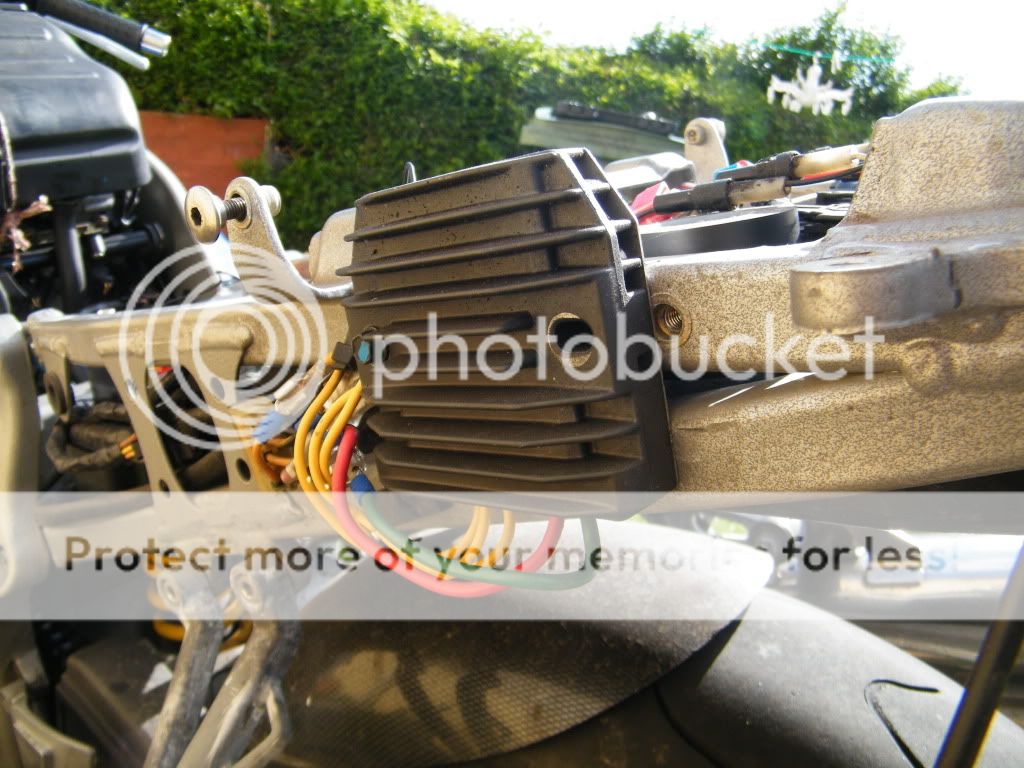

Reg/rec
https://i624.photobucket.com/albums/tt325/duncdmc/DSCF0985.jpg?t=1305733580
Wiring from the reg/rec

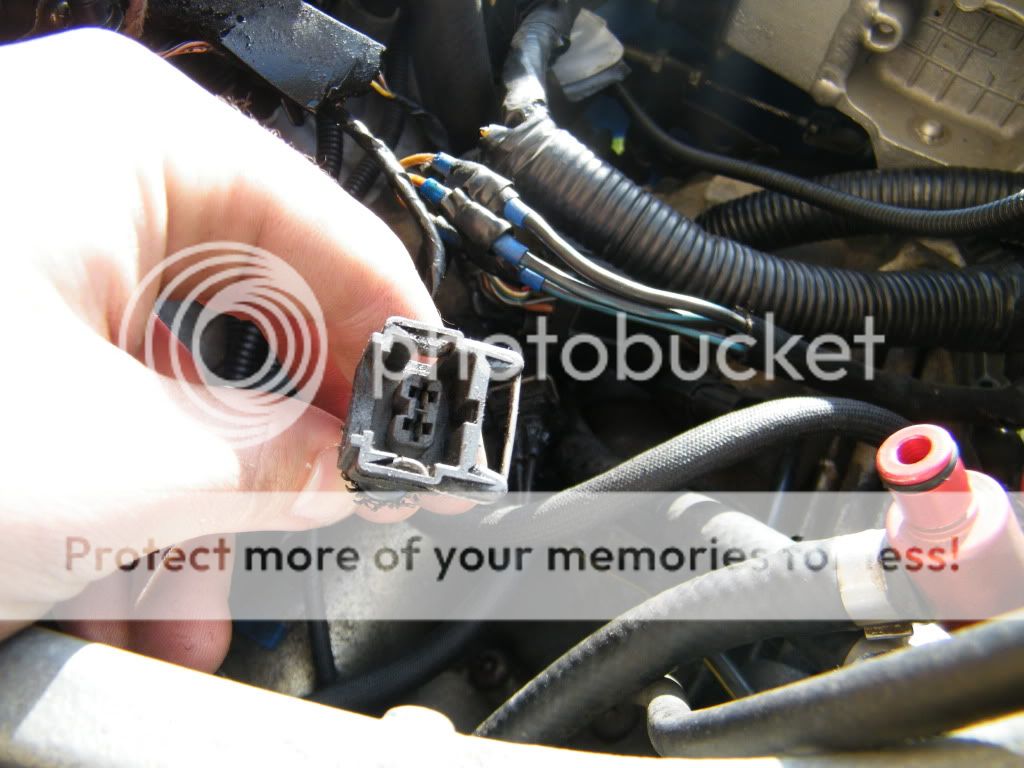

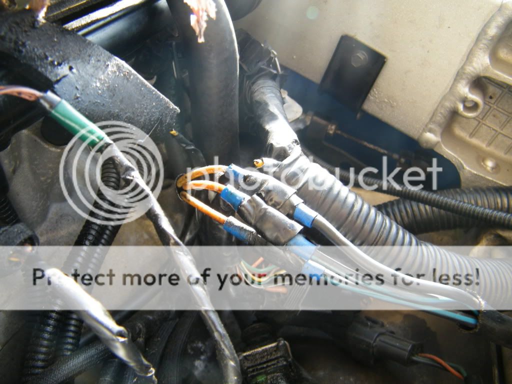

Wiring that leads to the bit that was cut
https://i624.photobucket.com/albums/tt325/duncdmc/DSCF0987.jpg?t=1305733720
https://i624.photobucket.com/albums/tt325/duncdmc/DSCF0988.jpg?t=1305733726

WTF is this for?
https://i624.photobucket.com/albums/tt325/duncdmc/DSCF0990.jpg?t=1305733728

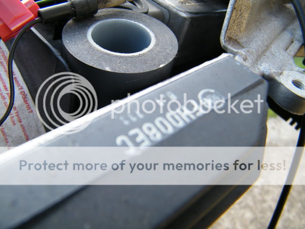

numbering on the reg/rec
https://i624.photobucket.com/albums/tt325/duncdmc/DSCF0991.jpg?t=1305733780
https://i624.photobucket.com/albums/tt325/duncdmc/DSCF0986.jpg?t=1305733581
The top yellow and black wires at the clear connector. Is that dirt, oil and crud or burned insulation?
If you've got a meter you should be able to test the alternator from that connector. There's a TT600 Service manual on Scribd
Disconnect any lighting fuses before running to minimise any more stuff getting fried.

But as in the pictures, anyone able to tell me what that connector is for, and why it's not connected to anything, and also where those yellow wires go?

PostPosted: 17:27 - 18 May 2011    Post subject: Reply with quote
Mr Dunkable wrote:
Dunno, but my S4 had a spare what looked like injector connector like that. Never found out what it is for.

...and also where those yellow wires go?
Is it possible that if a garage (or spanner monkey) has replaced the stator in the past, that the cut off yellow wiring is the original wiring that they've just left in situ, where it was neatly tidied away, and cut off either end? Where does the other end of that tubing it's in go to?

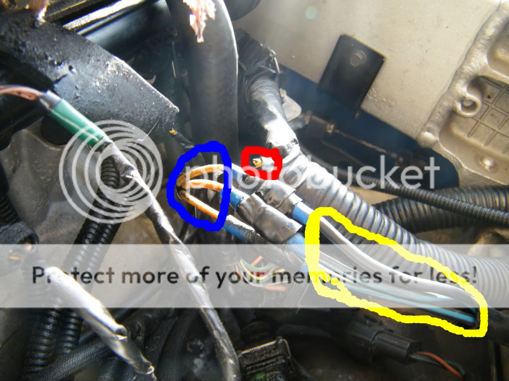

I'll explain with the use of THIS!
https://i624.photobucket.com/albums/tt325/duncdmc/DSCF0987-1.jpg?t=1305737692
Yellow is the wires that go to the reg/rec. These would have been the 3 yellow wires in the red circle.
The ones in the BLUE circle go to the genny. The ones in the red circle just go into the loom, didnt get a chance to trace them.
Dunc
OK, makes sense. I'd suspect the 3 yellows in the red circle are old Reg/Rec input wires, from when it was last replaced.

When you get the new loom in, I'd test it all thoroughly with a meter before going out on any long rides.
Cant find any datasheet on FH008EC Regulator. It looks like FH008EB were fitted to later CBR600 and CBR1000RR and are rated at 35A. Maybe EC is a later revision? Current Shindengen production unit is FH012, rated at 50A.
Should be up to the job I'd have thought, if it isn't fried.
