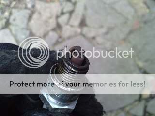

Just been for a lovely run and 'plug chopped' her. Was fun, throttle off, key off, lock up the rear to disengage the clutch. Pushed it into the garden popped the plug out and found this:
https://i279.photobucket.com/albums/kk125/MartayP/P230611_17330001.jpg
Cant really complain i dont think.

Looks good from here but could do with a profile shot really just to be sure. Can't see the bit that the spark jumps across. The middle of the spark plug, what's that bit called?

looks good to me, nice dark coffee colour. Do a compression test as well just to be sure. You need to get the figures of the pressure from a workshop manual thou and a compression guage. But if its going well then I wouldn't worry.
Another thing is a decoke, they have incredibly small exhaust pipes that I can see that get easily clogged up with wet/oily carbon deposits
