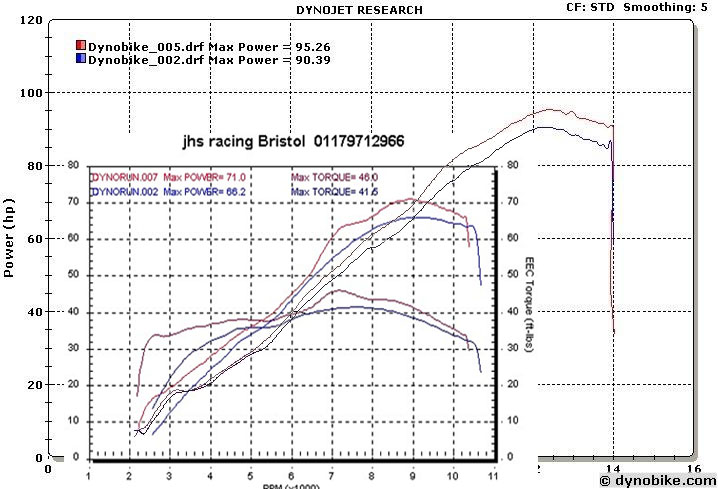

Anyway, for mrredhead:
I'm glad you used inverted commas, because that's certainly not "a fact" either Smile.
I've attached a power graph showing a 99 SV650 and a 99CBR600 superimposed.
https://www.bikechatforums.com/files/99sv650vs99cbr600.jpg
Would you say either look particularly different? The basic 'graph' is actually pretty similar - the 4 cylinder bike is around 1k rpm behind, but is probably geared a bit lower per rpm, so in the real world will offer similar go at a similar speed in first gear - but will of course make more and power when the speed gets up, while the SV will have to change up.
However, even that's not really the point.
At peak power, both restricted bikes will be making 33hp.
It's likely that they will both make 15hp a similar point below that.
Why does it matter that the 4 cylinder bike has to rev to 12k rpm to hit 95hp, when a restricted bike will only be making 33hp?
The difference, in my experience, comes down more to the gearing. The more powerful bikes tend to make their 33hp over a bit shorter range, but not enough to compensate for being geared a fair bit taller.
The SV handles it better because the gearing is already pretty short as it's a relatively slow bike.
Out of interest, what bikes have you ridden in both restricted and full power form, for the same model.
